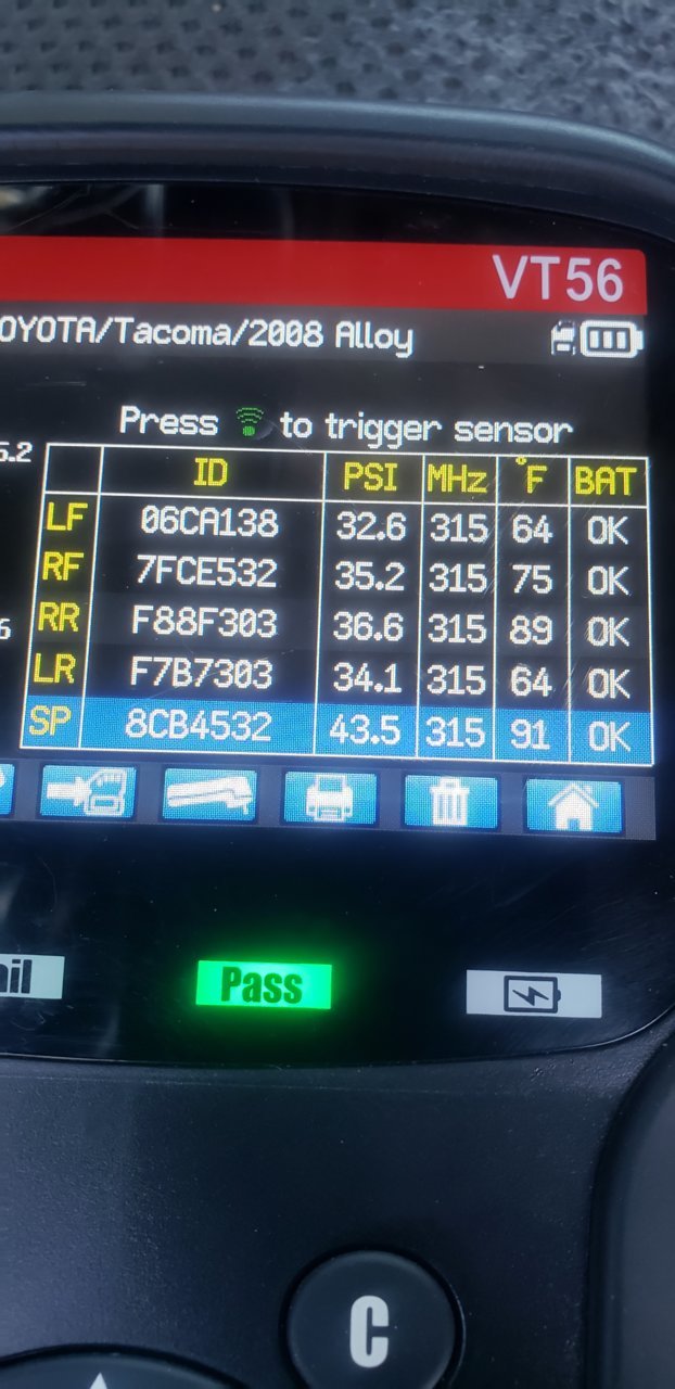

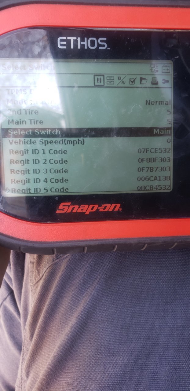

    I replaced a broken sensor with the standard Denso from Amazon, programming the new ID was a piece of cake with my TPMS tool...
    But there's now a quark with the TPMS. The light won't automaticly reset itself after airing back up like it used to. Instead,
    I have to manually reset using the scan tool which is pretty annoying..
    The Snap-On scanner will read the TPMS codes,read ID's, perform a reset/clearing the TPMS light, but won't program or clone ID's..
