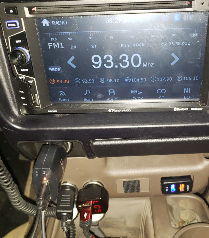

    I put one of the Blue Sea Systems dual-USB outlets in place of one of the 12V powerpoints in the lower dash/front of console panel. Enlarged the hole to fit the USB and tapped into the wires for the remaining powerpoint. Works fine.

    1 - I have not had a problem charging two full size iPads with the unit I indicated even when the batteries were at 0. Other similar looking units only provide 1A per port while this one provides 2.1A per port. There are other similar units available that can provide 2.4A per port but they are more expensive.
    2 - I didn't go with a plug in unit since they can work their way out over time and I didn't like how it looked. Besides, with three "cigarette lighters" in my Taco, I still have two regular ports for anything else. YMMV

    I bought a USB plug with voltage display, it's nice to see how your battery is doing! You can see if your battery and alternator are good or bad while driving, or whether or not your truck will start up if its been sitting.
    Needed a tiny file to fit in the old cigarette socket hole, and required two wires to be crimped onto connectors. Not a big job by any means, and it's been super useful. If you use it once a week, it's worth it over a plug-in adapter, especially if you have THREE (3) cigarette adapters already.
