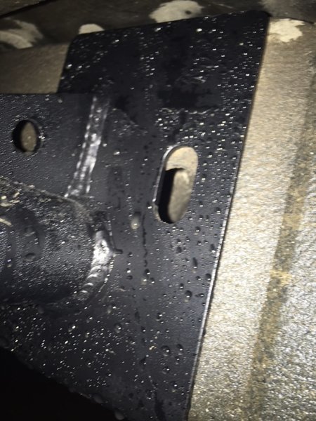

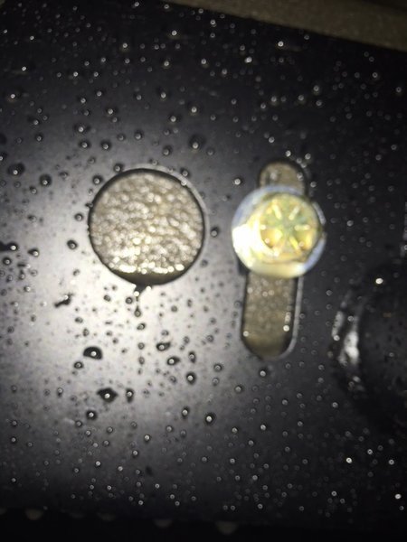

    I don't have a drill that can go through the frame so for this very reason I took it to a local shop, and gave them a print out of this walk through just to be certain it was idiot proof:

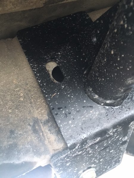

    When I picked it up the guy said my kit was different than the one I gave the instructions for and there was no drilling needed. I get home and see these two spots - one where it appears a hole should be drilled and the other where it looks like it's missing a bolt.
    Can anyone confirm whether they are correct and there shouldn't be any drilling, or that they lied and tossed whatever remaining hardware they had?

    And my invoice says "2nd and 3rd gen", I even asked them about this but they said they'd fit. The 3rd gen design on their site says no drilling required.. is it possible they ship that design now for the 2nd gen and their site hasn't been updated? There is not four separate mounting spots as shown in the 2nd gen pics, just the one and then the longer section.

    CBI confirmed that they now sell the same sliders for the 2nd and 3rd gen, despite what is on their site. Still trying to figure out what is up with these misaligned slots where bolts obviously should be.

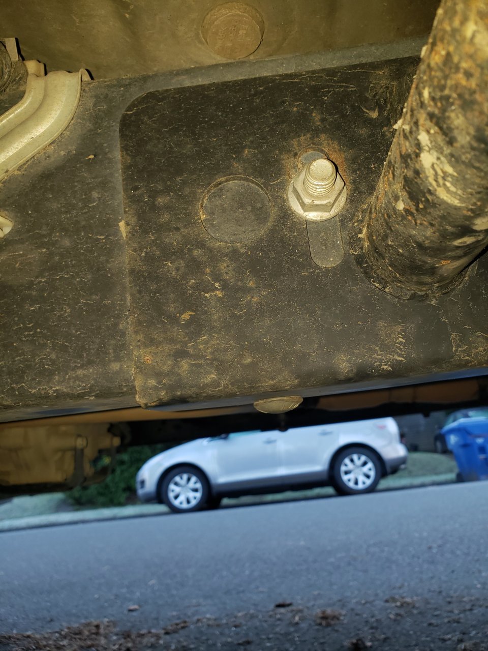

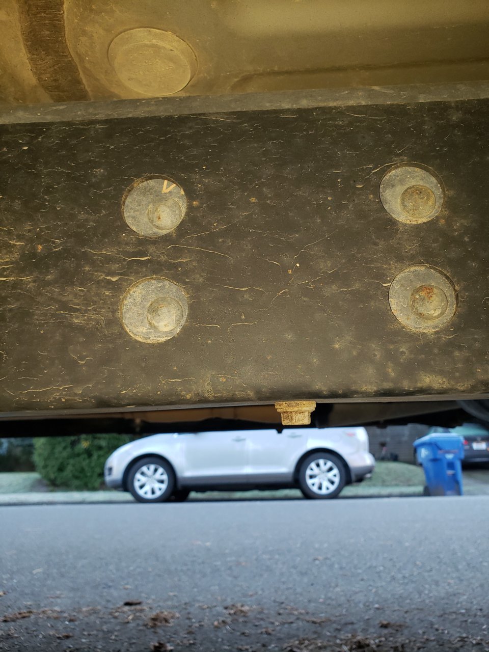

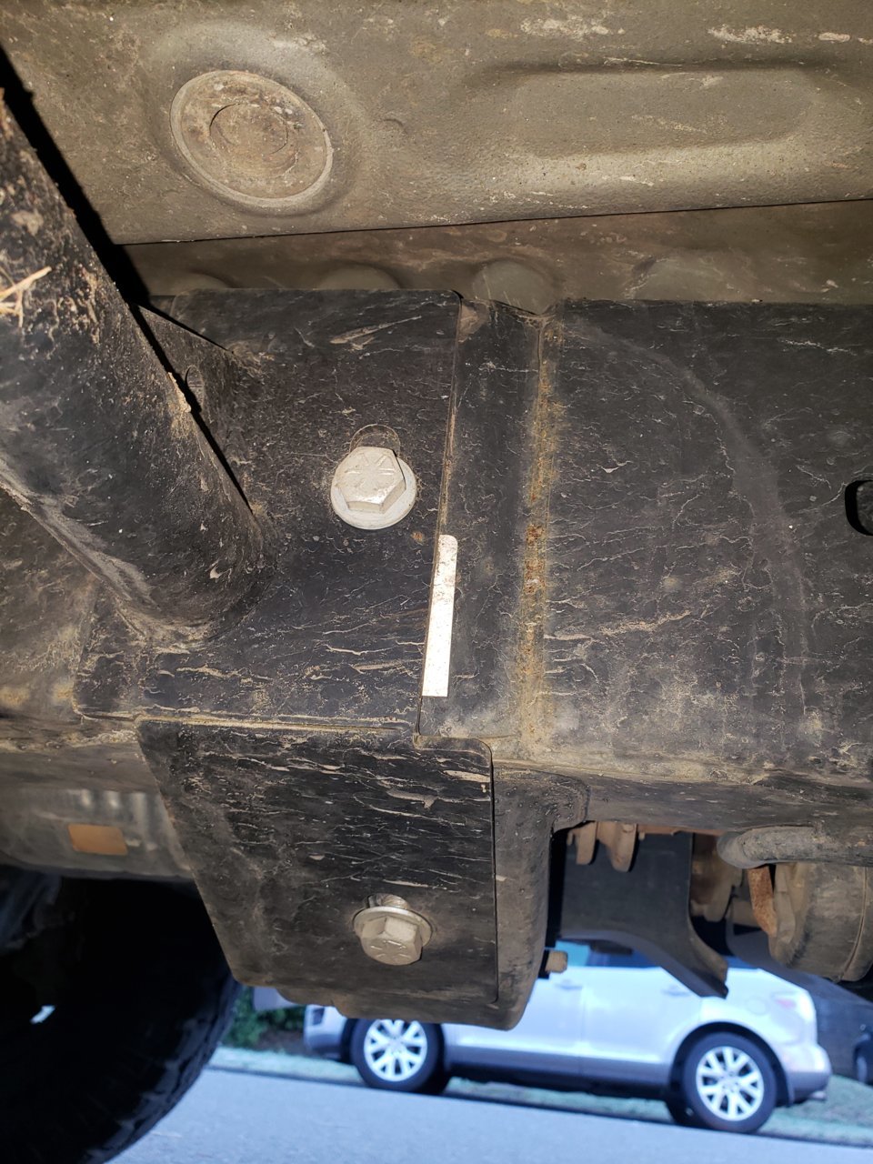

    1. Here are some pictures of my slider installation. The large holes are clearance holes for frame rivets. But, it looks like you are missing a bolt to me! Hope this helps.
    Clayton4x4 likes this.

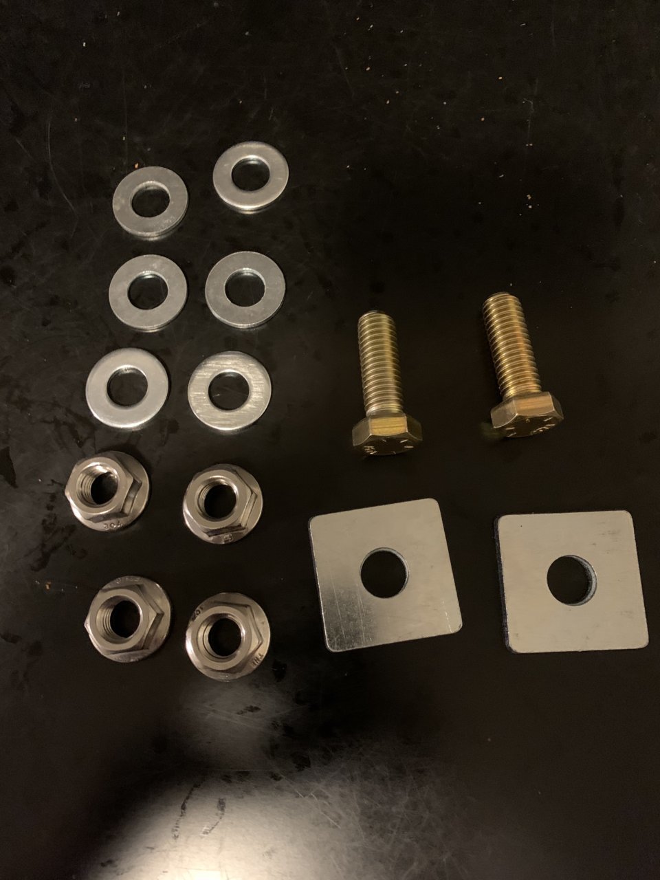

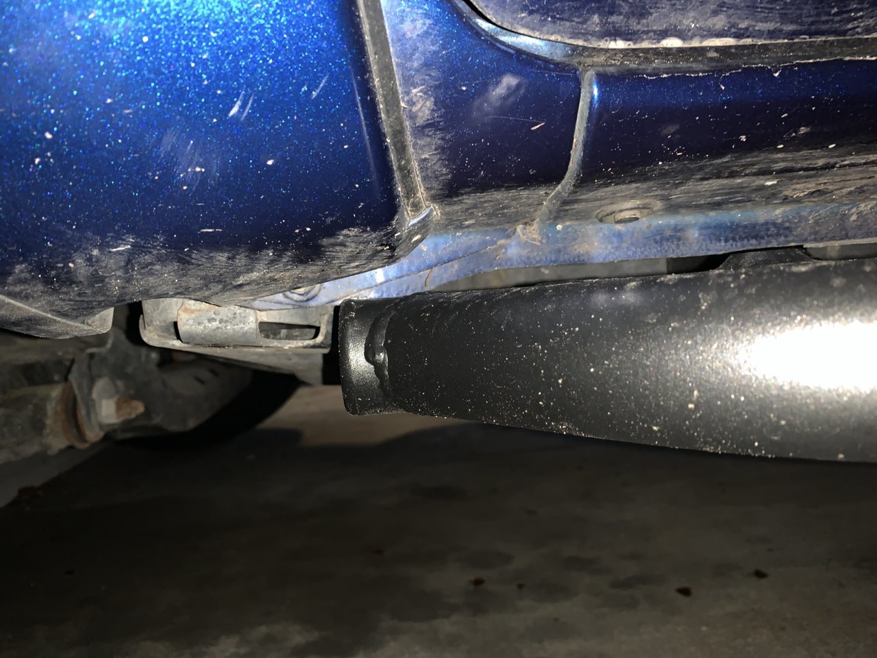

    They turned out to be too heavy to do by myself, so I had my shop do it. It was a first for them, and they gave me back two "extra" bolts. There is a new noise when I hit bumps with speed, like something is contacting, but the sliders themselves are solidly on. I'm going to look under, and make sure every bolt is there, and where the noise could possibly be from. Any ideas would be great.

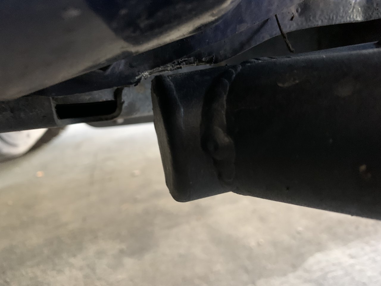

    When I installed my CBI sliders I had to cut a little bit of the cab pinch weld at the front of the slider on drivers and passenger side. The slider was contacting my cab before I made clearance at the pinch weld. The cab will move a bit relative to the frame as the cab sits on rubber mounts to isolate it from the frame. I suggest at least a 1/4" gap between the slider and cab. Also, snap a picture of you "extra" bolts. Maybe someone can enlighten you if they need installed.

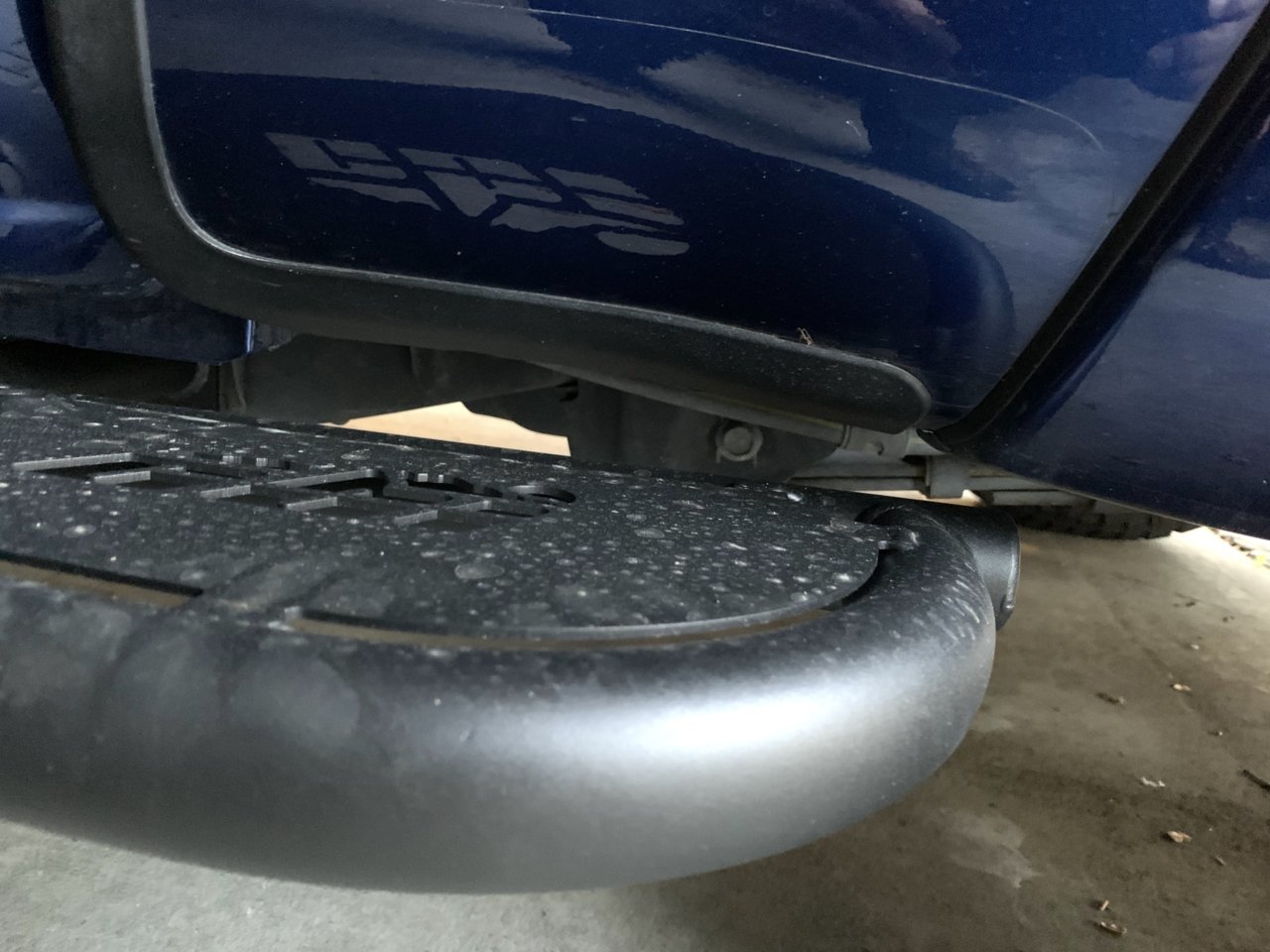

    Thanks for the reply, I think it could be the cab. Below I've posted pics of the extra hardware, 2 of the driver's side front, and 1 of driver's side back. It looks like there isn't much room between the slider and cab.

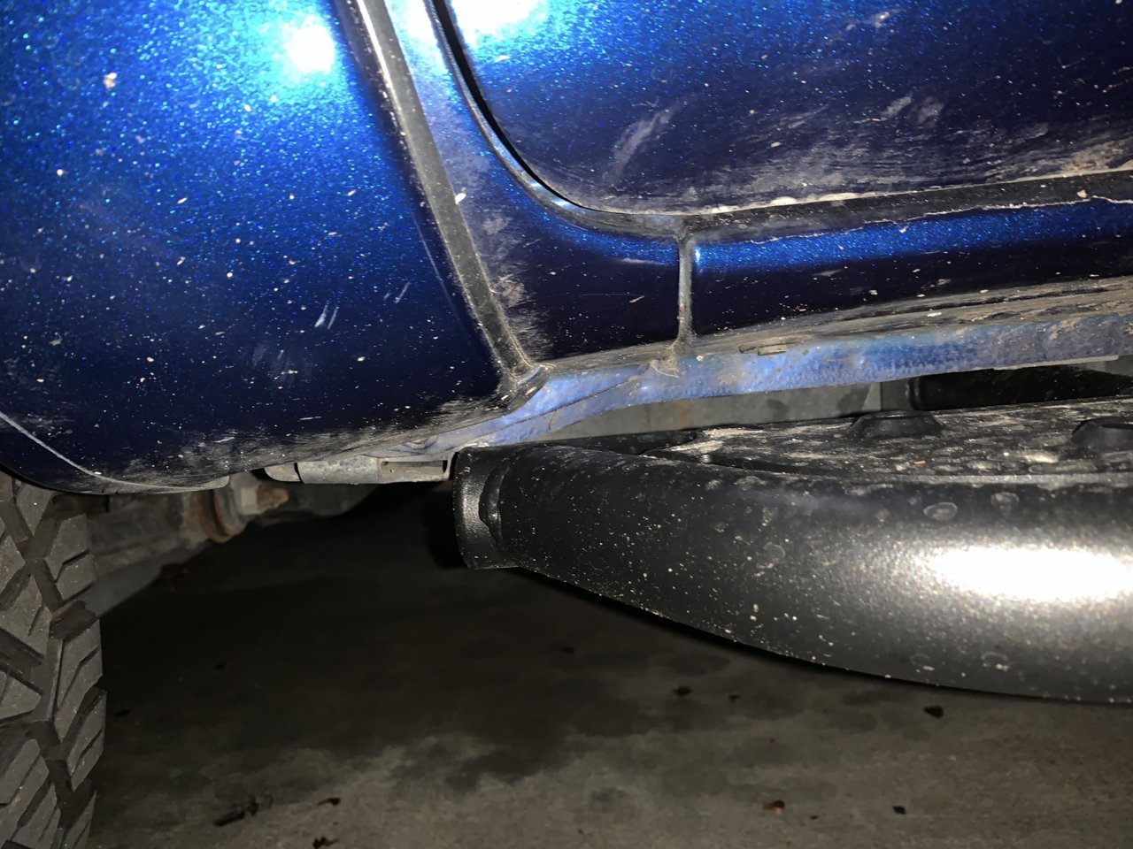

    I would suspect cab interference is the source of your noise. I ended up using an angle grinder to clearance the cab before I installed my sliders. It may be done with a Dremel or the like with the sliders installed. As for hardware I had no left over hardware. The installer probably missed a bolt location on both sides. Take a look at CBI's install instructions to see if you can identify the location of missing bolts. There is a difficult bolt to install at the crossmember location. I have skinny ass arms to I was able to reach inside the frame rail to install the square plate and nut.
    I have provided a picture of a gap that works for no interference. I do have polyurethane body mounts with less flex than factory rubber mounts. Also, the picture with the attachment hardware shows the bolt that is difficult to install, the top one in the picture.
    Hope this helps!

    I spoke to CBI, and they say it happens sometimes, and the best way to fix it, is to loosen the bolts, have someone stand on the middle of the slider, then tighten it with them still standing on it. I'll follow up with results.

    The only concern I have with the "stand on the middle of the slider" is that if one were to use a Hi-Lift on the slider it will surly migrate towards the cab again. Cutting a bit of the cab pinch weld was very easy. The raw edge can be painted with a small touch up paint bottle with a brush.

    I was passing through Idaho, so I stopped by CBI to have their install guy fix it, and like D-Bag said, it was the pinch weld. He chiseled out the area of the pinch weld that was contacting, and no more rattle. It doesn’t take much, as you can see from the pic.
