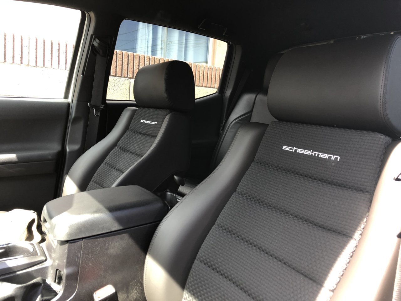

    Theres an LKQ in Topkea that has a passenger seat I need to cannibalize for my Scheel Mann seats?
    I will pay for time / gas and obviously shipping. I also only need the base so if you wanted to sawzall the upper or remove airbag to sell, whatever.

    Nice seats, any mods to installed them?

    Yes, thats what im trying to resolve with a spare factory base.
    The new occupancy sensor is actually 4 individual sensors one at each corner instead of a silicone filled bladder and a pressure sensor. I want to mount the seats to the factory base with the sensor to test if I can make it all work. Other than that big hurdle, just need to run resistors in the factory seats airbag harness.
