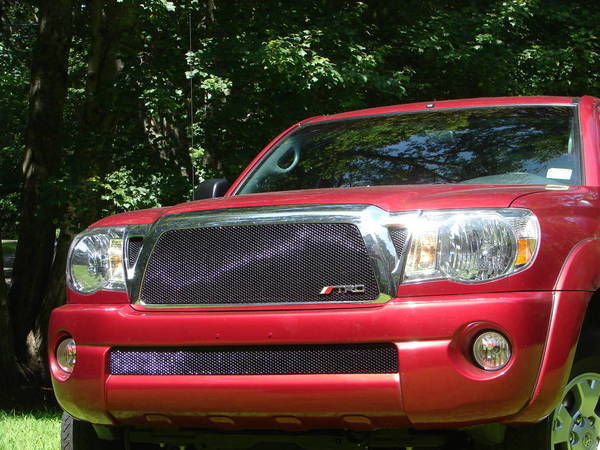

    This may help you out some. I've got the same XM antenna and I had it installed at a shop. They ran the wire under the windshield seal to the center of the top of the windshield and mounted the antenna there. You can see it in this picture.
    I'm not sure how they ran it from under the dash to the windshield, but it is on the passenger side. Hope this helps some.
