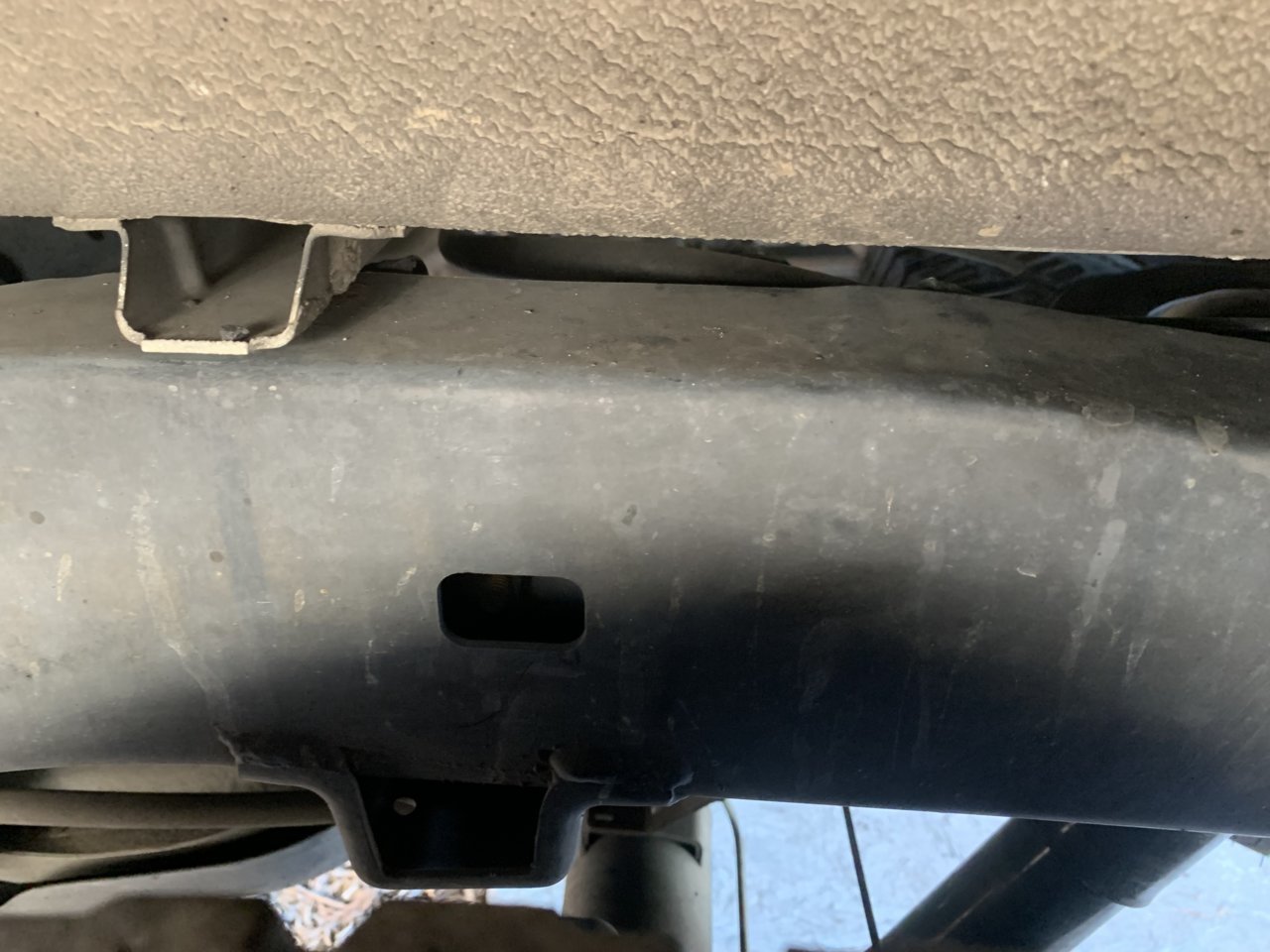

  15. Jun 26, 2022 at 6:59 PM
    Bobo4x4
    Bobo4x4 [OP] Member
    Mar 13, 2022
    #392531
    22
    First gen Tacoma
  16. Jun 26, 2022 at 7:07 PM
    #16
    Bobo4x4
    Bobo4x4 [OP] Member
    Mar 13, 2022
    #392531
    22
    First gen Tacoma
    My frame only has the one hole on the out side like in the pic
  17. Jun 26, 2022 at 7:35 PM
    #17
    Phessor
    Phessor Well-Known Member
    Feb 15, 2014
    #123156
    3,404
    Bob
    1998 TRD XTra Cab
    Stuff
    Hmmm, I guess you do have to drill the fram. It has been so long I couldn't remember.
