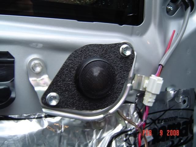

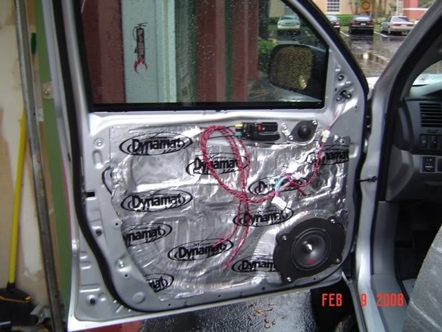

    you can get some aftermarket mounts from *********.com or you can make them yourself. keep in mind you will also need to have spacers to convert the factory 6x9 to a 6 1/2" hole for the woofer.
    here is a pic of my door
    and a close up of the tweeter mount i made

    What did you use to make the tweeter brackets?? They look great

    I used the stock tweeters as a mounting plate. i just removed the driver and some metal and mounted polk audio component tweeters in them. The custom mounting plate from tacomtunes is a much easier option.
    If you are a little handy a mounting plate can be easily fashioned out of ¼ inch mdf with only a few tools, just use the stock tweeters as a template.

    I tried to contact *********, but no reply. Maybe I will try Mr Marv. Although I dont mind making a set. The black ones in the posted picture above appears to be made of some light gauge metal or thin plastic. They look great and doable.
