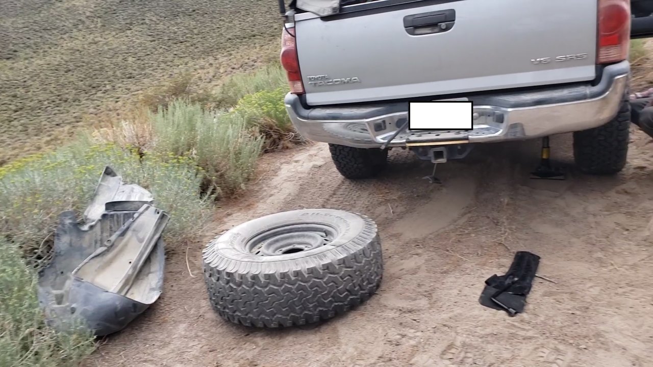

    I see, yeah, your options are limited with the bottle jack. I splurged on an a floor jack a few years ago, thinking I didn't really need it, and wow am I glad I did! Just a Harbor Freight one.
    With the current jack, it looks like you might have to jack the whole truck up higher first, before you can lower the axle enough to separate the springs. Sorry I didn't understand this previously before, I thought it was the other U-bolts keeping it in place.
    Be careful though, that axle is heavy, and so is the rest of the truck!
    Oh, and make sure you your brake lines and wires are unclipped from the axle too, so you don't tear them. Can't quite tell from the photos.
    Edit: You might have better luck with the OEM jack in the back seat, I think it goes lower?

    I was just editing the prior post, so in case you missed it:
    The factory bottle jack is a two stage design, so it can go lower than a single-piston hydraulic jack of the same height. Maybe give it a try.
    Yet another edit: Crappy photo from a video, but this shows that the factory jack is high enough to lift the axle beneath the U-joints. I have 33" tires. This would let you drop the axle low enough.
    I agree with the above post, no need to remove U-bolts from both sides a the same time. Just loosen the other side.
