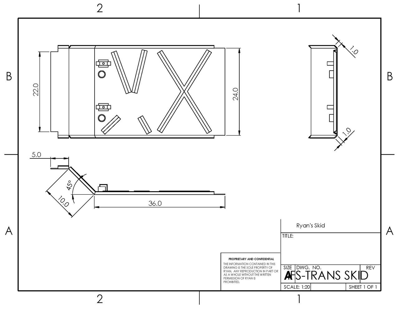

    ome 3" lift, light racing uca's ,moto metal 951 wheels with 285/75/r16 gaurd dogs,ARB air lockers front and rear with 4.56 gears, bhlm,black tail lights,Satoshi Grill,4-low trac ,autoPage C3 RS-665 alarm with remote start,flowmaster 40 series exhaust,cruise control,bed/ground effect lights,cup holder leds,12-volt always on,wet okole seat covers,custom rock sliders built by me, tinted,windows,weather tech floor mats,avs vent shades,debadged, smoked fogs,hidden cobra 19 cb, 7" offroad lights behind grill, rear diff breather relocate, abs kill switch ,Front plate bumper with smittybilt 9.5k winch, homemade skids, Bed bars,Mobtown offroad high clearance rear bumper with tire carrier
    Do you have and measurements for the holes and how long are your stand offs?
