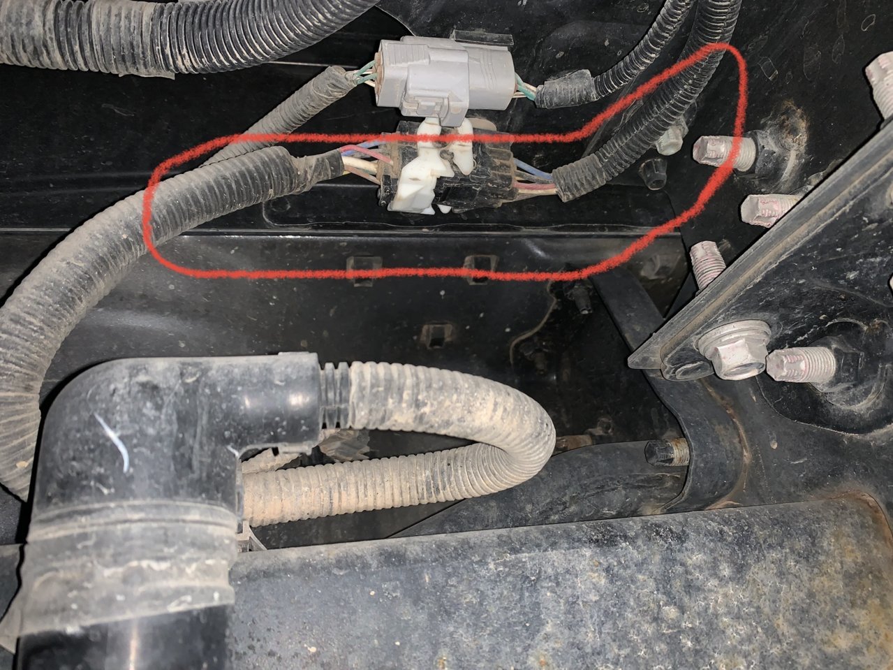

    Special request: 2nd gen inline 7-pin to 4-pin tap.
    I'd like to unplug the OEM 7-pin connector and insert a short harness with the same waterproof connectors that have the correct 4 wires coming off so I can terminate these to a 4-pin connector for a 3rd brake light I have mounted on my bike rack.

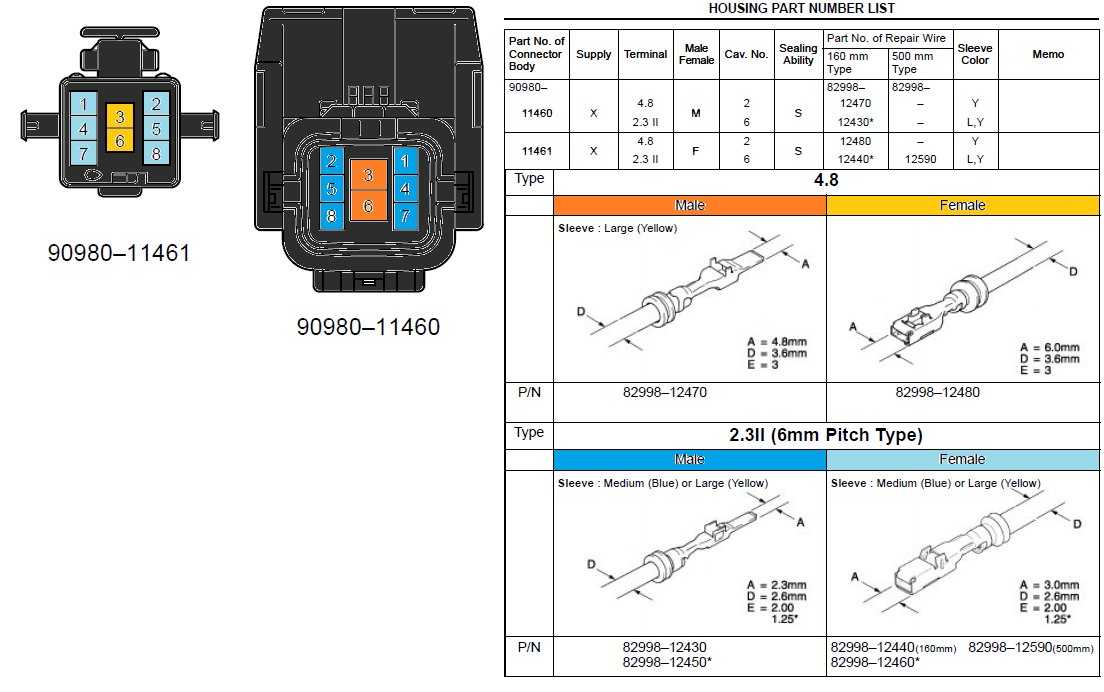

    Maybe this. @JasonLee, you could carefully remove the connectors to read the correct part numbers on them.

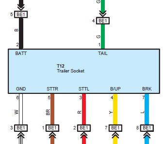

    Damn, you're good :) Do you know what those wires do?

    Awesome! Thanks! You rock, as always :thumbsup:
    @JasonLee I believe what you are looking for is doable. A quick search reveals that I need to search more though :p
