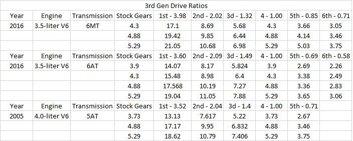

    Almost everyone whether stock or lifted that I’ve chatted with are reporting 1.5-2mpg better with 4.88’s because the truck can maintain speed better (carry its own weight/momentum) so the engine isn’t using as much fuel. This is one of the bonuses with going to a gear change
    Another gentleman on here did 4.3’s in his AT and mentioned that he wished he did 4.88’s because the change with 4.3’s was barely noticeable

    The truck can carry its own weight better and keep it in 6th gear. You don’t have to press the gas as much to hold speed even if the rpms are higher (slightly) so you are using less effort to move the truck. There is no way that screaming 4500 rpms to move the truck uphill isnt healthy over time for the transmission
