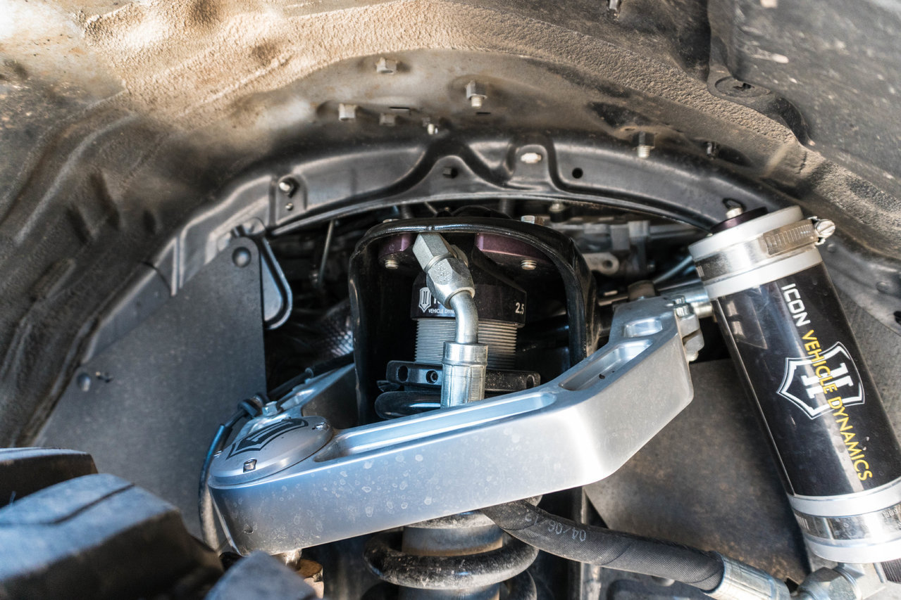

    Now, on to my setup; Truck as it stands today.... 2017 TRD OR 4x4, DCSB. I am running an Icon stage 6 lift in the front and Icon stage 2 RXT in the rear. Tires are E rated 285/75 R17 Toyo MT. I have sliders, aluminum skids and a winch as well as a host of lights. While I have tried to keep the weight of the add ons low, it is added weight nonetheless. When I put the Toy MT's on, I new that I had to get gears. just wasn't an option anymore. Truck hunted for gears, had horrible fuel economy and generally was a bit of a chore to drive. So, knowing that gears need to be setup properly, there was only one shop near me that I trusted enough to tackle the project, SDHQ Offroad. These guys are a premier shop with an unmatched commitment to quality, so they were the obvious choice for me.
