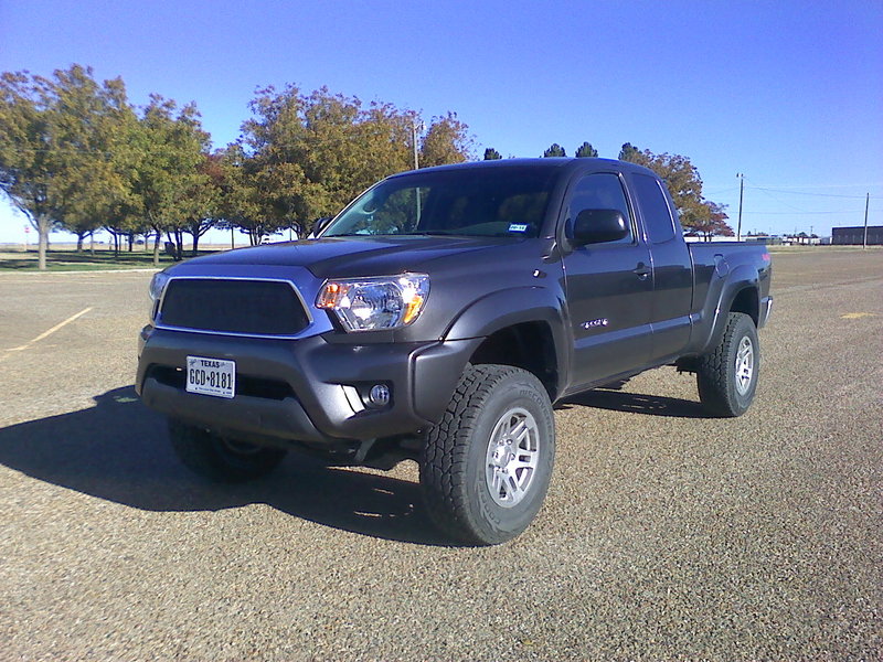

    I could tell very little difference on mine, just doesn't spin the tires with the 265's like "I" did on the 245's when taking off. I'm not a putter that's worried about mpg's, the only real way I can tell any difference is going up hills with a steep incline it shifts down quicker now but I"m not loosing anymore speed to speak of its just pulling a little harder, or higher rpm's than before, but mine is a automatic too. I couldn't tell you on a manual trans if you would notice it or not, but with a automatic not hardly at all. And no sluggishness at all, and my tires aren't slicks ether just got them about three weeks ago.1122151003.jpg DSC02843.jpg

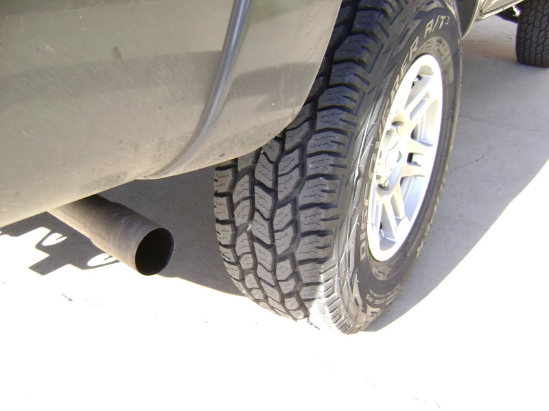

    One more thing I forgot to mention, I was dreading the added road noise, going up to a more aggressive tire, on my Tacoma! I still haven't gotten over how much I was expecting the road noise to go up with the New Coppers, I can just barely tell any difference at all, had off road tires my whole life, and these are the quietest I've ever had. Just for what it's worth.
