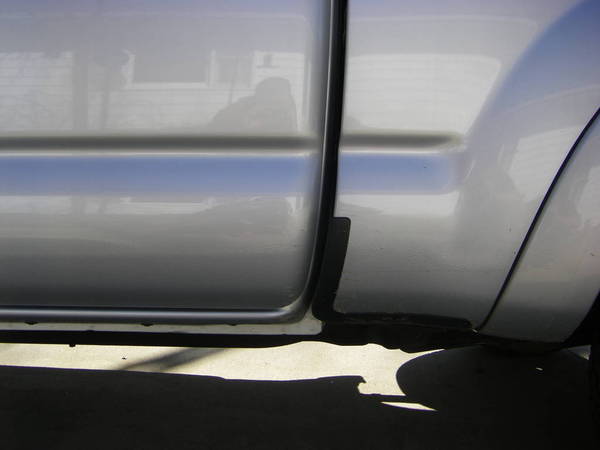

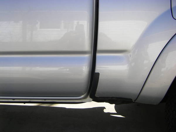

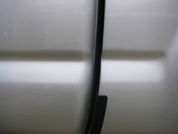

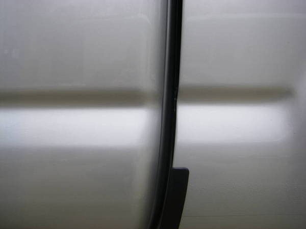

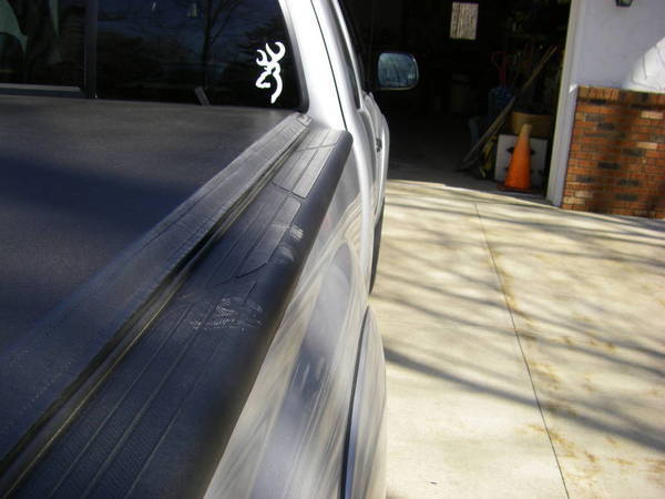

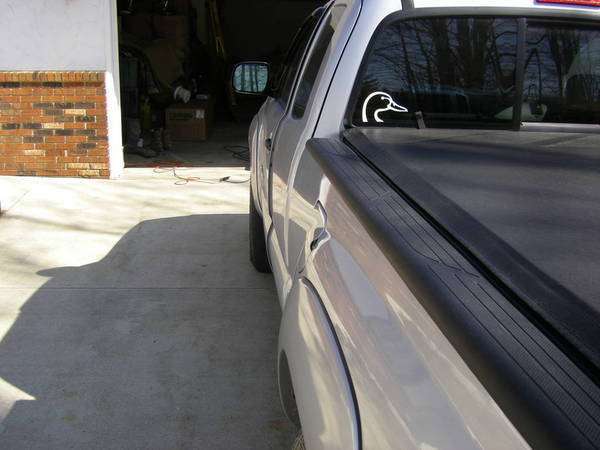

    i was washing my truck today and noticed my bed is mounted crooked. the body lines that run down the cab to the bed dont match up. the bed body line actually sits higher than the cab body line. it is hard to tell in picture but the bed sits about a half inch or more higher than the cab body line. also if you stand behind the truck the bed looks like it is shifted more towards the driver side than the passenger side. does anybody else notice this on their truck? is that normal?

    First of all, you bed is not that bad. Adjusting it may cause more problems than good.
    That being said, I would just torque down the bed bolts, make sure they are all tight.

    My 2009 AC cab bed is exactly the same on the passenger side - a bit off. I have been tempted to fix it myself by loosening the torx bolts. But I don't have such a large socket. I live with it. I did a quick inspection of other Tacomas at the dealer. Some are off on the drivers side and some the passenger side. NONE were balanced left-right. All were off to some degree.

    i noticed exactly the same problem my bed was off to the left about 3/8" of an inch, i loosened the T55 torx bolts and moved it all the way to the passenger side to get it straight. i was suprosed it took all the adjustment there was in the bed to get it aligned. my concern was the depris from the front wheels might sandblast the paint on the front of the bed. i asked the dealer about it and they referred me to a body shop so i just took care of it myself. the bolts werent that tight that i couldnt get them off with a standard 3/8" ratchet drive.
