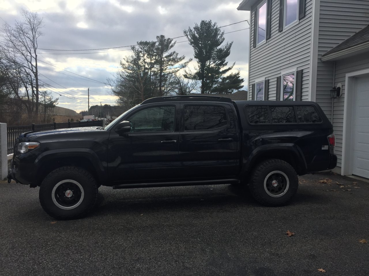

    I just did mine on friday... it came great EXCEPT two spots, i was in tight quarters and didn't notice I hit with my leg on my last pass after a nearly perfect job. I will sand and touch up.
    I used bedline paint from HD
