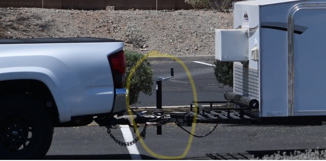

    I've spent hours reading the towing bible post and all about everyone pulling travel trailers but my situation is just a little different.
    I have a stock 2020 OR AC and I'm pulling a 2015 mini cooper on a uhaul auto transport because I prefer all 4 wheels off the ground. We're going from Phx to Sea for work and this is the first time so I'm not adding leaf springs or air bags to the truck although I realize that if this becomes a regular thing, those modifications will help. Right now I need to order my trailer hitch ball mount and have read all about the calculations for drop but I haven't seen anything that addresses suspension compression in keeping the trailer level and this is where i'm stuck.
    My receiver is at 18.5" and uhaul says their trailers are at 18" (and change) so I need no rise or drop, but: as soon as I put a trailer on the hitch, its going to compress the suspension and I'm out of level. In a perfect world, I would be able to distribute load around a trailer to make it balanced but in this specific instance, the car is supposed to be as far forward on the trailer as possible, putting most of the weight in front of the trailer axles and towards the truck. The uhaul website even states that you know you've loaded a trailer pretty well if the suspension on your tow vehicle compresses about an inch so does that mean I should get a hitch with a 1 inch rise so the weight of the trailer makes it level for the tow? does it really matter all that much? I haven't even factored in the compression of the cargo that I'll have in the bed because there will be some. We are going to live there for 13 weeks so we'll need some things. Anyone with any experience with pulling a car on a uhaul auto transport?

    I bought the cheap $80 maxxhaul adjustable tow hitch off Amazon and for $80 is pretty damn good. I towed that same I haul trailer with a heavier car than a mini. (I towed it with a different vehicle since my truck was tied up elsewhere)
    Edit: typically for towing you want the trailer to be level or close to it without having the weight of the trailer push the rear down too much

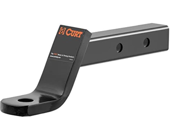

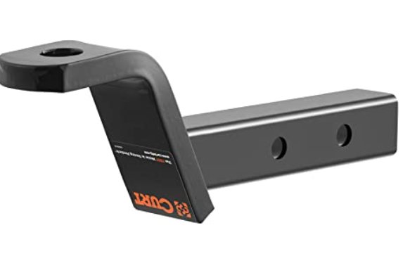

    Typically you can flip the ball to the other side...
    That is end up with a 2 inch drop or a 1 inch rise.
    We had to flip it for the Subaru because when we hooked up the little camper it set too low.
    By flipping it up it was a perfect even fit.
    ie:
    Now... beware... if the item you are towing has a crank on it... ( not the scientific term lol )...
    You need to be sure that you can open the tailgate and not crash into it.
    The Curt 45260 has a 11 1/8" space between the pin-hole and the ball, and should give ample room
    to drop the tailgate if needed. Standard sizes are 8.5 inches and will NOT provide enough space to open
    the tailgate... keep that in mind.

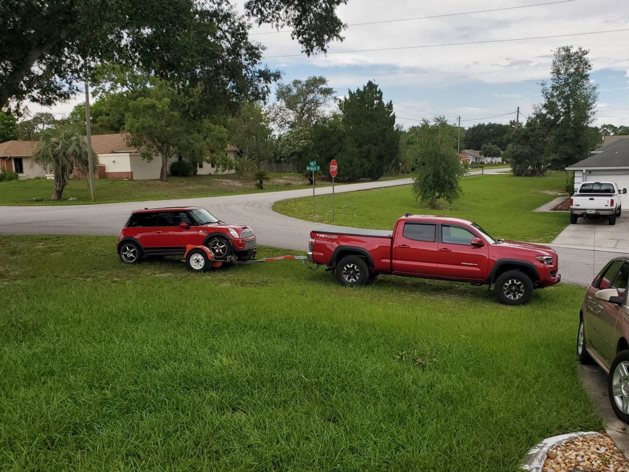

    Towed a Mini from FL to VA no issues with a tow dolly.
