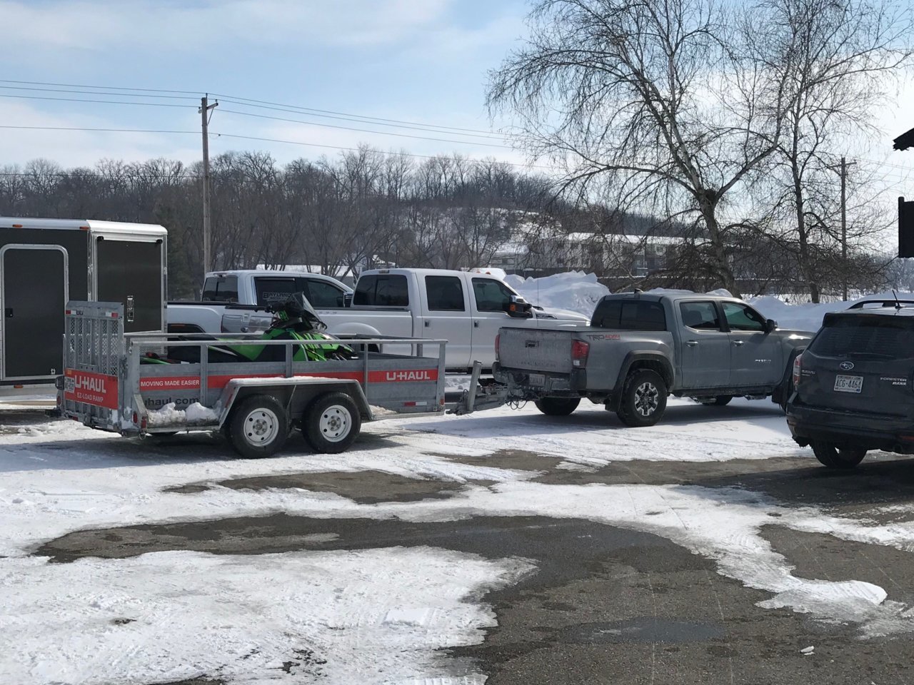

    Think the biggest thing to remember here is that everyone's idea of "towed with no problem" is different. I couldn't imagine towing a car on a trailer being an enjoyable experience with a Taco.
    I towed this setup about 2 hours and IMO this is about the most weight a Taco can tow comfortably. It did fine but sometimes on hills it got old listening to the engine sit at 4K+ rpm to maintain speed. And you 100% know that weight is back there. Not sure how some people claim they don't notice a significant amount of weight.
    The trailer plus sled weighed about 3K pounds. Had my GF and myself in the truck (300 pounds) plus another 100 or so pounds of gear. I usually tow this same sled on an actual snowmobile trailer (about 1400 pounds total) and it is a much more enjoyable experience.
    Side note the trails in New Glarus WI were great that weekend!

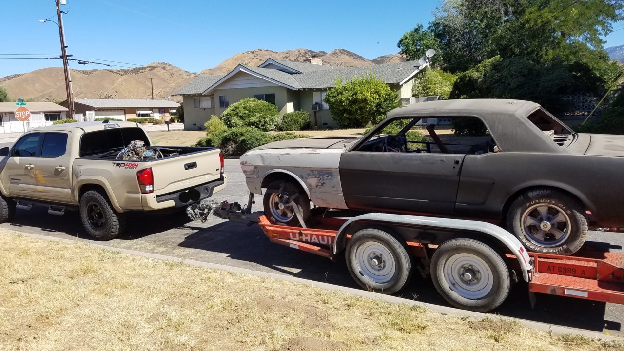

    Just going to be lazy and link back to the thread I started forever ago and never updated (whoops), but cliff notes - towed a 2200lbs VW Caddy on a uhaul trailer with the bed loaded with tools/jack/and another person and our luggage from PGH, PA to OC, MD with no issues.
    https://www.tacomaworld.com/threads/tacoma-one-year-later.640345/

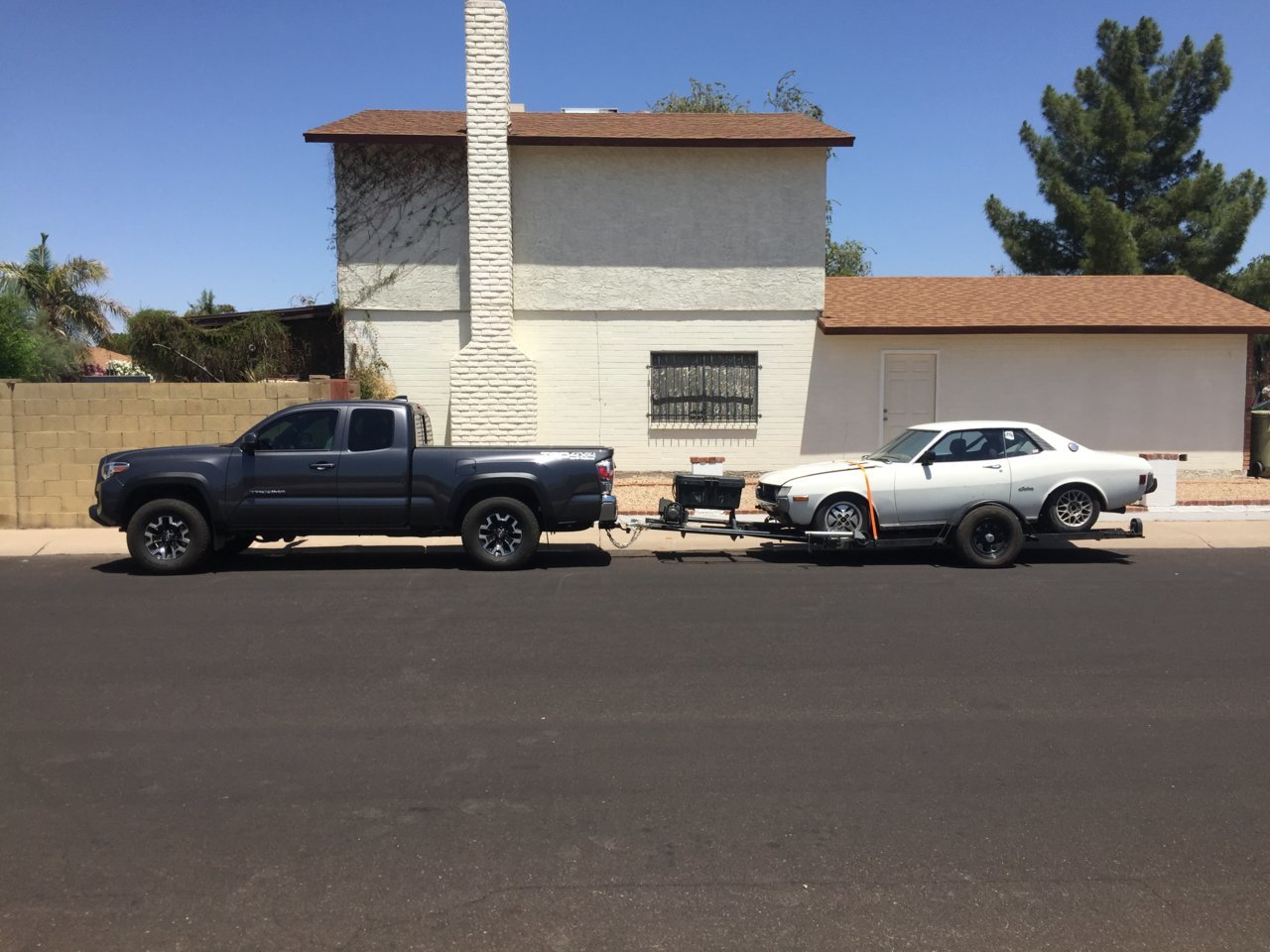

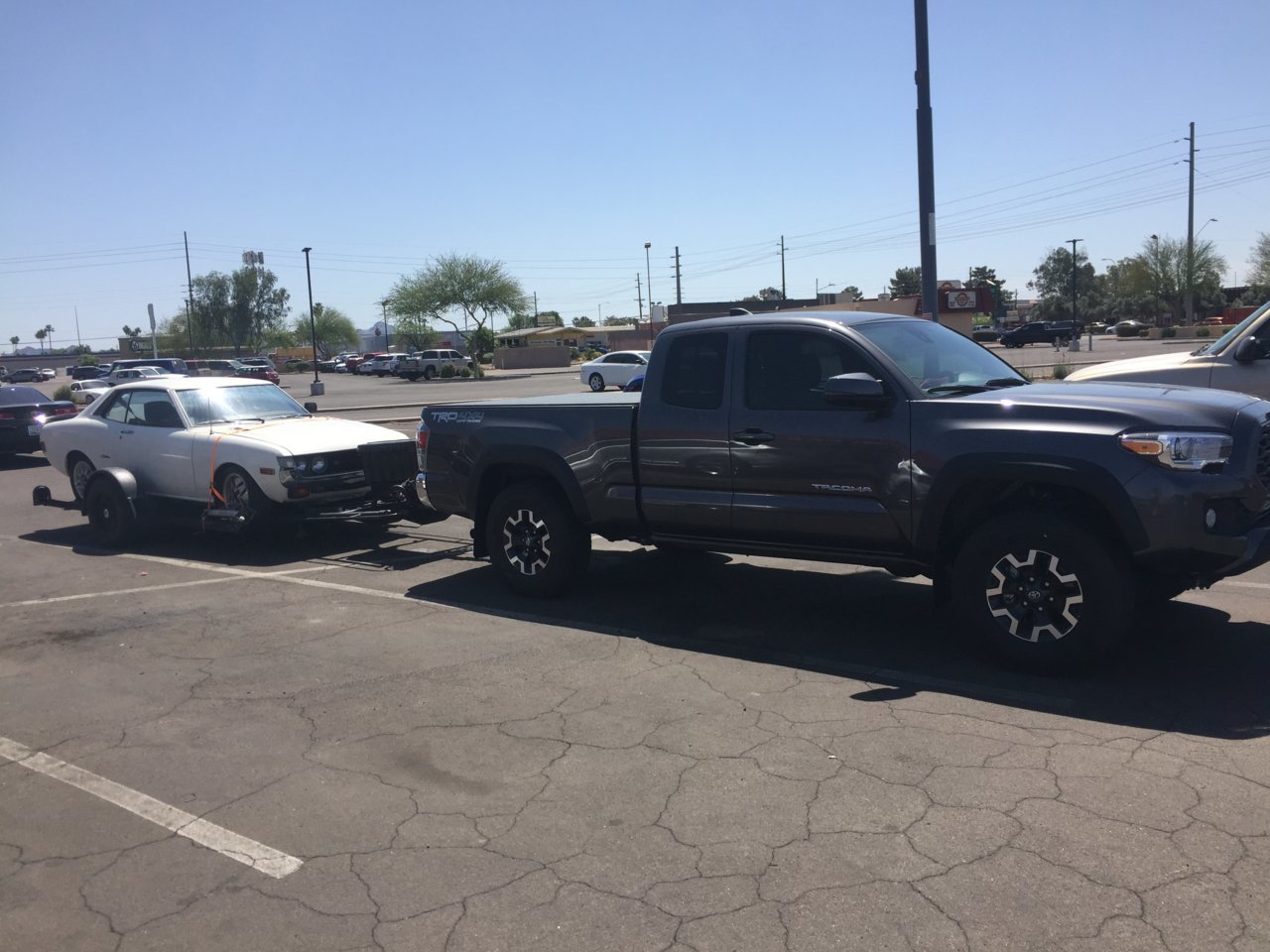

    Did a little recon with a borrowed trailer and car combination that is probably close to what I’ll have going on with the uhaul setup. Biggest differences will be that the trailer I borrowed is all steel and single axle but the weight should be about equal and should be better distributed with the all aluminum uhaul’s double axles.
    In traffic, it was pretty gutless but once I was rolling it was fine. It took a while for me to remember that I had an ECT button and the behavior pulling from a complete stop improved immediately when it was engaged. I really wanted to get out to some hills to face my biggest concerns but I live in Phoenix and it’s a couple hours in any direction before the ground goes up or down and I just didn’t have the time. Based on a million other people’s opinions and experiences, I know my mileage is going to drop by half so I decided to get the truck KD Max tuned. I like the idea of better throttle response, I like the horsepower gain, I like the torque control, I like the shift point changes, it drives better now and as a bonus there’s supposed to be a 1-3 mpg gain as well. The tune happened 2 days ago. We leave in 4 days. I’ll keep you posted.
    before anyone starts in, it’s not my trailer, no the tongue isn’t bent it was welded that way... something about physics, I don’t remember. I was just impressed he was kind enough to put a car on a trailer for me to go play with.

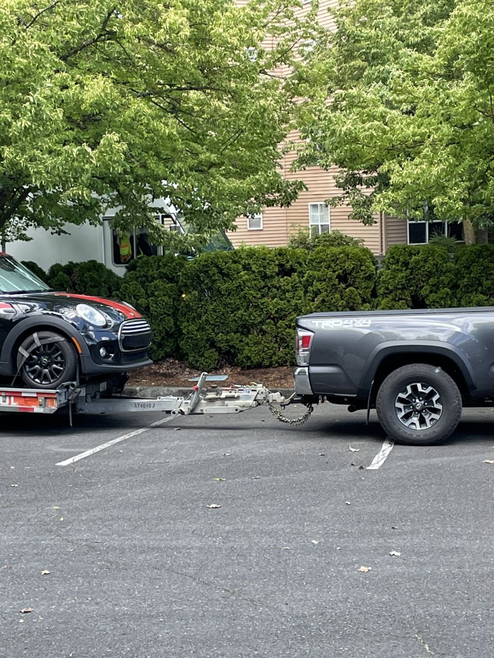

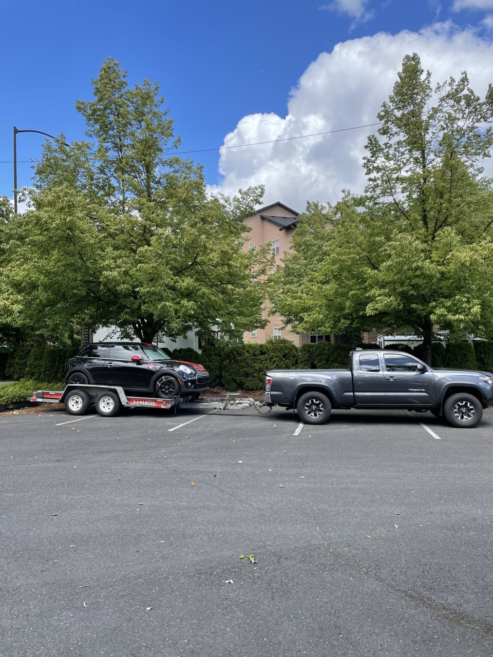

    Ok. Looking for towing information specific to a uhaul auto transport? Here it is.
    I just did 1500 miles AZ to WA through 4100 foot elevation peaks twice. 2600lb car on a 2200lb trailer with a truck bed full of household commodities - not heavy, but not nothing.
    Truck was fine on power. I got the KD max tune before I left and it probably helped but up hill I was manually shifting the auto trans, sitting at 4000 -ish rpm at 65 mph in 3rd passing everyone with my A/C on. I see a lot of taco owners balk at showing the engine some revs, but it’s an import: revs are where the power lives!
    I kept it at 75 mph everywhere else, nothing to prove, it just felt comfortable.
    Brakes were fine too, just don’t ride them downhill and remember to downshift.
    My concern is suspension. Stock height for my hitch is 18” and loaded it sagged 2 inches to 16”, which doesn’t look too bad but my front end felt pretty light and the bigger highway bumps bottomed out pretty hard. If this ends up being a thing I do regularly, I’ll get some air bags for the rear axle so I don’t collapse the leafs.
    I had to buy a hitch for the trip and I went with a 2 inch drop even though a straight hitch would have been appropriate as the hitch height of the uhaul is 18” as well. The rule is that you want your trailer leaning forward for stability and I knew by measuring that it was, but it didn’t sag as much as I feared it would. I had done a test run earlier in the month with a similar trailer and car weight setup, but I hadn’t loaded the bed and the nature of the weight of the car was different (front engine, rear wheel drive). I was worried about our MINI Cooper being so short that it would sit ahead of the trailer axles putting all its weight on the tongue, and it mostly did. I was concerned that all of its weight would be on the tongue as a front engine, front wheel drive car, and it was. The test setup I tried resulted in a 1 inch sag but on the day the full sag was 2 inches. I bought a hitch with a 2 inch drop and a regular ball for it, as well as a ball with a 2 inch rise in case the whole thing just dropped in the middle or the trailer pitched so far forward it became unstable. I never ended up using the 2 inch rise ball because although the trailer tongue looked low, it never had clearance problems and didn’t look pitched forward. A rise ball also wouldn’t have changed anything with the rear end sag so I just left the regular ball on the 2 inch drop hitch. I chose the drop because the hitch I wanted didn’t come without one but it didn’t cause any problems. In case you’re interested I chose the convert-a-ball shock absorbing hitch and it does actually make for a smoother ride. My wife can get car sick so I wanted to dampen any more bouncing around than necessary. A truck and trailer and car on the trailer all moving separately can get a little wiggly and I didn’t want all that making it a miserable trip. It’s a bit spendy but I used a regular hitch and then the cushioned hitch back to back pulling the same trailer over the same stretch of road and there is a difference.
    https://www.etrailer.com/Trailer-Hitch-Ball-Mount/Convert-A-Ball/AMSC2HD.html

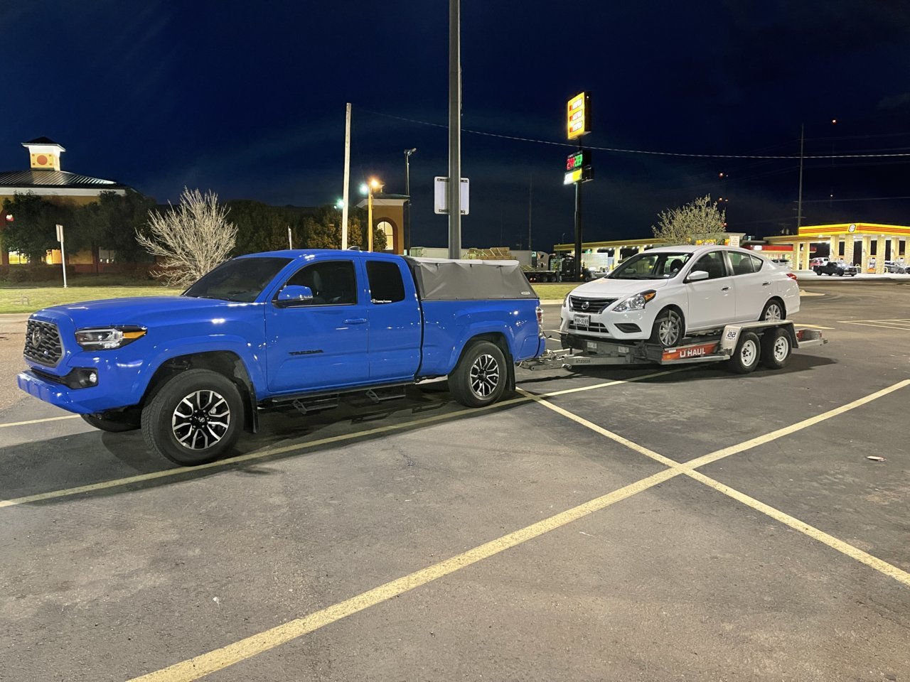

    I towed my friend’s Versa from Flagstaff to Dallas on a Uhaul Car Carrier. Truck handled it shockingly well, easily held 75mph up the Albuquerque mountains and no sway issues. Managed 12 mpg overall as well. I have a stick though, not sure how much that affected things.

    Looks like with that short wheel base that all your weight was on the tongue. A weight distributing hitch would have leveled you out. What kind of mileage did you get running at 4k rpm?

    Uhaul says not to run a load distributing hitch ...
