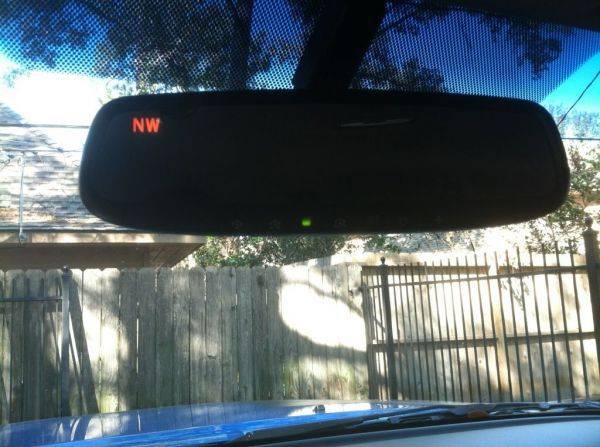

    I just installed the 2012 mirror, I'm trying to locate where I can tap in for the temp sensor on my 2010 reg cab. I don't have the overhead temp display. I do have the sensor, I just need to take the headliner down and find it then determine which pins in the mirror are utilized. Does anyone have the pinout for the 2012 mirror?

    I'm still trying to find where I can pull the yellow temp wire from in my regular cab 2010 truck. My tis subscription ran out does anyone have the wiring diagram?. Also does anyone know what the trim part number is for the part that covers the wire running down from the headliner to the mirror?
