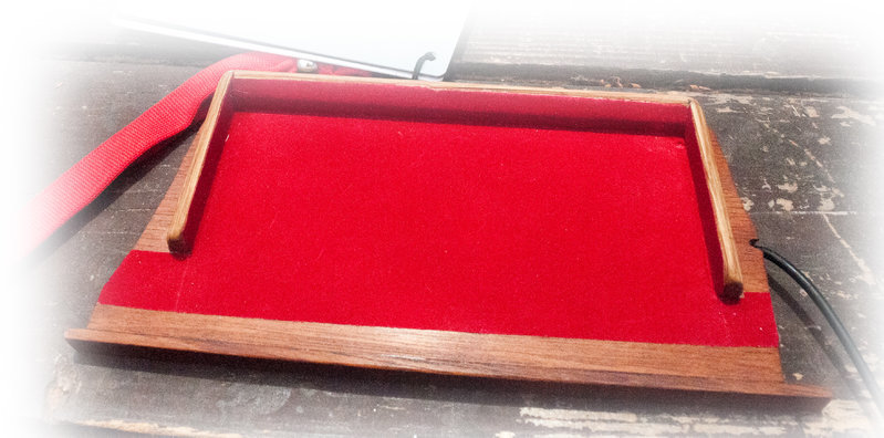

    I made this last year but a short time later purchased a new phone that doesn't support wireless charging. The electronics is completely inside the wood except for the usb cable to connect to power source. I sliced off thin layers (veneer) off the top and bottom of a piece of wood with a band saw. Then removed wood from the center of the middle piece fitting the electronics in place, then glued the top, bottom and middle pieces of wood back together.
    A easy way to do this without a band saw is to use a large drill bit like a forstner bit , the hole it makes has a flat bottom. Then drill though the bottom of a piece of wood being careful to stop a little short of drilling completely through the other side. A piece of tape can be attached to the drill bit as a depth gauge so you know how deep to drill. Then the electronics could be placed into the drilled out area though the bottom and it will look just like what I did. I glued small pieces of wood to the top to keep the phone in place and prevent it from sliding around.

    How much you want for that Jim?
