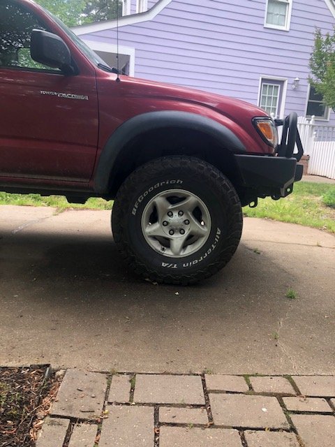

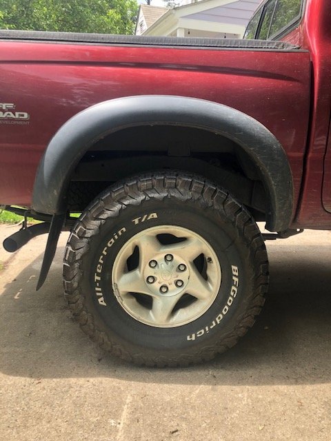

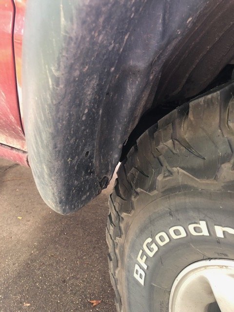

    Just curious, what brand of springs are those? I forgot to say on orig post that before the spacers I was rubbing on my stock UCA during tight turns lightly as well. Also, on the inner fender (I think that's what you mean) on tight turns. In the close-up below you can see where I cut.
    Yeah, not sure why I didn't go with the 883 at the time. I should have done more digging. I think I had them in my cart before changing my mind.
    Sorry about the bad pics. There's a tree in the way to prevent a full shot so I get that later, but just to show how the tires fit in the wheelwell for now. You can see where I cut prior to the bullbar install in the close-up shot -- wheel is turned all the way to the right in this pic.

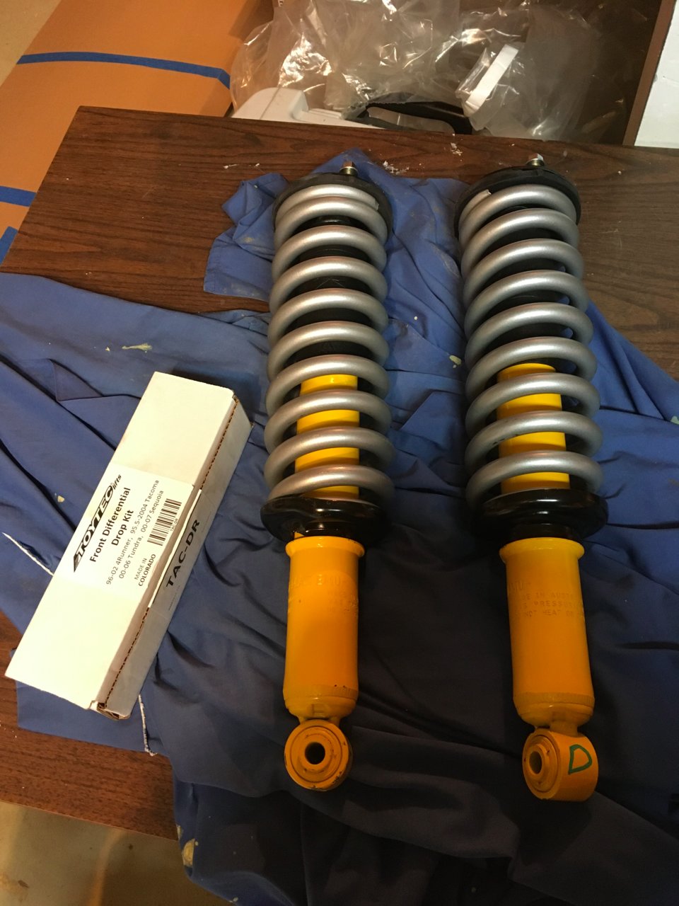

    the springs that i am running are the Toytec/Eibach 112-620P springs.
    these ones: , looks like they're backordered right now but you could call toytec and ask for an ETA. i'm running the Dakars in the back. No AAL currently but i have a set on order from Wheeler's. The front springs are so tall that the Dakars keep it exactly level without the aal. hopefully the AAL helps, otherwise i'll fabricoble some new shackles... or just buy some. hope this helps.
    yeah, i see what you're talking about with innner fender rub. i guess that extra .4" of width, combined with the 1/2"-1" (depends on the tire, some run a bit smaller from what i hear) of height does make a difference. for now i'm leaning towards the 285s. truck looks great though, i'd love to see a full pic once you get the chance. also, the fact that you have a double cab might be impacting the amount of lift. perhaps more reason to wait a little longer for the toytec coils?:notsure: here's a pic of my front struts before they went on the truck. i'm running the same shocks as you (OME nitrochargers) so you shouldn't have any compatibility problems.
