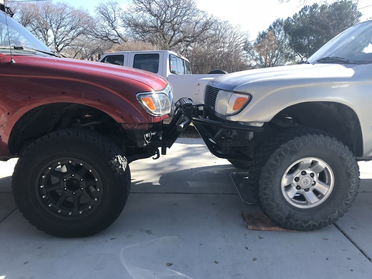

  7. Feb 27, 2018 at 10:25 PM
    Ruben526
    Ruben526 Well-Known Member
    Dec 13, 2014
    #144214
    193
    Ruben
    Salem, Oregon
    2001 Tacoma SR5 Prerunner
    Solo MOTORSPORTS LT basic kit with king 2.5 8” coilovers Advanced fiberglass fenders all around Deaver J59 springs with rear shock relocation to outside frame 14” 2.5 sway away triple bypass sway away 2” 2.5 bump stops 35” general grabber X3 17” addicts Total chaos spindle gussets
    Yeah I’m stacking it on top of my 2.5 inch fat bobs garage spacer lol but yes I have also just used that small of a spacer with a stick rear end didn’t look much different just helped with the very slight tire rub I had going on
