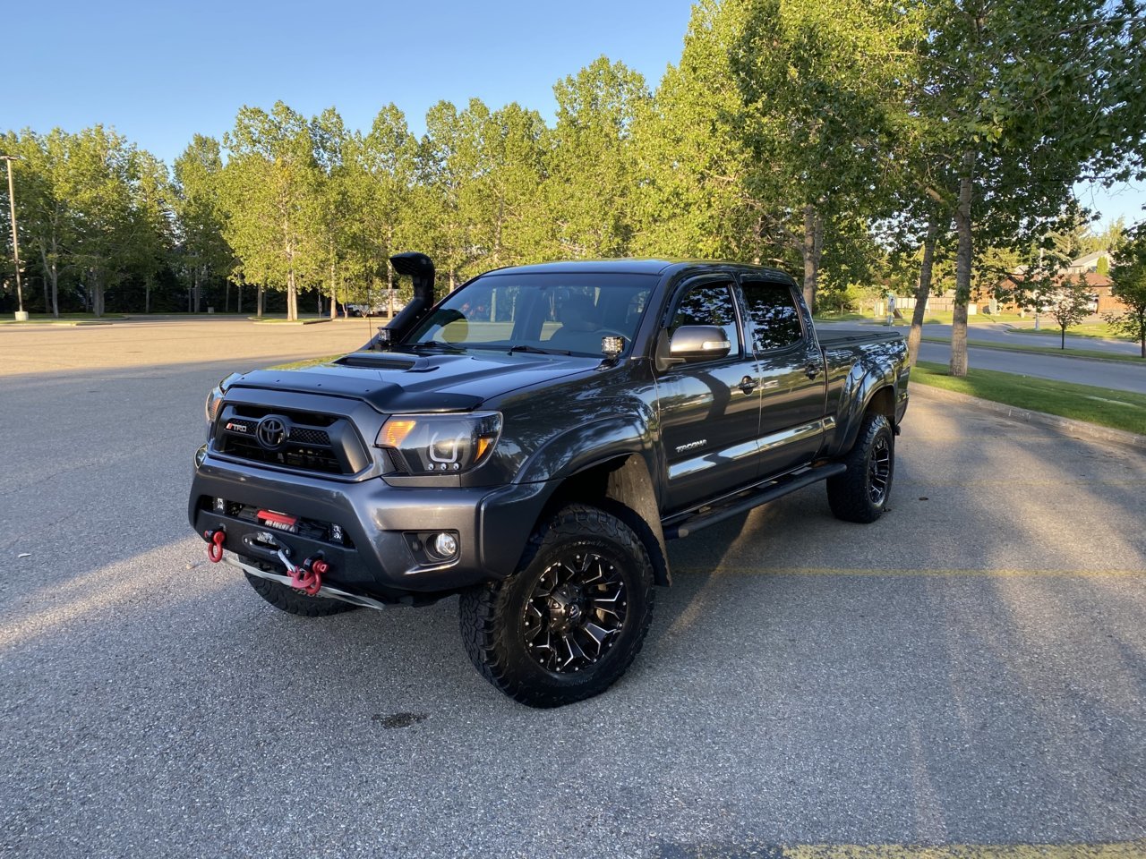

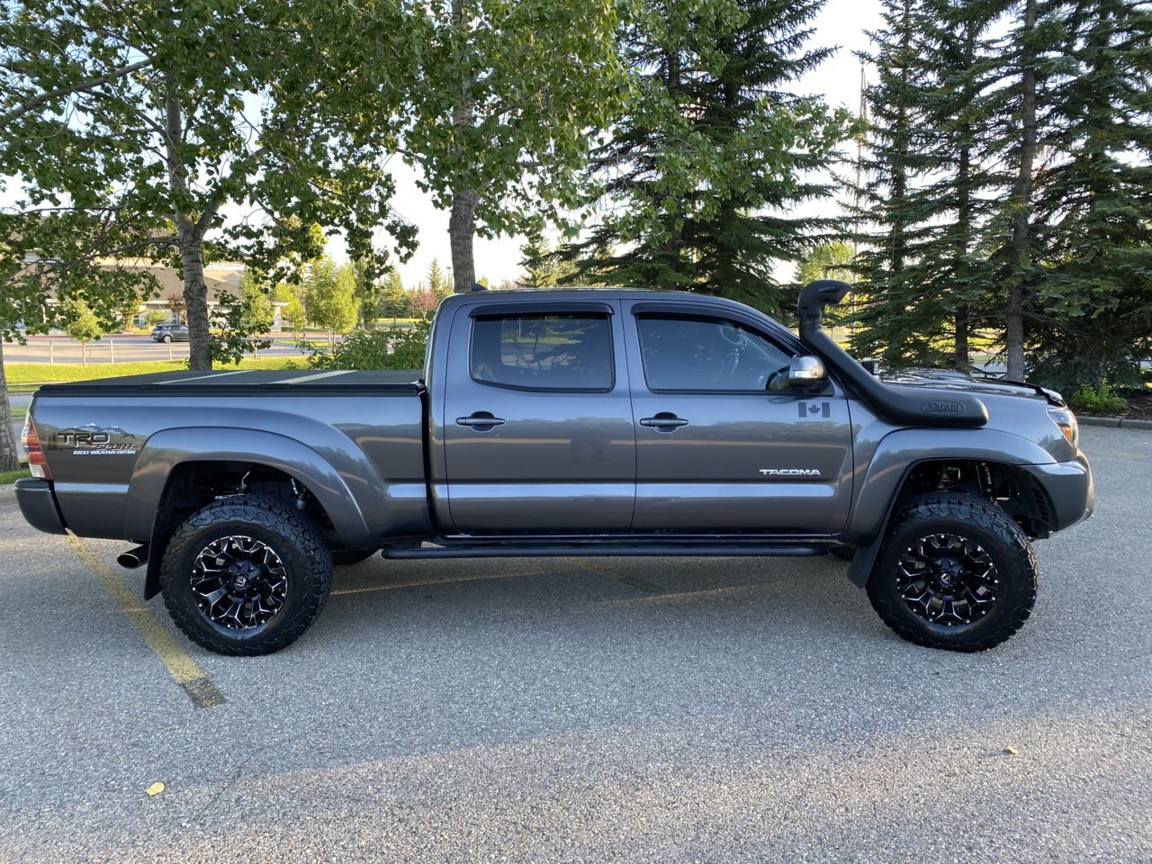

    Looks clean Jazz. I like the snorkel

    Nice truck!

    Did you have to do a cmc for that? What lift and wheel offset do you have? Thanks!

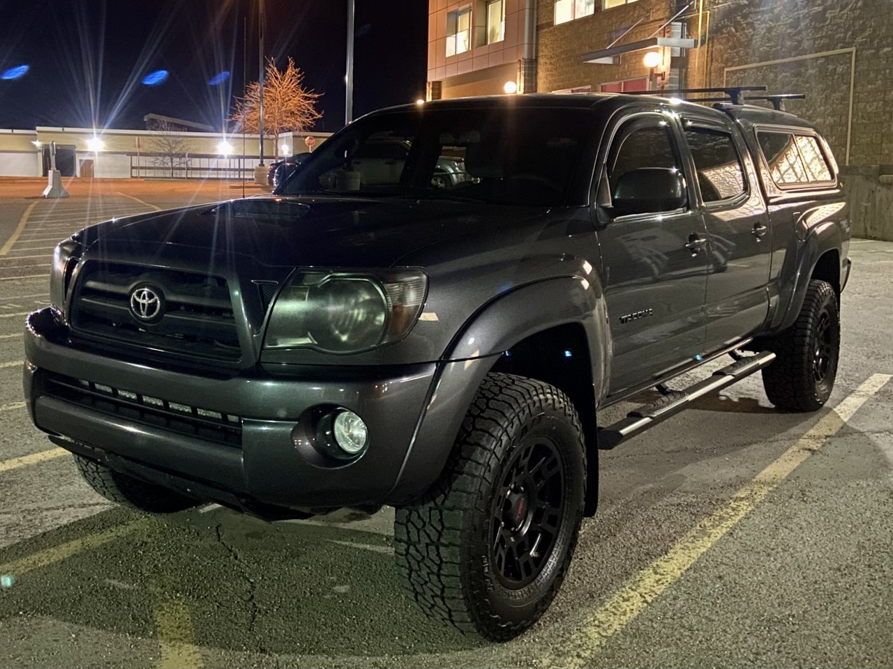

    3” lift front and rear. Colour matched Box topper with camping bed set up.
    2010 with TRD Pro and Falken Wildpeak AT3W

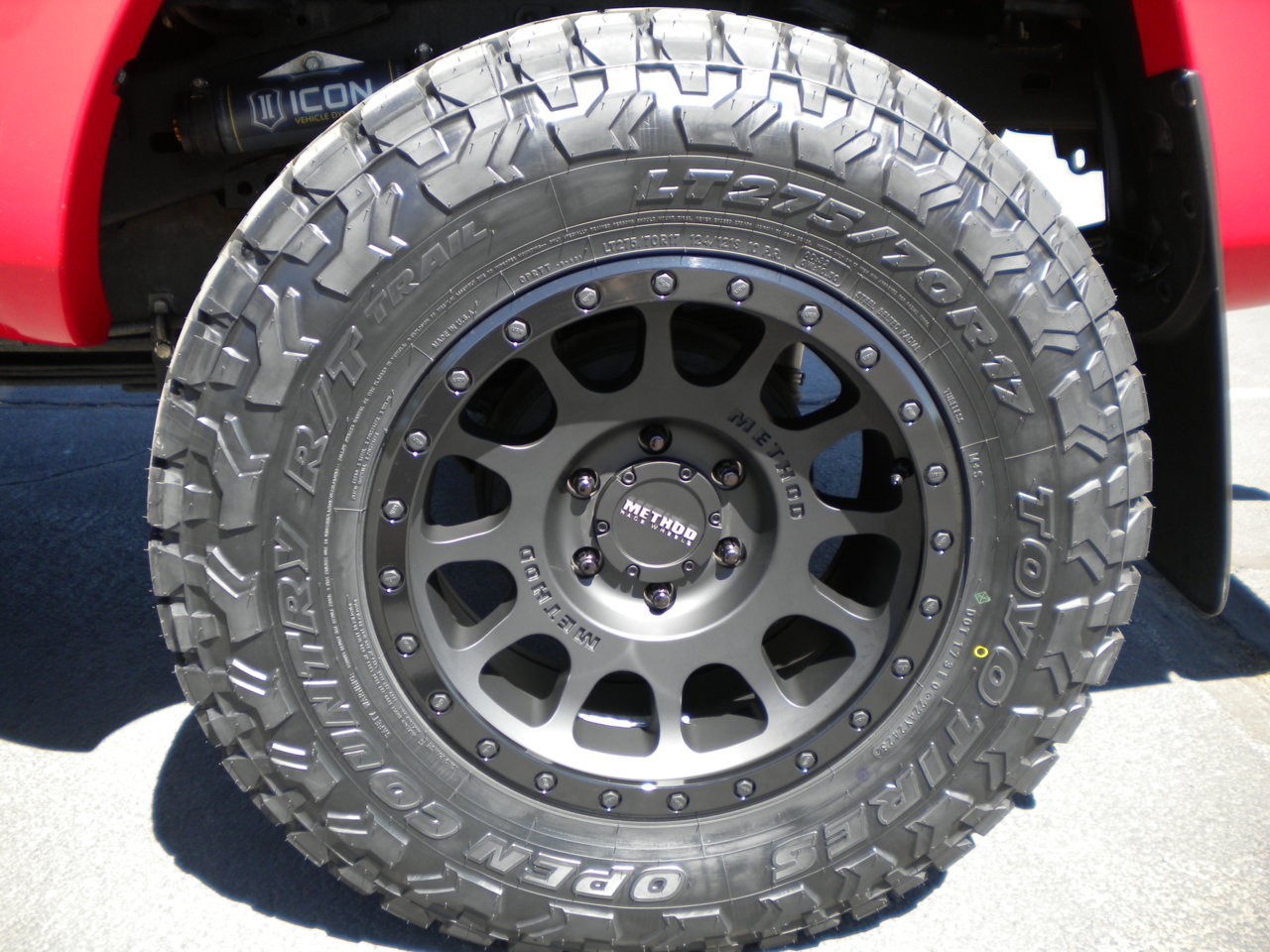

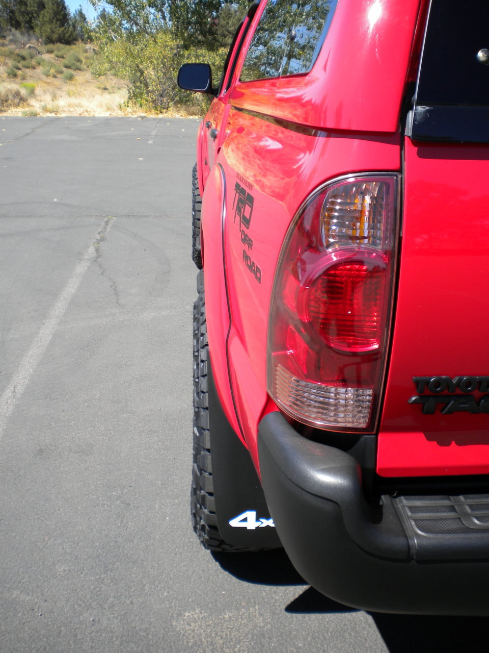

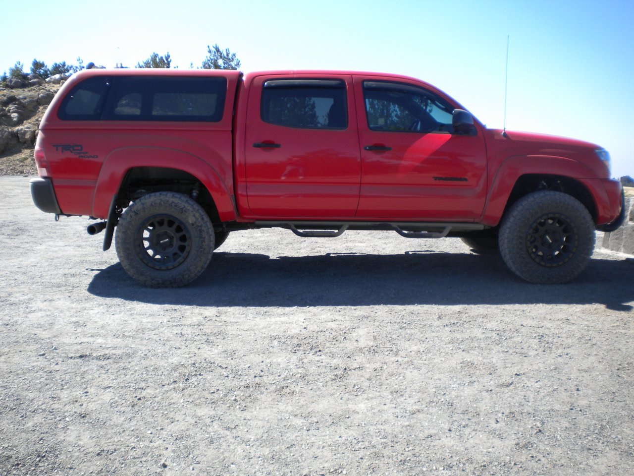

    Just to add for anyone checking out this tire size for their 2nd gen.
    275/70r17 tires, 0 offset 4.75 bs 8.5" wheels, icon stage 8... 2" front/back lift... rxt leaf's at option 2. Hub to fender front 22"/ 24" in back.
    No noticeable power loss (upgraded from 265/75r16) Auto tranny shifts the same around town and up mountain grades. Had to trim small amount of plastic and remove mud flaps up front... clears cab mount by 1/2-3/4" at full turn.

    This looks sweet!
