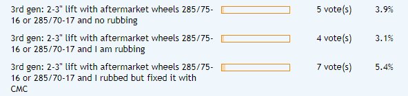

    Run enough caster and sure, it's possible to not do the CMC.
    Like I said, you'll most likely need it but it's not always required. I also see you're in San Diego so there's people like @Speed Freek or @Pelfreybilt who can do the CMC for you so cleanly that you wouldn't even know it's been done. Just throwing that info out there so you're aware. If you don't want to do the CMC hopefully you won't need it :thumbsup:
    By the way:
    Of the 16 that voted, 5 didn't rub and 11 did, so you have a chance to fall into the "not rubbing" category.

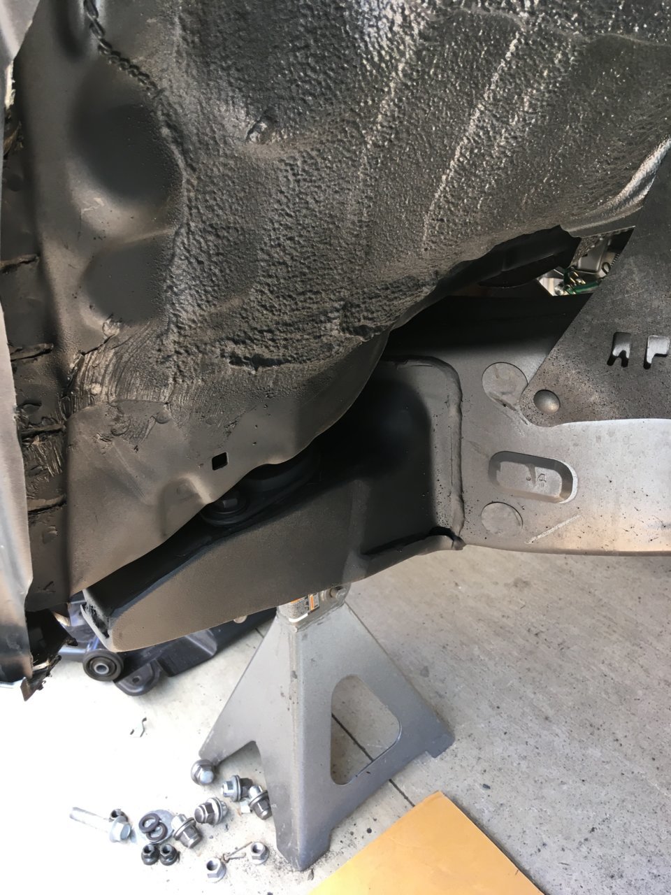

    Here is a CMC and pinch weld mod I did last week, I can make them look pretty clean. Been doing a ton of them to make 285s fit and typically they seem to do fine, some 285s are larger than others so take that in mind as well as the offset of the wheel...I have done over 300 of them to date!! I do a lot of them!

    That’s one of the cleanest I’ve seen!

    Thank you, I've had a lot of practice (over 300 so far!)
