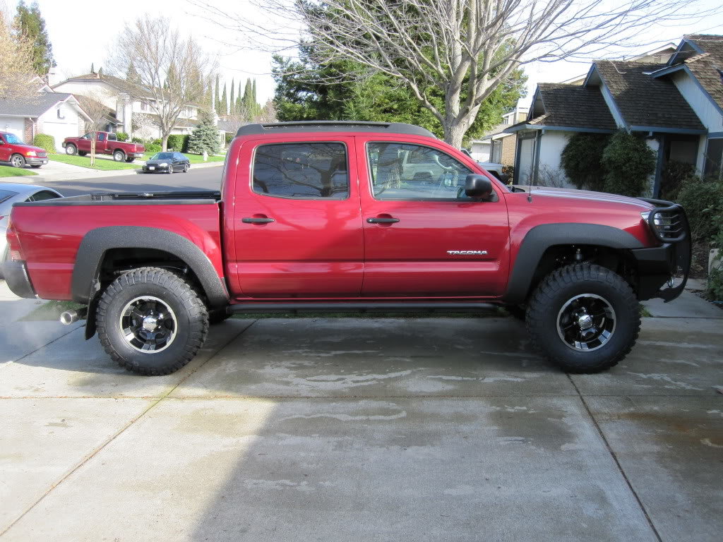

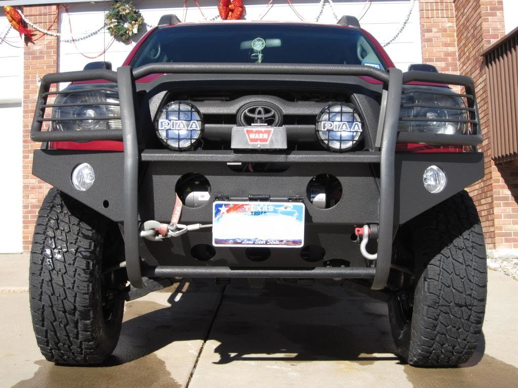

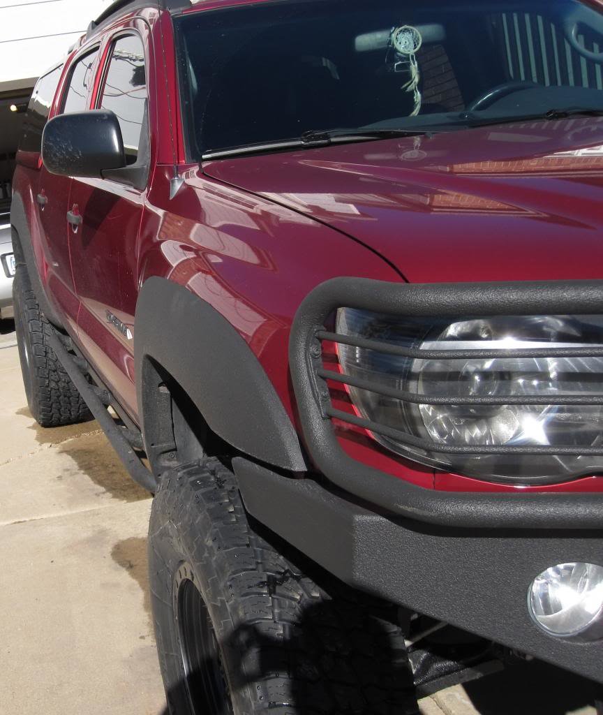

    295s are a little big IMO...here's some pics...
    Check out his build thread here -------> Build

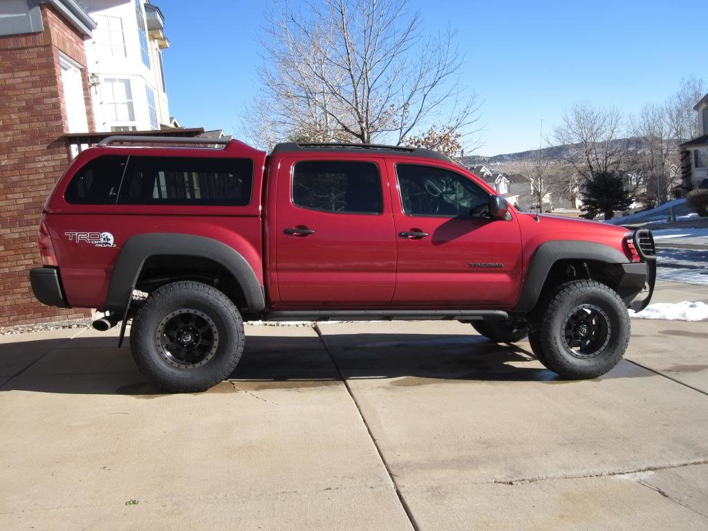

    I'm runnin 295/70/17's on a 3" pro comp lift. no cab mount chop. inner fender well on front. I do rub fender flares on heavy articulation in the rear but nothing major. I am gonna swap it out this summer and go to spindles with stock coils in the front and stock billies, and an all pro expo pack in the back w/ flip kit.

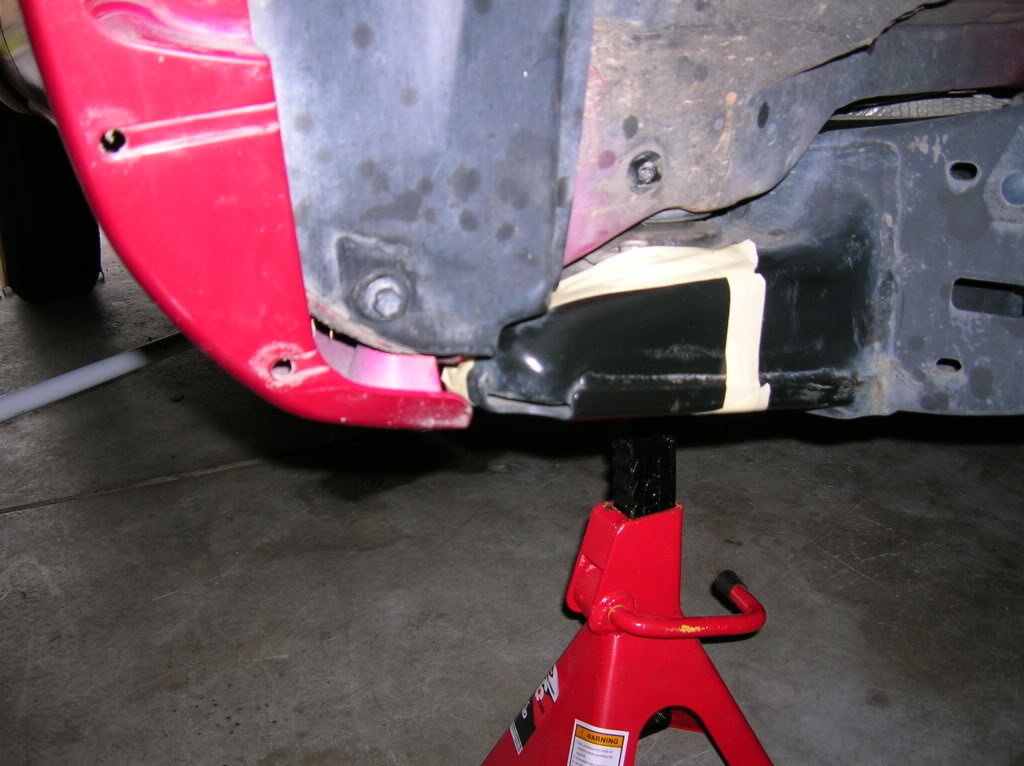

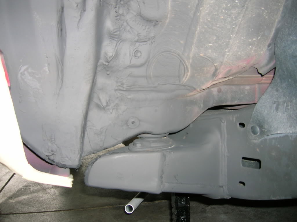

    I don't have any issues with rubbing with the 305-70-17 Nittos, but I have trimmed the plastic fender well and done the cab mount chop. Also, I don't have the factory front bumper, which eliminates that from rubbing. Since all posts are worthless without pics, I'll post some comparison shots.
    Nitto 305/70/17 Terra Grapplers (basically 34" tall and 12" wide on 17" X 8.5" wheels--4.5" backspacing, -6 offset):
    BFG Mud Terrain KM2 285/75/16 (33" tall, 11.2" wide on 16" X 8" wheels--4.25" backspacing, -6 offset):
    Cab chop before:
    Cab chop after:
