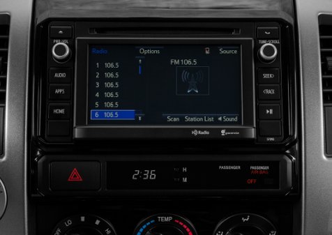

    Installed several cables for co-workers on 2014 and 2015. Their Head unit as below:
    For Rear Camera, look into ebay, Mainly you wanted a camera with at least 600 tvl and 170° such as this one.
    I installed a cheap one ($7.00) in my Taco (as an experimental when I r/d and designed schematic for Camera on 3rd Gen) and more than a year later that Camera still works great..

    Very interested but since I have a 2015 Entune I don't have AUDIO > Source >A/V.
    So how do you view the front camera on this model?

    You will not see (have) that option (Audio > Source >A/V) until cable is modified by either add-on, adapter cable...etc

    Ok. So basically if I want only a front camera, I buy your cable harness, buy a camera and hook it up. After that the A/V source option will be available and I can then select that to view the front camera. Do I have that right?
    I married my tacoma likes this.
  12. Nov 7, 2017 at 5:03 PM
    Hoangde
    Hoangde Well-Known Member
    Sep 6, 2016
    #196593
    589
    You got it!
    Let me rephrase that explaination:
    After hook up the HAI Cable to Head Unit, the A/V source option will be available to use. You can connect any Video, Audio input via Composite cable (RCA Connectors) as needed such as Camera, Media player, Smartphone Mirroring device ...etc.
