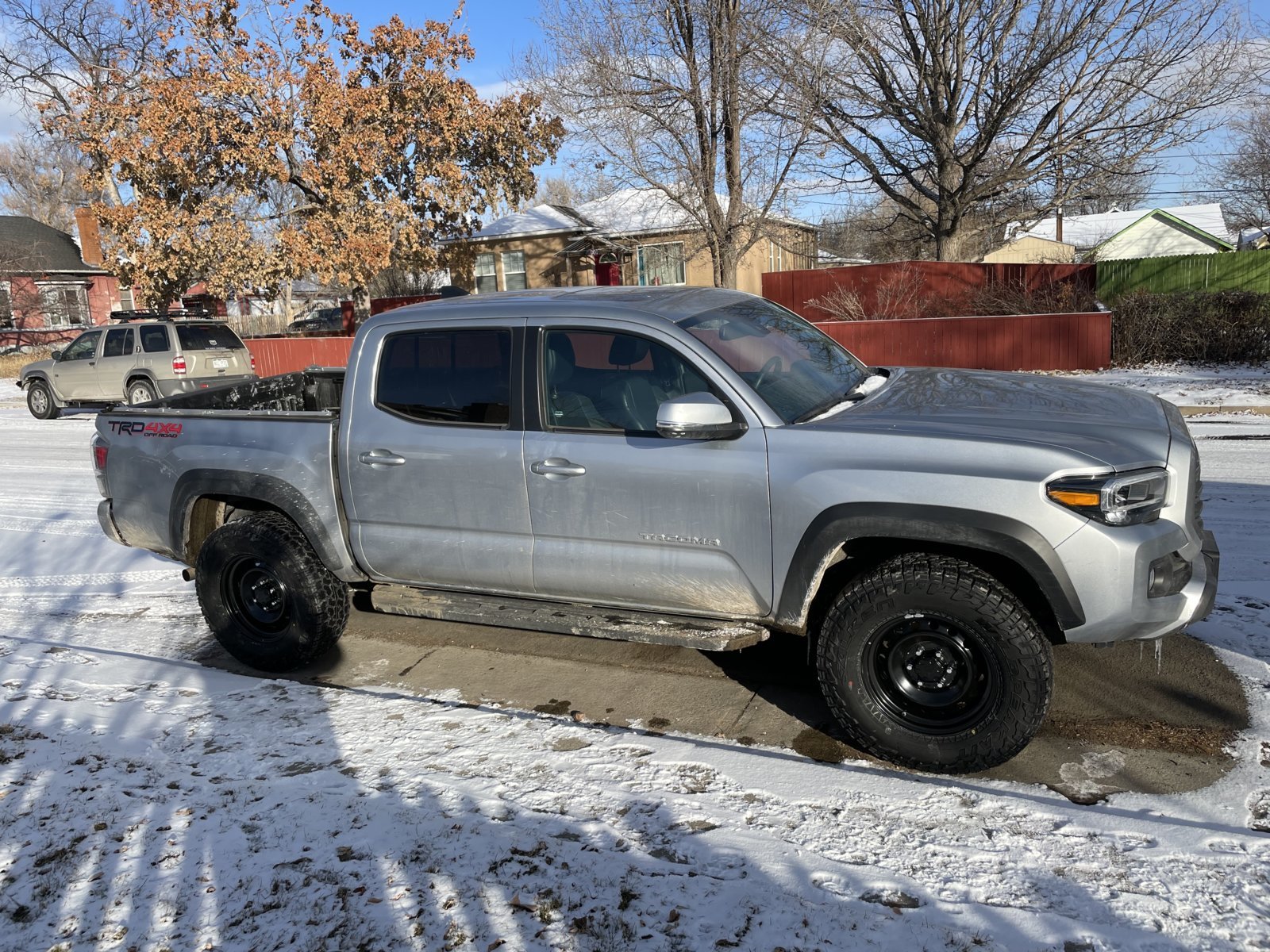

    After killing one of the original factory tires, I pulled the trigger on a new set of wheels and tires. I ended up going with some FJ steelies (+15 mm offset) and some 275/70R17 Wildpeak AT3Ws.
    There seems to be plenty of room and no rubbing with the driving I’ve done today.

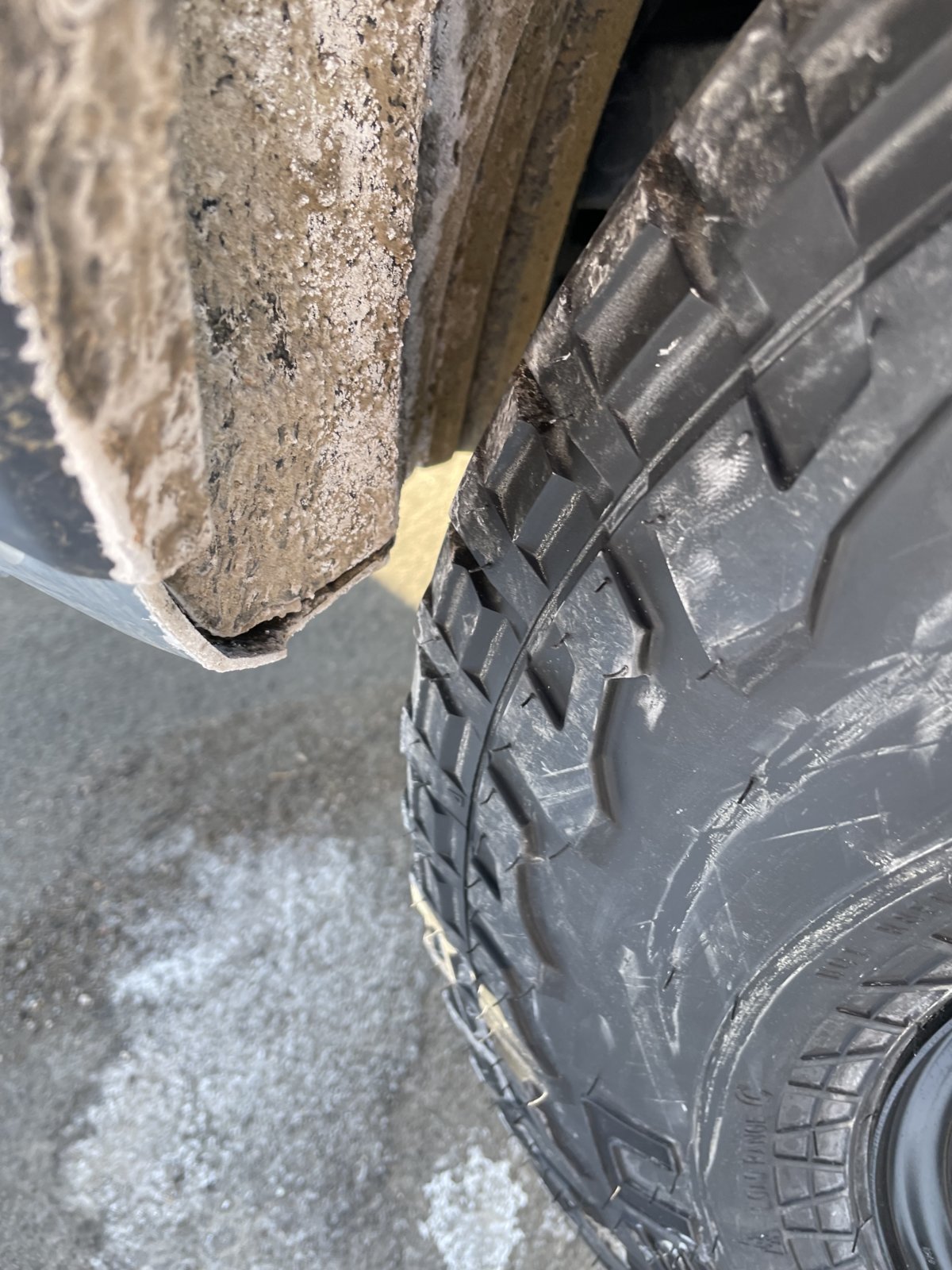

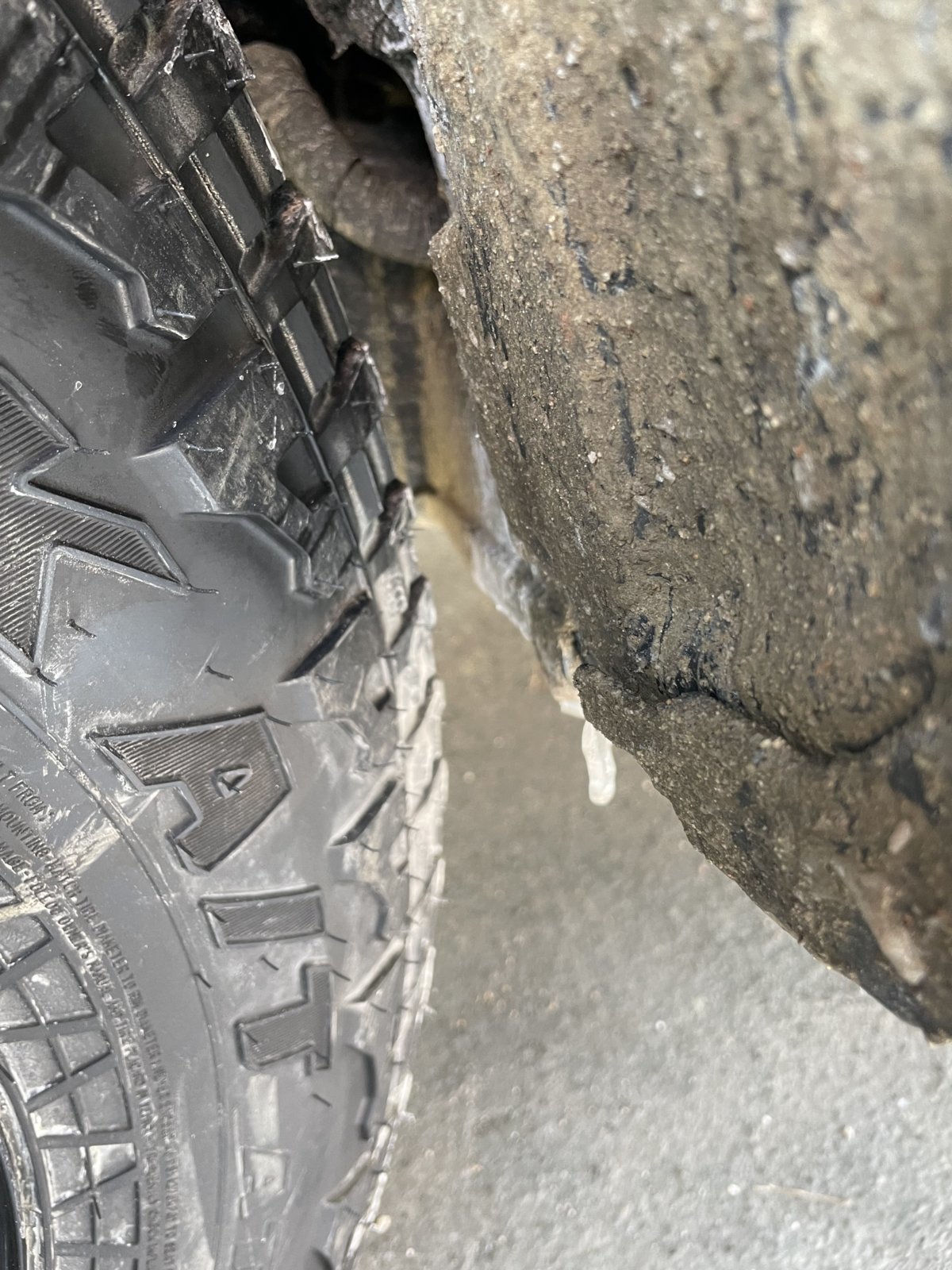

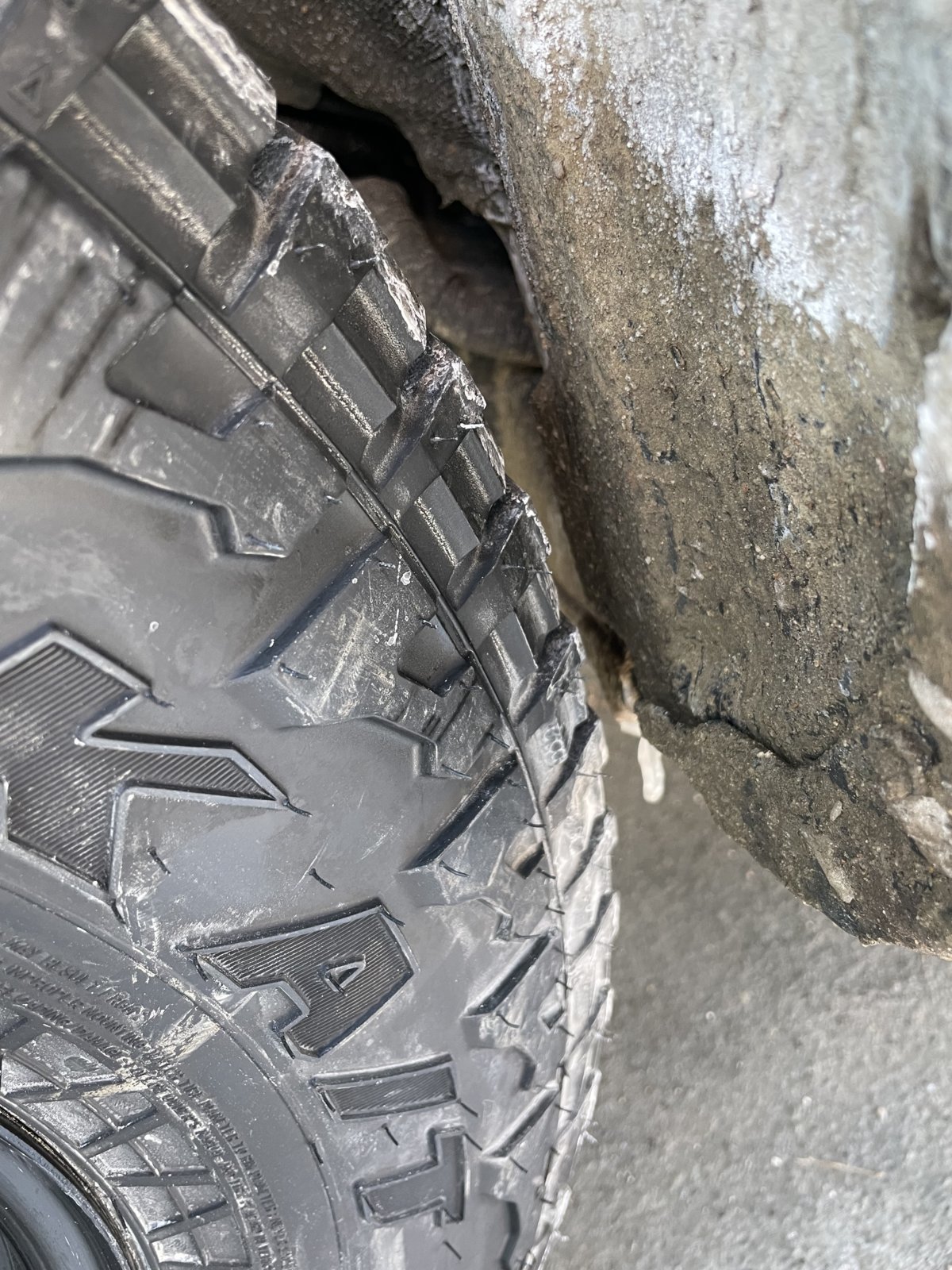

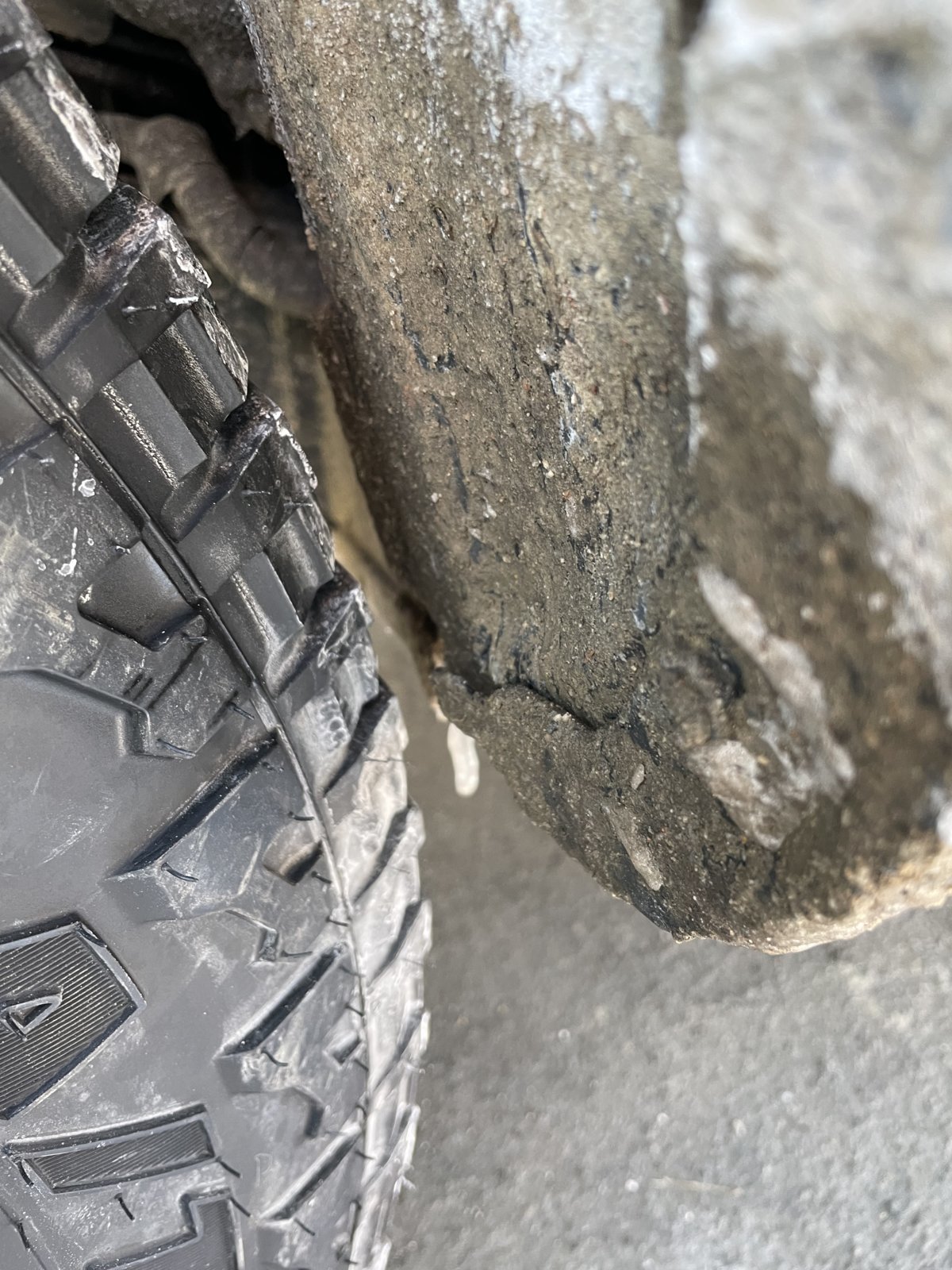

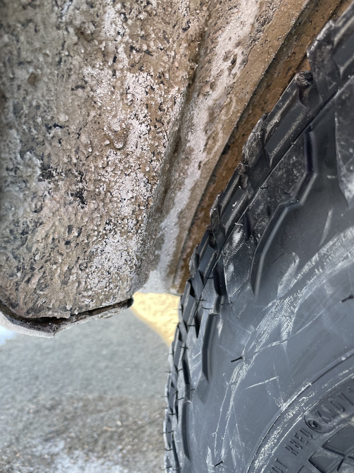

    The 275 AT3Ws are on the large size of a 32” @ 32.4 inches. A 285 33” @ 32.7 inches would be tight, but might just barely fit. A little bit of plastic work might be required.
    Here is the 275 clearance with +15 mm offset.
    IMG_2298.jpg IMG_2297.jpg IMG_2296.jpg IMG_2295.jpg IMG_2294.jpg IMG_2293.jpg

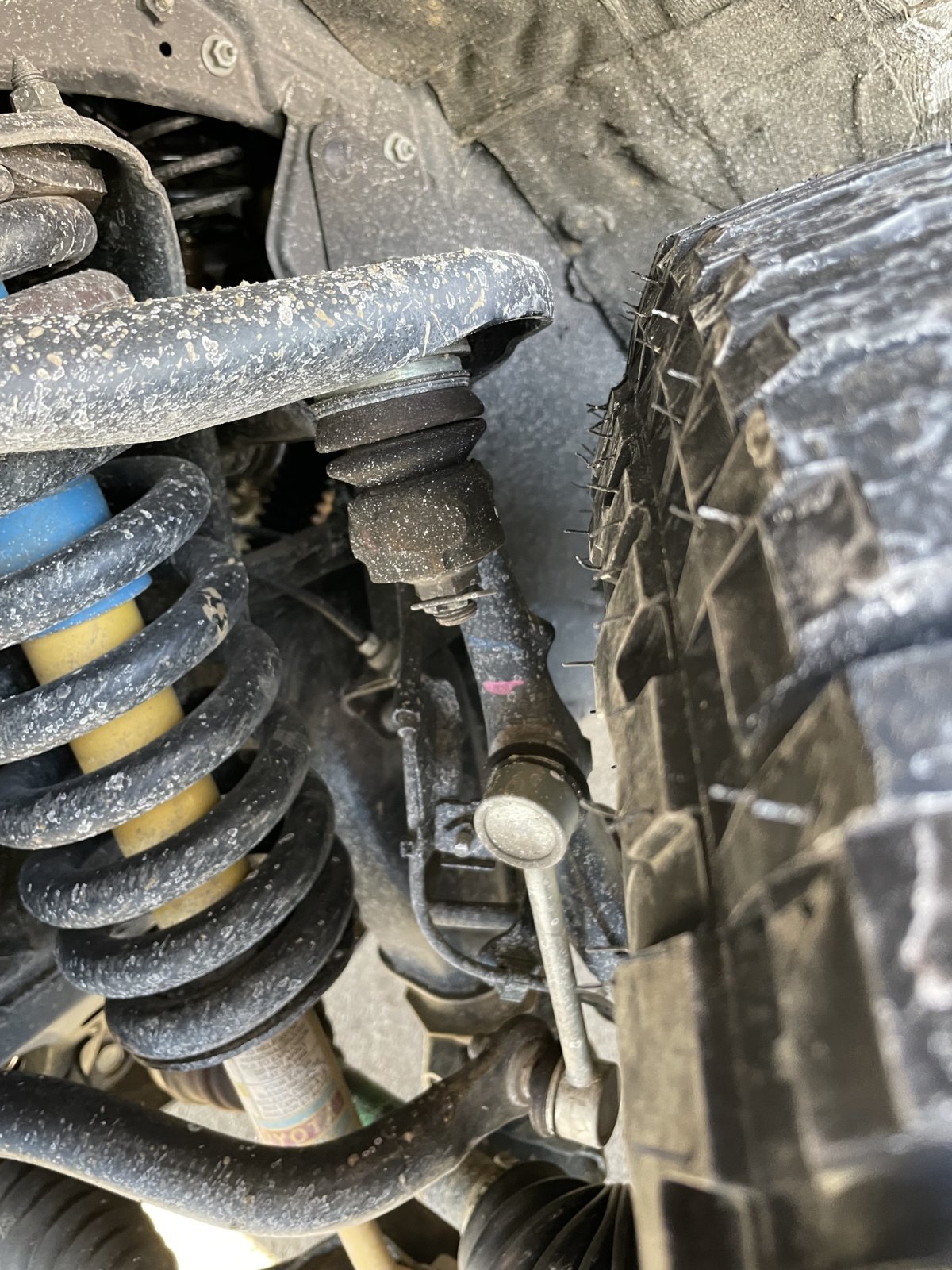

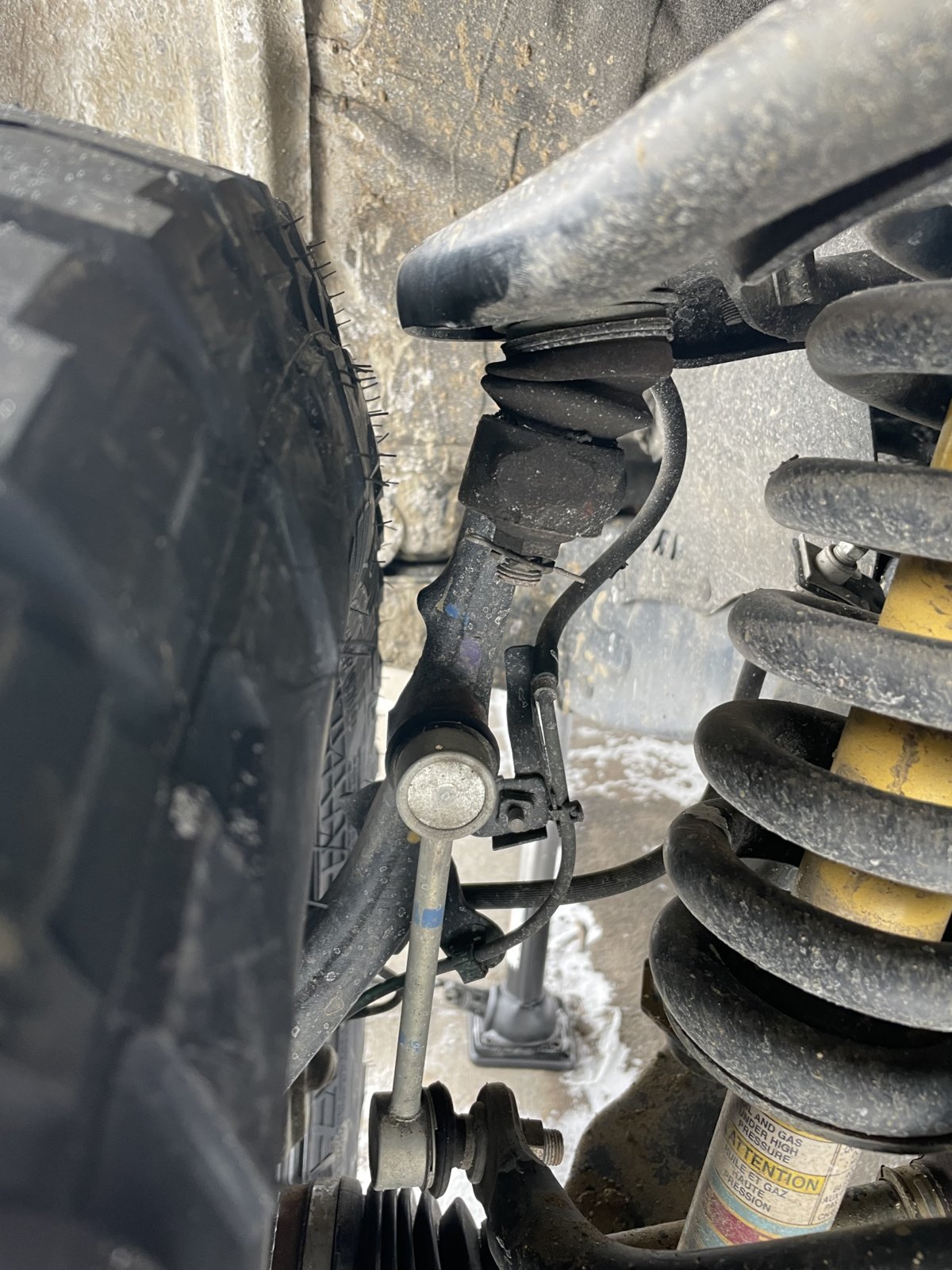

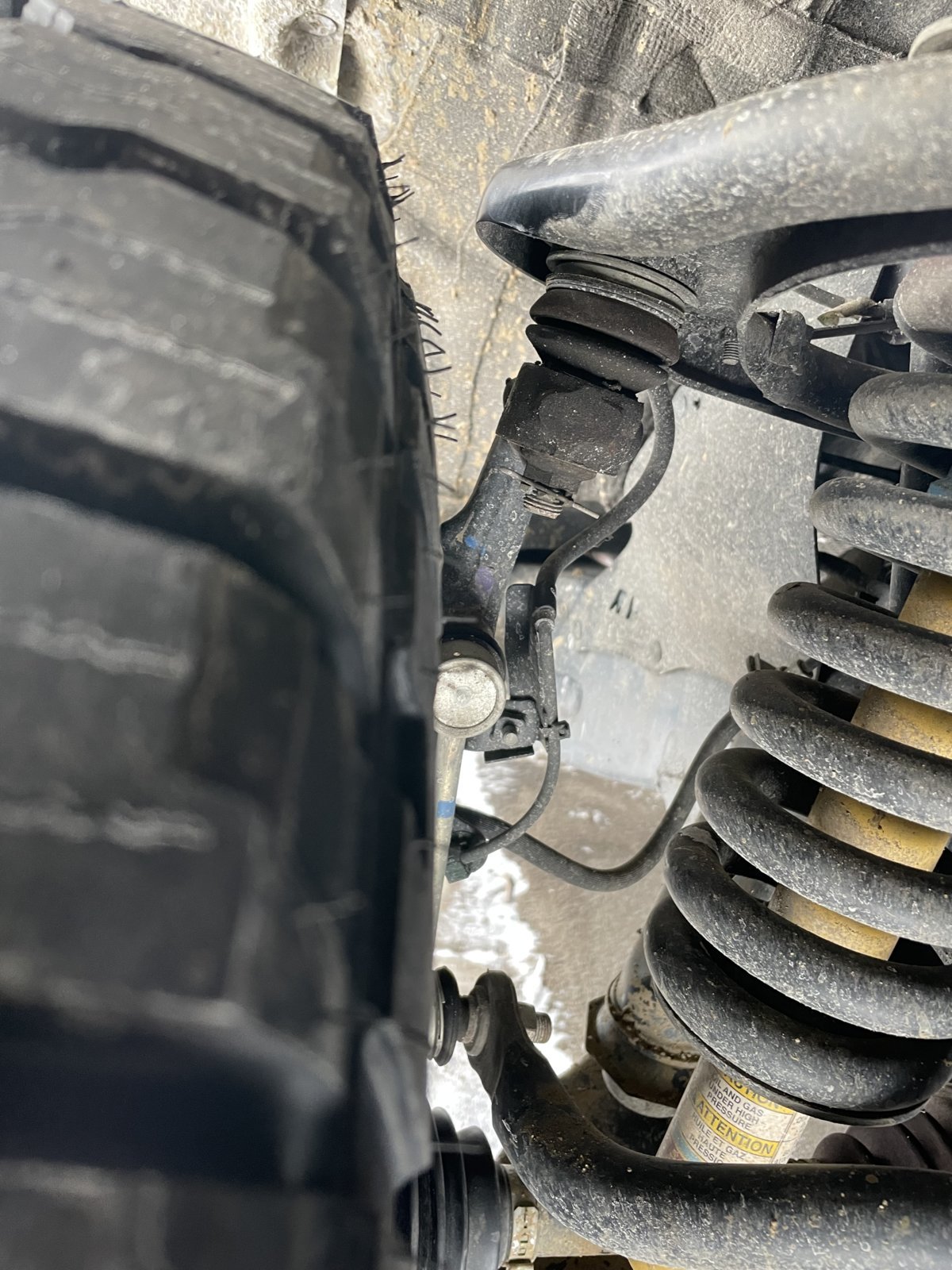

    Ok, this morning I felt the need to verify UCA clearance while articulating. It’s -5 degrees F out. I know I’m crazy.
    I took a picture of the clearance at normal height with the UCA pretty much horizontal, then jacked up the truck to lift the wheel off the ground to simulate full droop. I understand the sway bar will limit droop, but this test should give me an idea if there will be issues. Having the wheel droop pulls the tip of the UCA in, but the tire also widens too. Stuffing the wheel up wasn’t even considered since the UCA moves away from the top of the tire.
    With the oversized 32” Wildpeaks, there is enough room to fit my hand in between the tire and UCA, probably 10 - 15 mm. I think a 285 tire @ 32.7” in diameter would just barely clear the UCA. Maybe a wheel with +13 mm offset would give a little more room without sticking out too far to cause major issues elsewhere.
    (In the pictures, the clean spot on the UCA is from my glove, not tire rubbing)

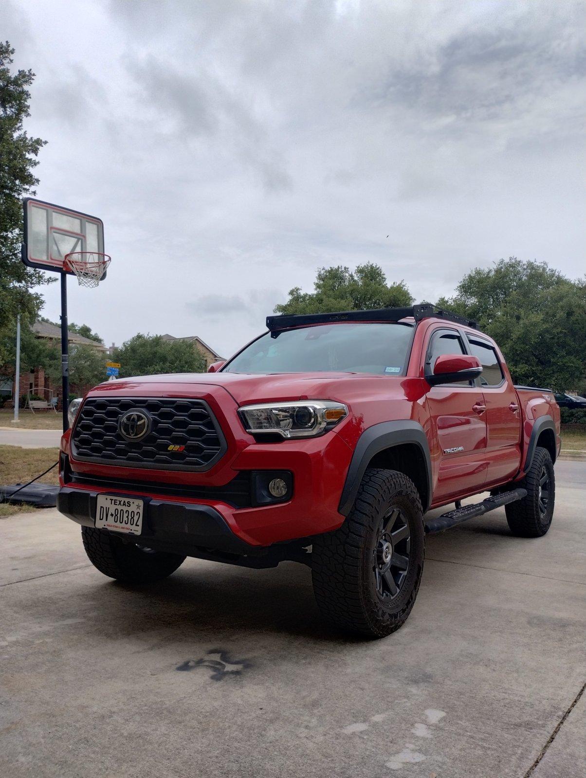

    19 Red TRD Off Road
