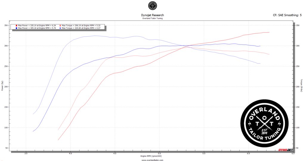

    Those tuned numbers are pretty stout. Looks to be more tq than a Magnusson 3rd gen. And I'll bet the turbo makes it drive even better at lower RPMs that a chassis dyno can't really show.

    You're 100% spot on. The Beta tune that we have on the 4G currently really puts a hurting on a 3G Maggy below 5000RPM.
    RED - 3G Maggy Auto
    BLUE - 4G Auto w/ "beta" tune
    The truck spools a bit quicker with the calibration giving a pretty noticeable bump in torque when pedal input is 'low'. It drives very well (and tows better tuned). We'll have a separate post on this coming soon.
