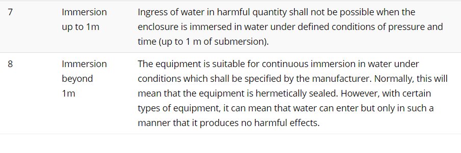

    In regards to a winch being waterproof, here's some good info. The "non waterproof" smittybilt winch is rated IP67, whereas the waterproof one is rated IP68. What's that mean? The first digit (in this case the 6) means "the level of protection that the enclosure provides against access to hazardous parts (e.g., electrical conductors, moving parts) and the ingress of solid foreign objects." So for these winches, they are dust tight.
    The second number is the protection of the equipment inside the enclosure against harmful ingress of water. The 7 means "Ingress of water in harmful quantity shall not be possible when the enclosure is immersed in water under defined conditions of pressure and time (up to 1 m of submersion)." The 8 means it can go deeper than 1m.
    What I'm getting at is that although a winch may not be marketed as "waterproof", it's still plenty water tight for 99% of our needs. I personally won't be trying to forge through more than a meter of water.
    http://www.dsmt.com/resources/ip-rating-chart/

    But seriosly that was some good info on what the scale means on waterproofing
