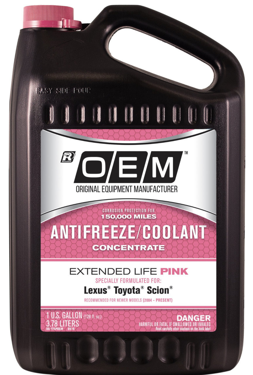

    I am approaching 100K miles on my 2015 2.7L and am planning on draining the radiator and block (not doing a full flush). Has anyone used this concentrate? My local dealer wants $30 per gallon for the 50/50 pink. I am thinking this HOAT coolant is completely compatible with the OEM at half the price.

    Using the name OEM makes it feel like shady marketing, which makes me think shady product. Just my own 2 pennies.

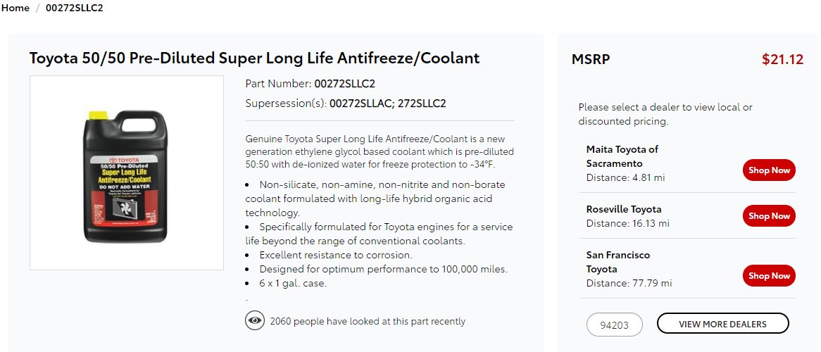

    Here is a snip of the Toyota OEM SLLC page:

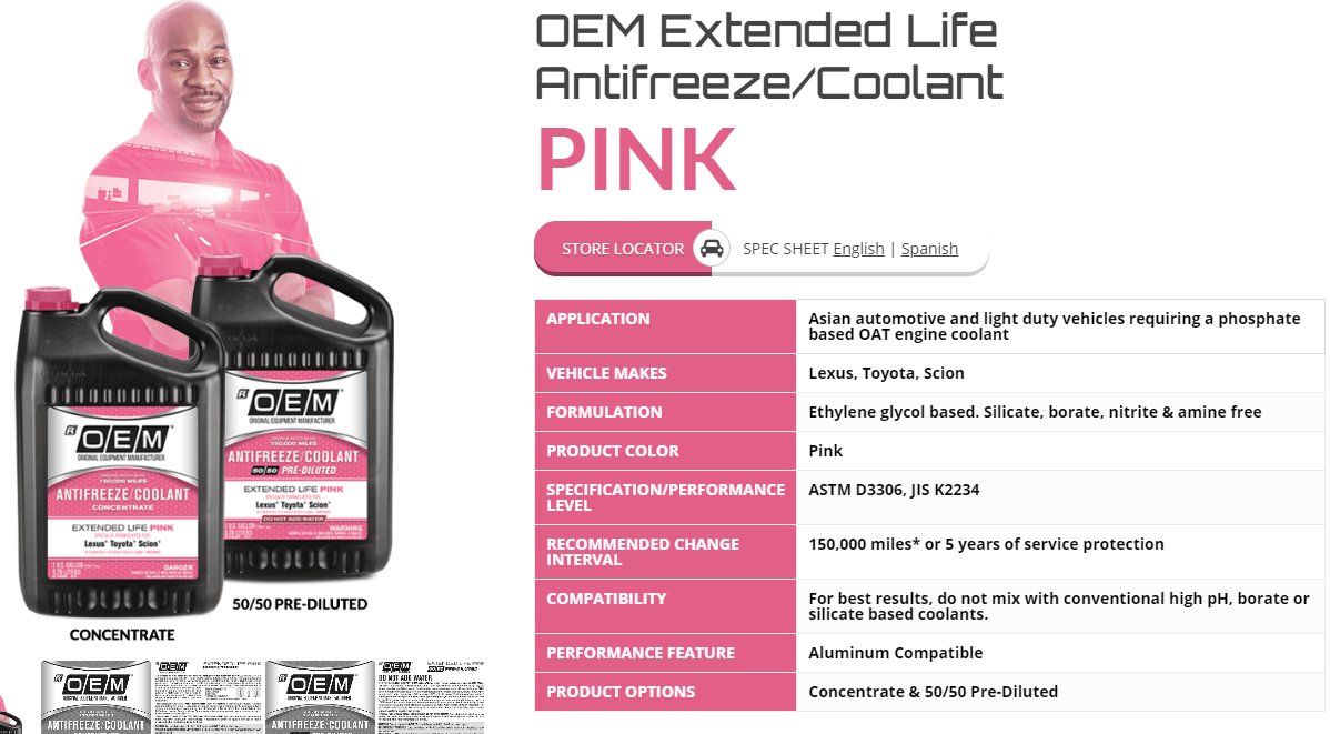

    And here is a snip of the specs page for "OEM" brand extended life coolant:
    Both are ethylene glycol based. Both are silicate-, borate-, nitrite- and amine-free. Looks like you would be fine using this. You might research the ASTM D3306 and JIS K2234 specs.
    My question: is it worth saving $25 over a few years time for the cheaper fluid? I have used the Zerex Asian coolant (SLLC equivalent) before and not had any problems. But now I'm rethinking this decision, might cough up a few bucks for the Toyota SLLC for future services.
    Your call.

    If it were truly OEM, it would look exactly like the jug in post #6. I'm not knocking any of the alternatives mentioned here, just the bogus company that has the audacity to claim that an AFTERMARKET coolant is OEM.

    Yes - I'm aware and there's no mention of OE thus far in this thread other than your comment. The jug says OEM. Unless Toyota licensed their SLLC, which I doubt they have done, the only OEM coolant is what's shown on post #6.
    I suppose it's possible Toyota changed the color scheme of their SLLC jugs. I'd like to see the other side of it.
    Counterfeit abounds in the auto parts industry.
