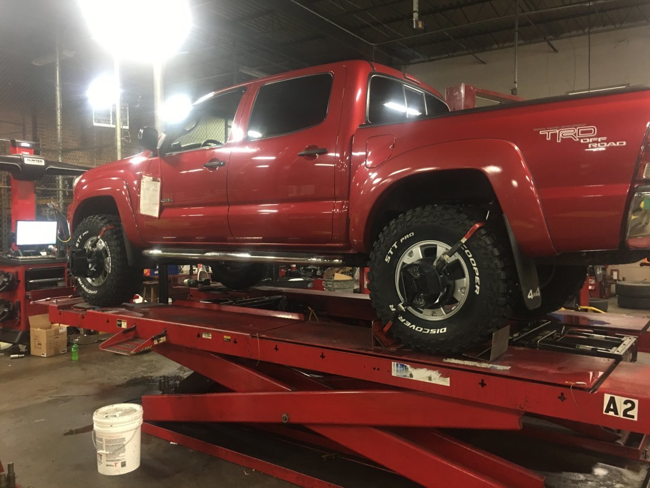

    I ran one for 3k miles. No issues or complaints. I removed to install a 6 inch lift. If you want to go for it I'll sell you my kit with diff drop.
    These spacer lifts have a following of folks who spit on them. But at the end of the day, there are hundreds of thousands of trucks out there running this lift every day.
    There is a lift out there for everyone and a truck that will see mostly street use does not need $3000 coilivers.

    285's

    285 75 16? No rubbing issues? No triming? I have an 18 or would like to put a level kit on it

    I had to trim the bottom corner of the front fenders. Edge closest to front of the truck.
