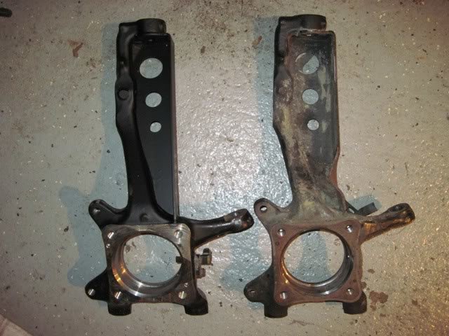

    Whoops... I meant TC's old style gussets. The new ones are boxy looking.
    old
    new

    Nope, they're the newer ones.

    Also, since on the topic of spindle gussets, is there anyway to weld these on without completely removing the spindle? I wondering if i could just pull of the wheel/tire . . . but maybe the heat would end up damaging the axle seals or break pads or something.

    lol...well that plain sucks. I just figured you had the older ones due to the age of the truck. I guess you are on your second set? and now third?
    ABS sensor, axle seals, etc don't like red hot heat.
    Just remove them. Not much work IMO.

    I guess my concern would just be the heat transfer to neighboring parts that would concern me. . . . ABS sensor is a good example . . . break calipers/pads/break fluid. Axles/seals/grease.

    besides risking the burn
    Not sure how you would evenly heat the spindle in order to weld it while it's installed....not sure it's possible

    hmmm . .. I would think the evenness of the heating would be more related to MIG settings . . . and technique, adequate removal of all paint, etc. Whether it's lying on a workbench or still on the truck just makes it ergonomically more challenging. And of course the possible heat damage to neighboring components. Not sure what you mean by evenly heating the spindle.

    I heard the spindle must be heated up before welding because it's cast. I am no welder nor do I know anything about the art of it so that info could be inaccurate.

    Totally agree . . . looking at it . . . it would be a real PITA on the truck . . .have to pull them off.

    Off topic tangent, but for anyone who has welded on the Total Chaos spindle gussets, once you take the wheel off, and disconnect the tie rod steering link, remove the brake caliper, and brake rotor, and remove the upper and lower control arm links, how difficult is it to separate the spindle from the wheel bearing/hub assembly? I know there are 4 bolts that hold the wheel bearings onto the spindle, and then the hub is pressed onto the wheel bearings. I know it is a real PITA to separate the hub from the wheel bearings without a press, but can the wheel bearings and hub together be easily separated from the spindle?

    They come off easy. You need to use a box wrench and loosen each bolt a little, move the assembly away from the spindle, loosen again, move again, etc. There isn't clearance to loosen each bolt completely without moving the hub & bearing assembly out of the spindle as you're working.

    Thanks. But once you start to loosen those 4 bolts, you can pull by hand the hub/wheel bearing assembly out of the spindle? Then loosen the bolts some more . . . pull out some more?
    Are there any O-rings or seals that need to be replaced? Also, is there a difference regarding wheel clearance between the two versions of the Total Chaos gussets (sway bar retaining and sway bar eliminating)?
