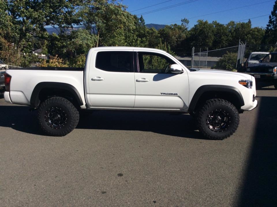

    Mike's Custom Toys
    Mike's Custom Toys Well-Known Member Vendor
    Jun 28, 2017
    #222593
    1,006
    Grants Pass, OR
    285/76/16's fit with this
