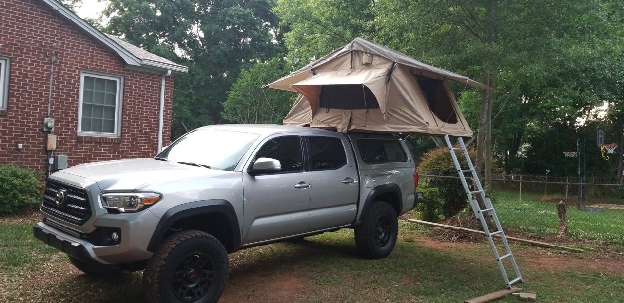

    I have an A.R.E. camper shell with a rhino rack and camp with my RTT on it! Works great! Sleeps comfy and is sturdy as hell!! Here’s a photo from this weekend!

    Nice looking rig man!

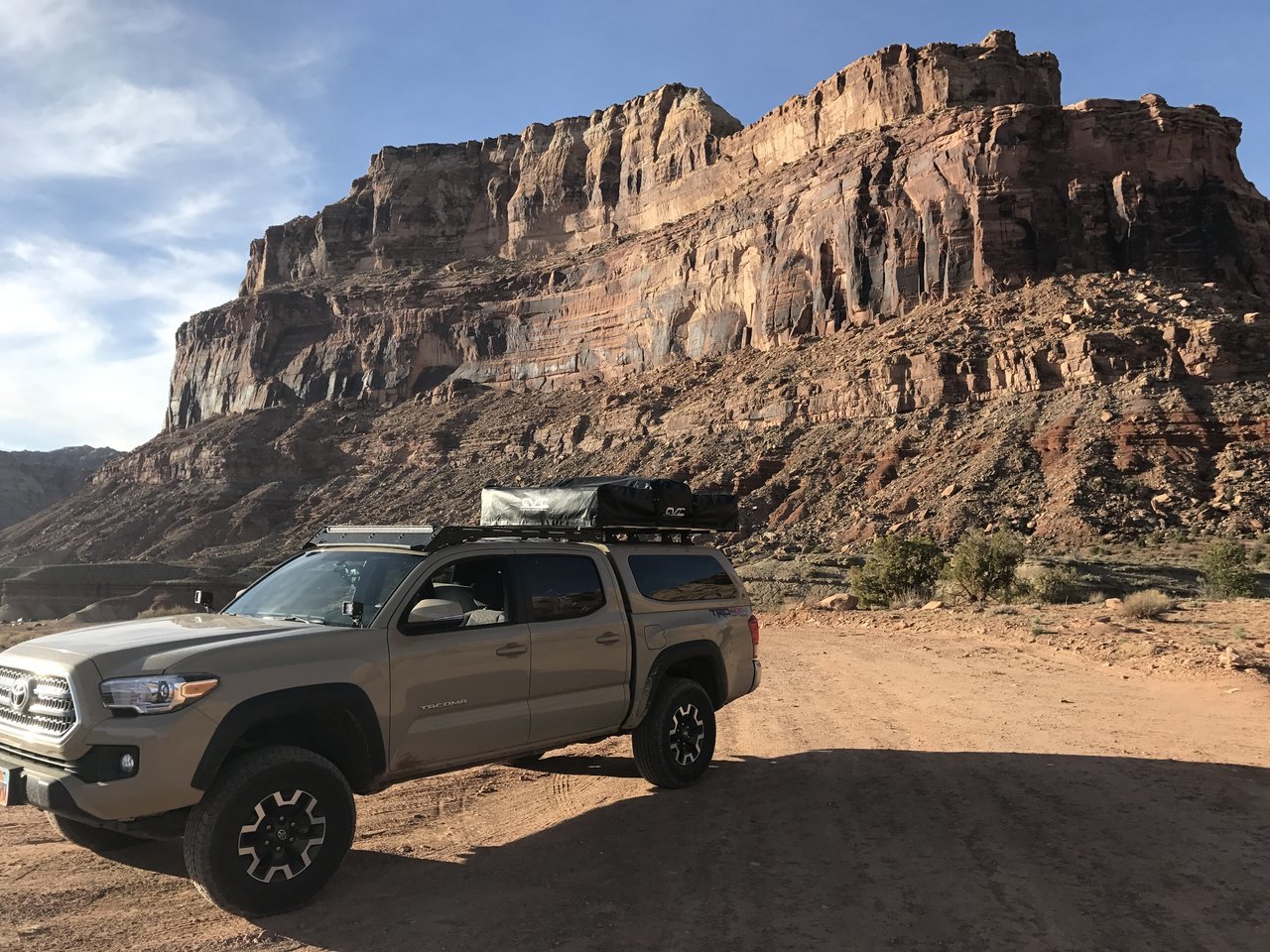

    Nice loooking rig man!! Just like mine but white!! I have the same ARE shell!

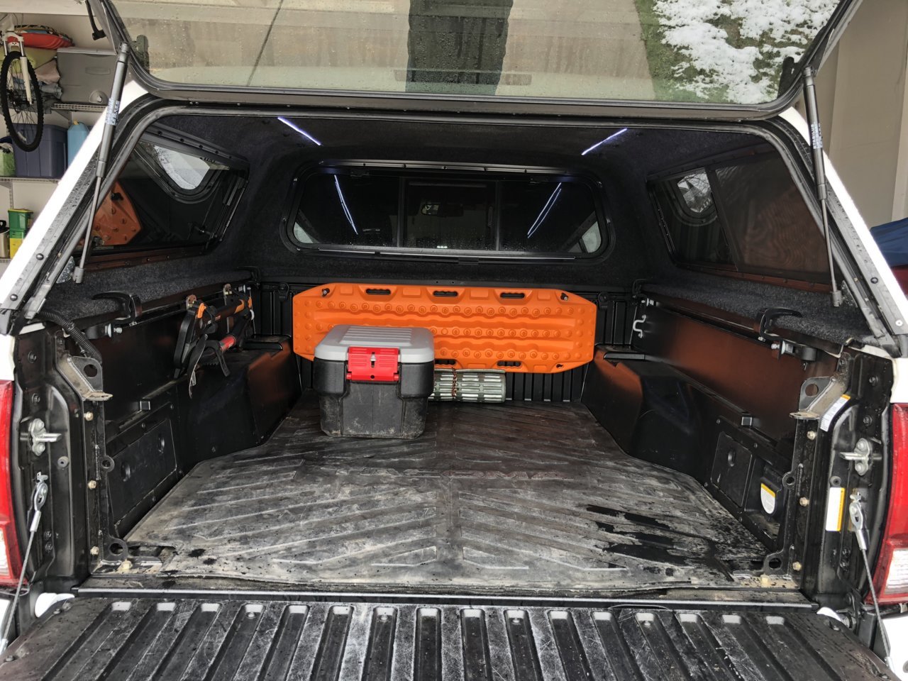

    Thanks. Looks great in Quicksand. I've been happy with the shell. I recently added Bed Stiffeners just to be safe but bed was not bowed when I installed them last month. Photos are from a trip to Utah in October

    Who did you go with on your bed stiffeners? I’d really like to get some!

    I went with Total Chaos. I think they have an Ama

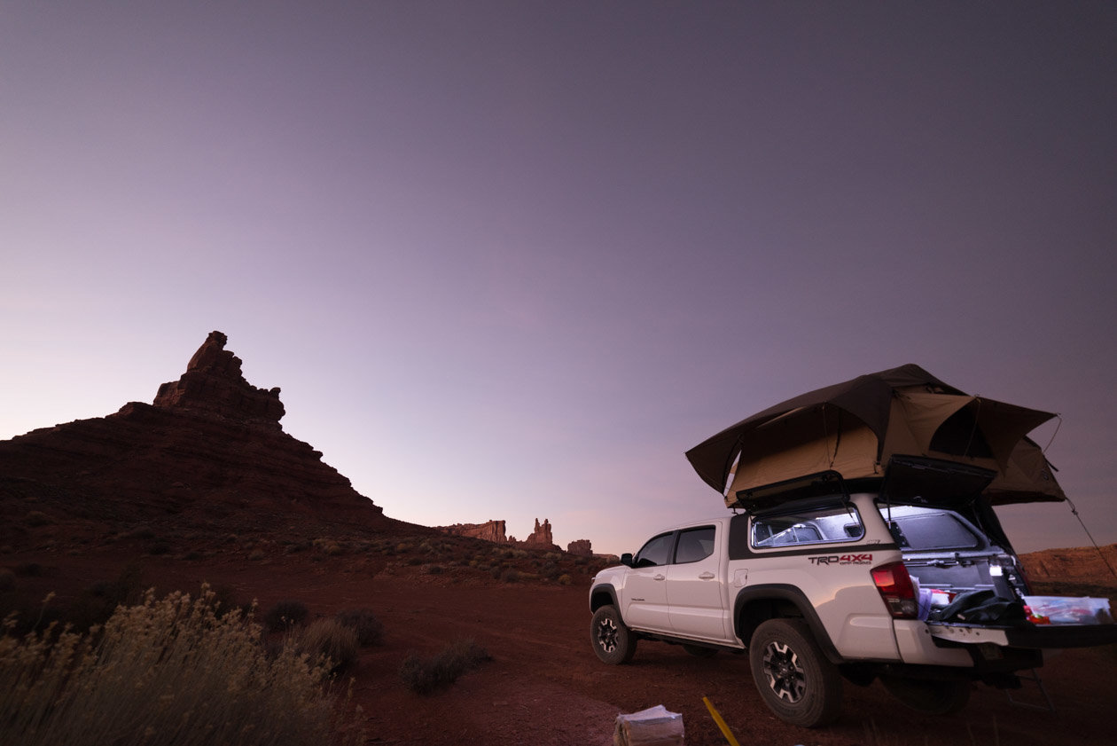

    Leer 100r, smittybilt tent.

    I’ve been looking at those because they actually go all the way up the bed, other ones only go 3/4 the way up. I figure they perform a lot better

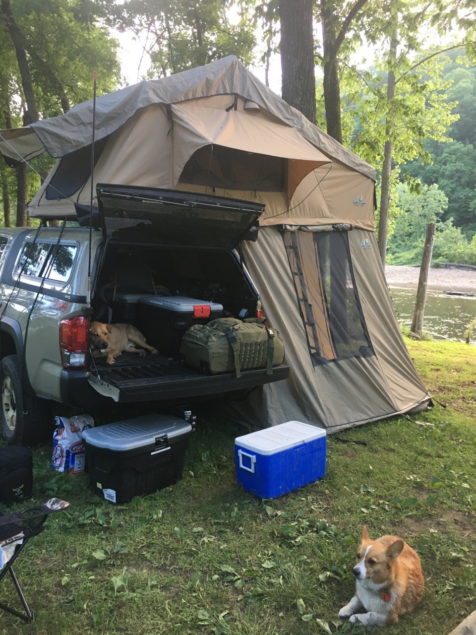

    I kept mine mounted on the shell for about a year using 3 Yakima crossbars. The tent was secured to 2 of the bars and then just resting on the one bar crossbar in the the middle. I have noticed my bedsides starting to drift outwards. But that has since been corrected with some of bentrodders bed supports. I highly recommend getting some.

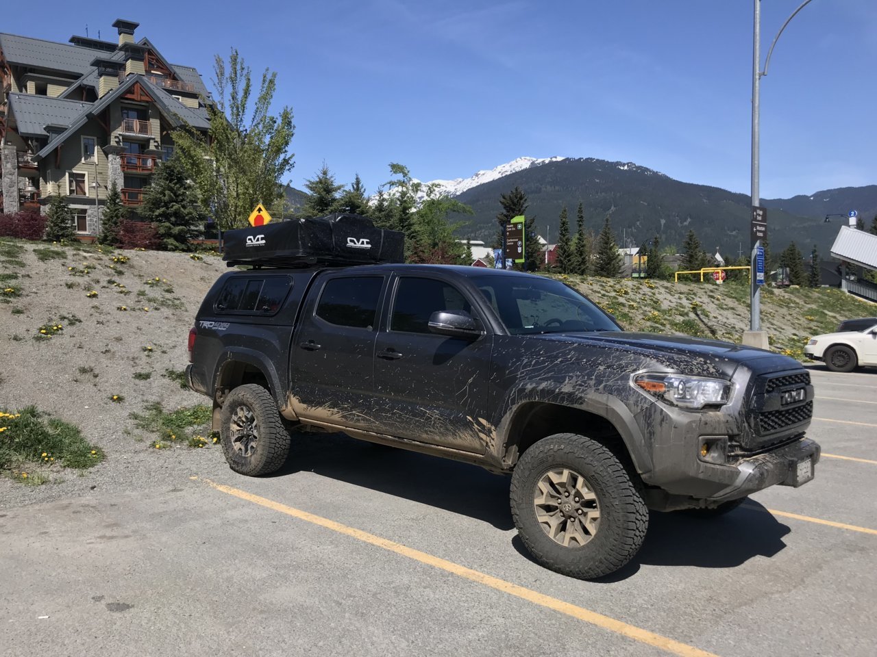

    I have a CVT Mt. Bachelor Extended. I used to run an ARE V Series shell with yakima crossbars. Currently, run a Snugtop Rebel (Sportsman package - increases strength of roof by eliminating traditional honeycomb roof structure) and Prinsu TopRac. The Prinsu will allow a lower profile but will be more frustrating if you are taking on and off, compared to the Yakima crossbars. You will want to add bed stiffeners and upgrade your rear suspension. I opted for a dakar heavy leaf pack.

    Nice rig. It’s nice having the tent fold off the the back too. With an annex it made a great area for the dogs to roost in the bed of the truck.

    Exactly! Switching the orientation of the tent allows me to cook over the tailgate while being covered from rain - more people should do the same.
