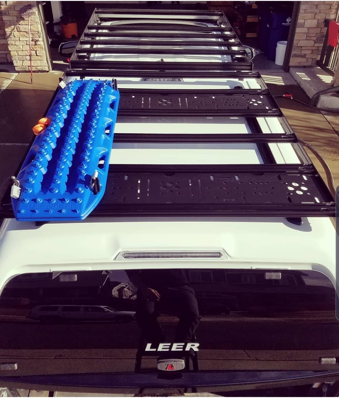

    Post directly above yours has my Thule rails with a Full Prinsu rack. It came on the shell as an extra. Think it was like $150 or something. They work great. Everyone I know with a shell uses the Thule rails. But I'm sure the Yakima ones are similar.

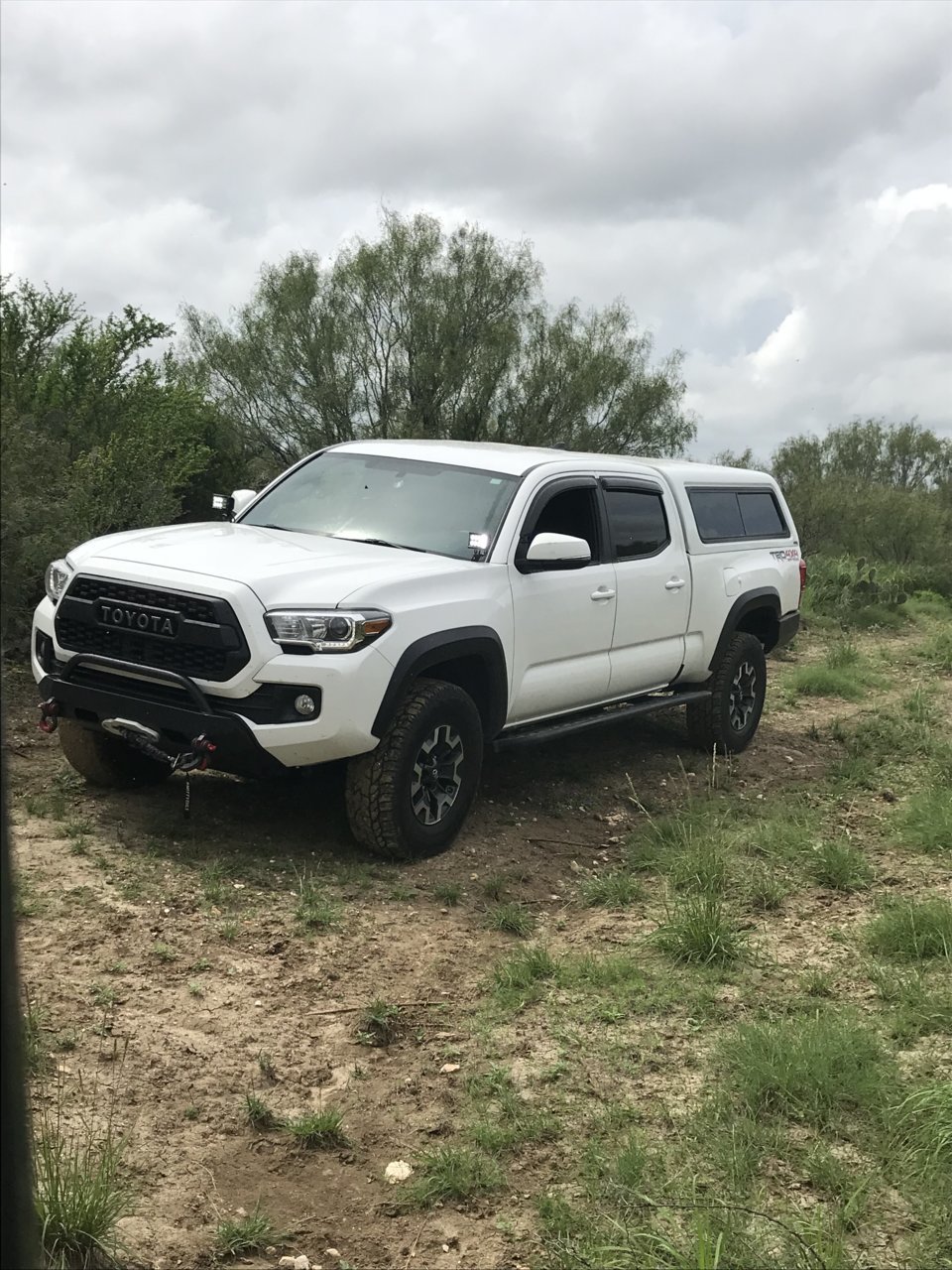

    The tracks are universal and super easy to install, measure twice, drill once! you will notice on the inside of your shell there is a reinforced area, use it and do not take for granted that it is square, many are not. Measure twice drill once!
    Also your front bumper and wench set up is clean as fuck! Which brand did you go with?

    Hey man, thanks for the info. I went with a southern style slimline bumper and a smittybuilt 12k synthetic line winch. I think it looks good. Look pretty slick with the new set up I’m running.

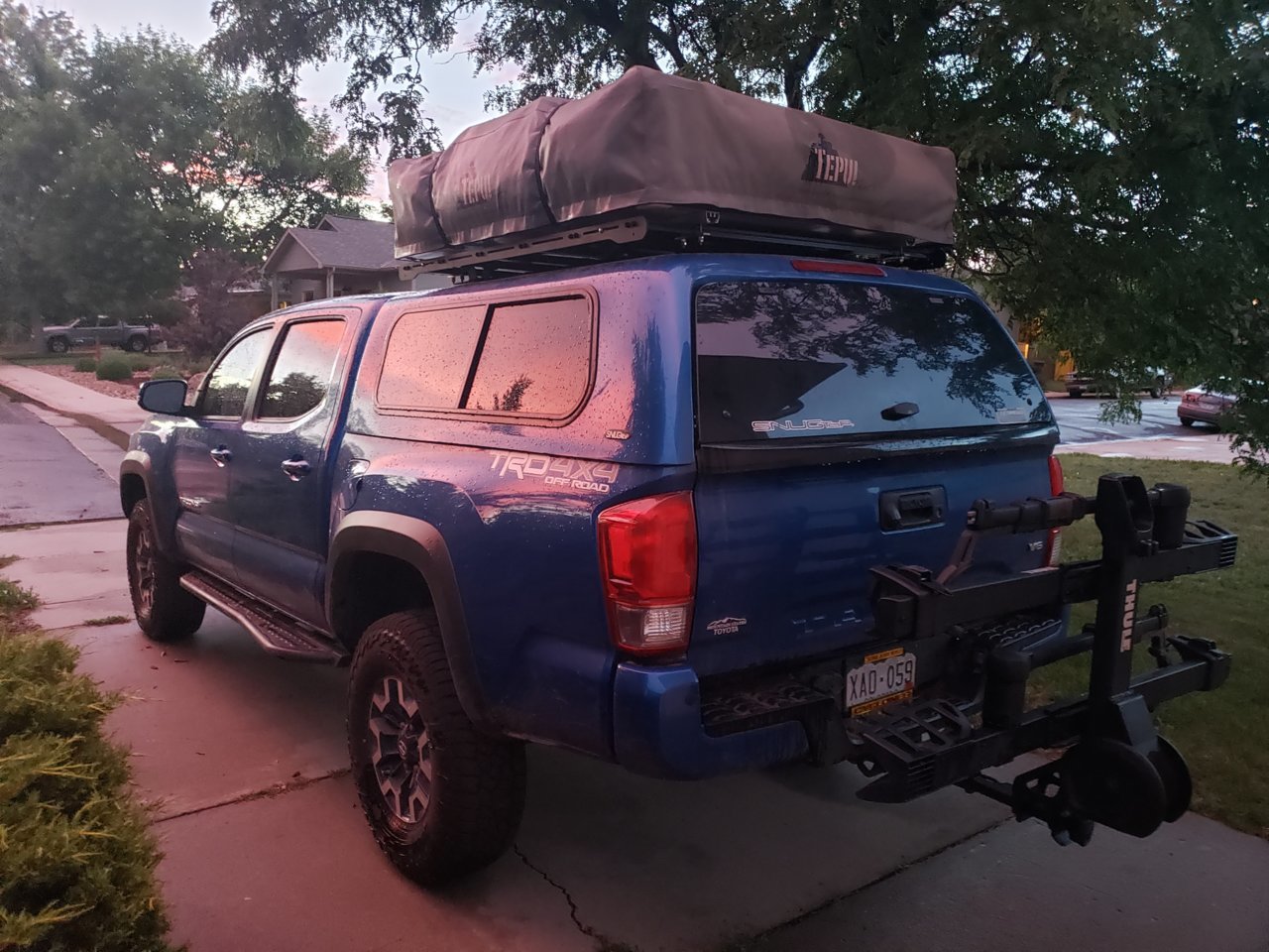

    I have a snugtop with sportsman package, prinsu rack, tepui tent, rago fab bed stiffners and dobinsons 2 in lift with heavy springs.
    Before the lift the suspension lost most of its travel. Te bed stiffners also really helped the feel off road. The high centered weight feels a lot better with the stiffners.
    Never really had any problems. Only regret so far is not getting the win doors on the topper. The RTT can also be quite noisy in high elevation, windy conditions. We have had a few pretty rough nights of sleep due to the wind. It probably wouldn't have been much better with a ground tent

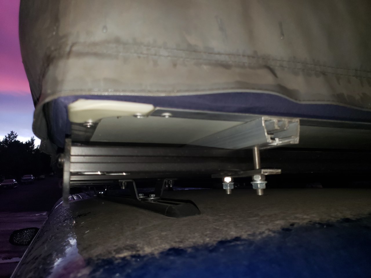

    Should also add that I remove the entire prinsu rack in the winter instead of ruining my knuckles trying to unbolt the tent from the rack.

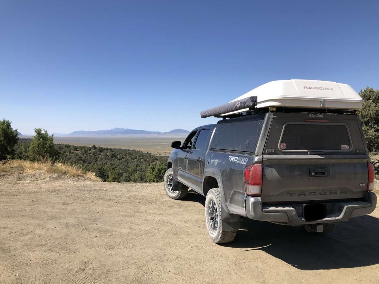

    You could go with an aluminum shell if you’re worried about strength of fiberglass. I have an Alucab canopy with a 150lb Autohome hardshell on top that I keep on full time. There’s also RLD which is all stainless. I think Camp King makes a metal shell too.
