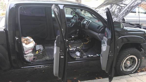

    This is some of the major items that I am currently installing in my truck. Mr Marv is currently fabricating me a box to fit behind my rear seat. My box is going to hold two JL Audio TW5v2 13.5" subwoofers. I am going to be unusual in the fact that I am also going to put my amplifiers, power distribution blocks & capacitors in a custom semi-sealed enclosure that I am placing in the foward part of my bed.

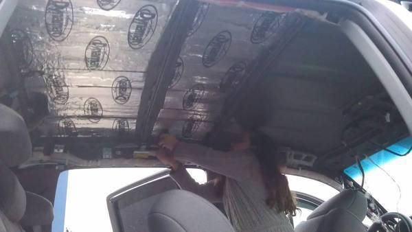

    A few days ago I decided to start linning most of my entire cab with Dynamat and my daughter decided that she wanted to help her daddy. She was helping me install on the ceiling. She helped with both the removal of the headliner, installing the dynamat and reinstalation of the headliner.
    So far my truck interior is gutted (other than the drivers & passenger seat) so I can layer Dynamat to the floor, back wall & all 4 doors (outer skin & inner door panel [not the plastic cosmetic panel]). So far i've gotten 6 small cuts on my finger tips and hands from the this alluminum backing but its encouraging to see progress. I have decided to reroute the factory amp, Audiocontrol LCQ-1 & Audiocontrol Matrix in the storage that normally sits under the rear seats.
    I am simply amazed on how easy these trucks are to work on and how easy my audio instalation in progressing. I know that my build will be slow, but I am trying to do everything as professionally as I can.

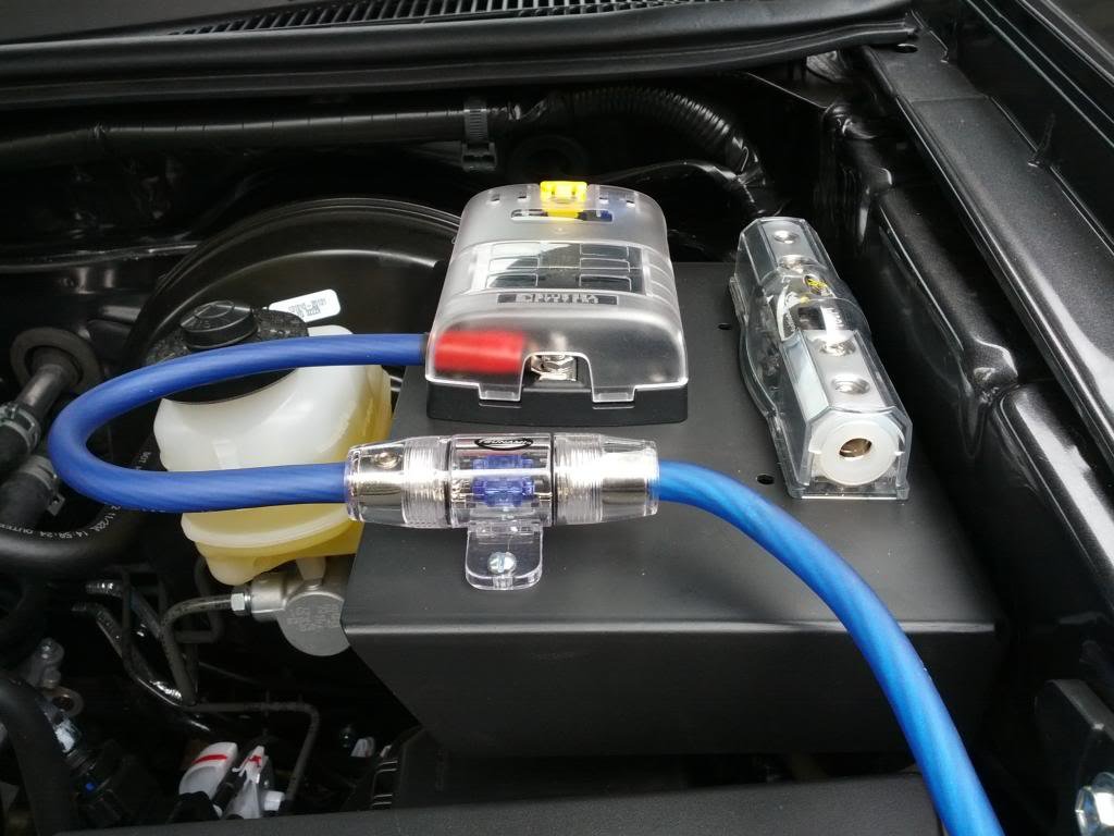

    i don't have a garage and it rained all weekend in Seattle so i did not make the progress i wanted to. i got the rear plastics out and cut a board to mount amps and such to as a temporary install until i order a custom box from Marv. i got everything screwed to the board (sorry no pics) but no wiring yet. i installed a mount for the anl fuse holder in the engine compartment:

    I like the sheetmetal shelf that you have, but what are the three components that you have mounted. I only build a small backet to bolt to the LH fender to mount my circuit breaker. I wll be running my power wire from my battery over to my CB, down inside my framerail then it will be routed all the way to my bed to my apmlifier rack/box. I dont have a garage either, so making progress is slow. we just had Sandy here on the east coast and its been over a week since i've gotten a chance to work on my truck.

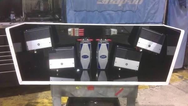

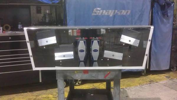

    Just finished building and wiring my amplifier box and I will be mounting in the bed of my truck this weekend. Planning to wire everything up next week. The only thing I am waiting on is my sub box from Mr Marc.
