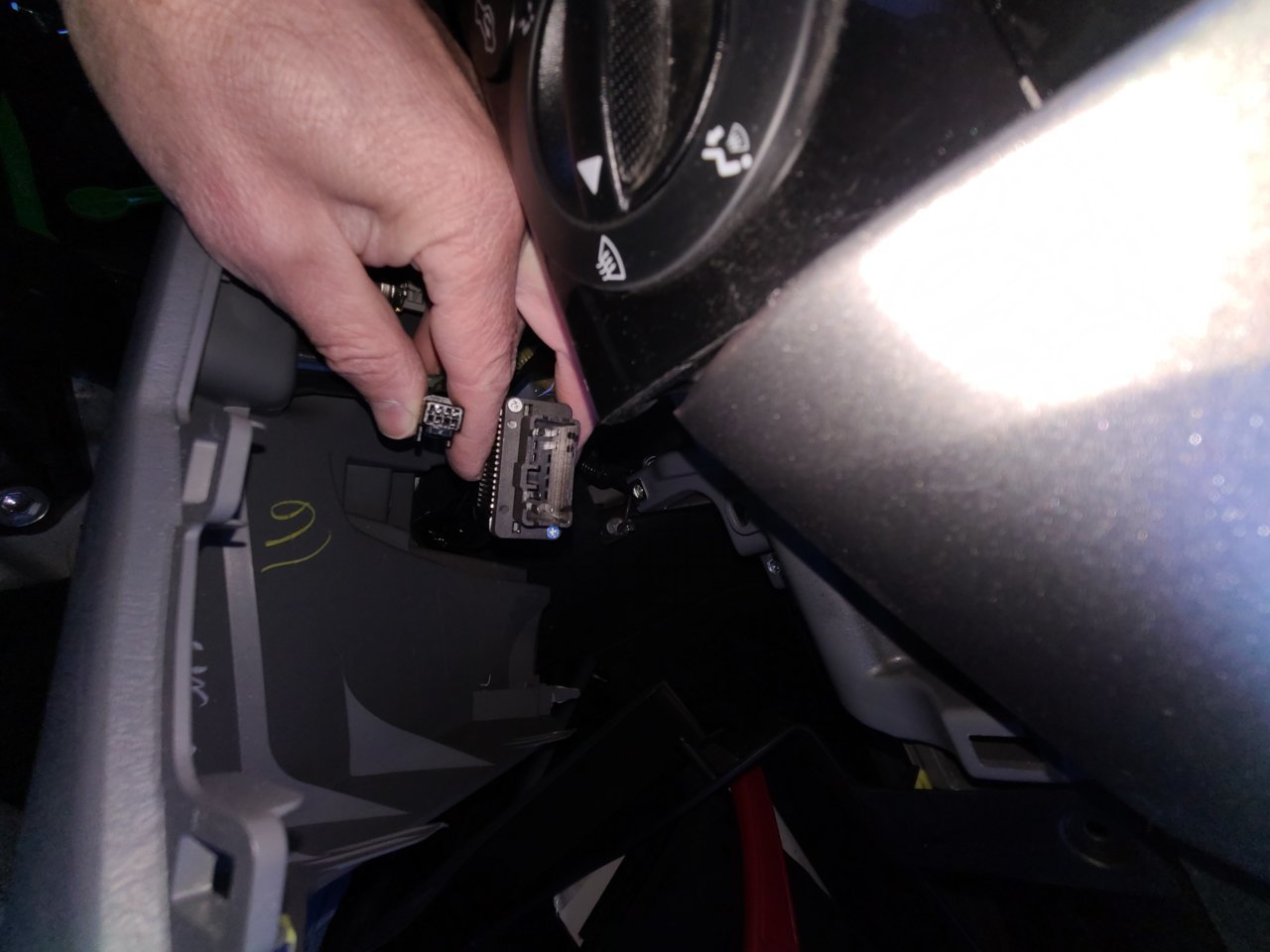

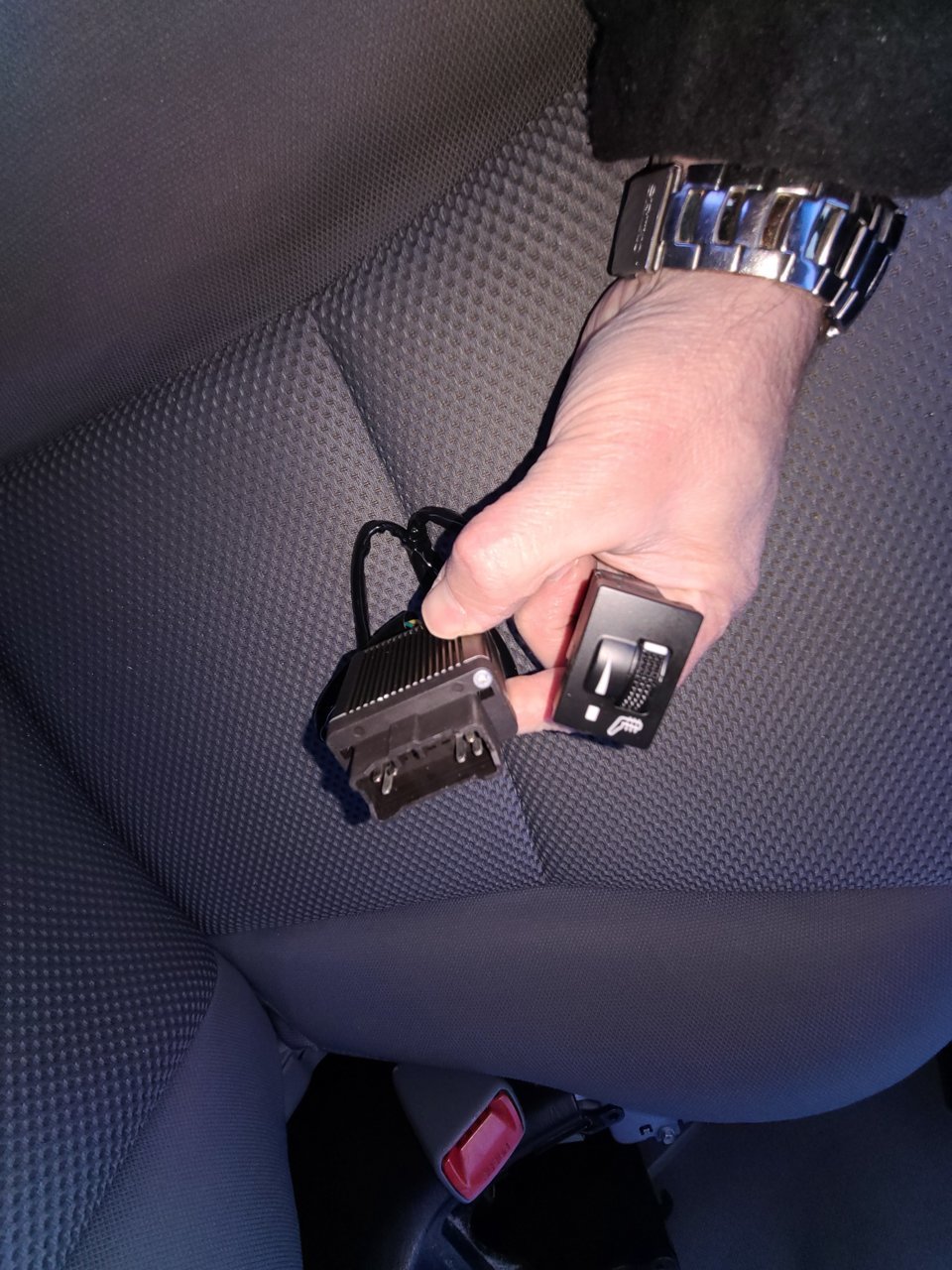

    I bought the eBay kit and installed it...or part of it. The wiring was easy, the seat fabric wasn't. Had to get a local interiors guy to fix and finish. The hog rings were my undoing.
    Here is the kit:
    http://www.ebay.com/itm/170710469601?item=170710469601&viewitem=&sspagename=ADME:X:eRTM:MOTORS:1123&vxp=mtr

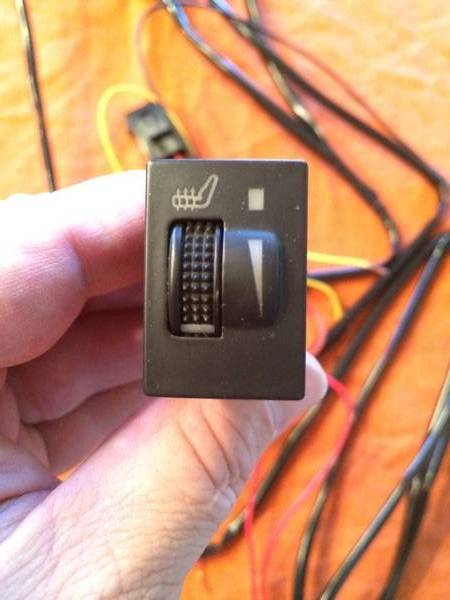

    Here are the switches:
    The only problem I have now is I tapped the interior lighting circuit at the gear shifter and the switches are lit backwards to the interior - off when the Interior is brightest and brightest when the interior is at lowest.

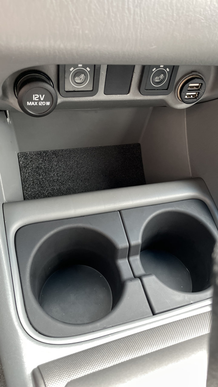

    Kansas City
    13 TRD Sport
    Clazzio covers and so they just go in between. I mounted the switches in the console.

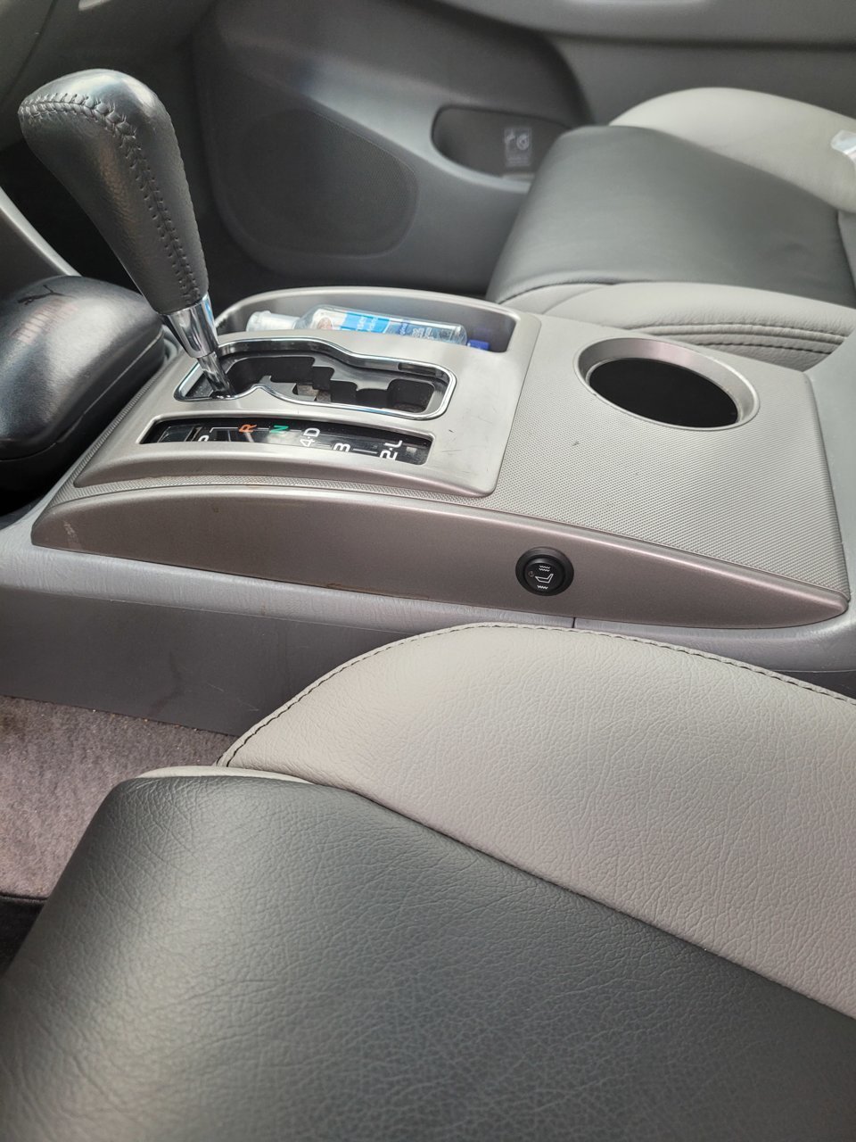

    2010 TRD Sport V6 Auto Double Cab MGM
    Not OEM, but out of the way and not super visable. Easy to find when driving. 20211226_120153.jpg
