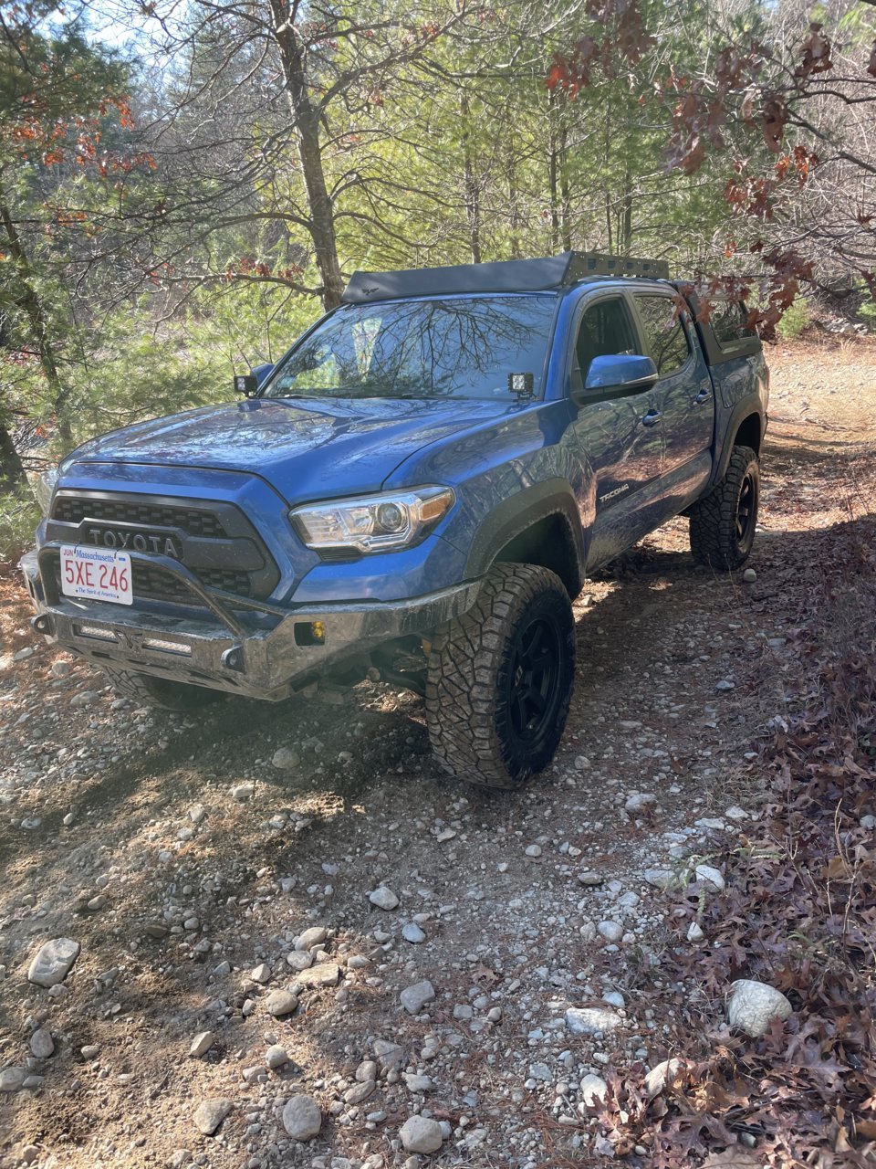

    Does anyone have a third GEN Tacoma with ome 886 coils up front? Please post pics. I have 888s but there sagging with my metal bumper. So next week I have coming 886s with 1/4 inch spacers up front. Should bring me back up to level with the rear!!!
    So post your pics with 886s please thanks

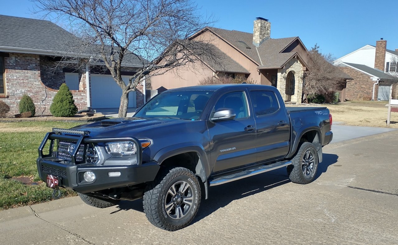

    I just finished mine today. 886's up front, Dakar's in the back with Ride-Rite air bags. Mine was sagging pretty badly.

    Are those stock size tires? Trucks looks amazing especially with that front bumper. Did you put any spacers with the 886 coil’s or just the 886 coil’s by themselves? Thank you

    Thanks, not stock, 265/70/17. I had Headstrong assemble the 886's with the NitroCharger struts and the trim packer on the driver's side. No spacers. Shout out to Headstrong Offroad. Man those folks are great. I was a little embarrassed to post a pic, truck is filthy right now.

    Mine actually came up over 3" but I am sure it will drop back down some. That bumper was on there shortly after the truck was purchased from the dealership so the stock springs had to be compressed pretty badly. Those bumpers are really heavy. The "Sport" shocks from the factory are aweful too. It rides so much better and doesn't get squirrely over bumps like it did.
    You should definitely see the lift you are wanting.

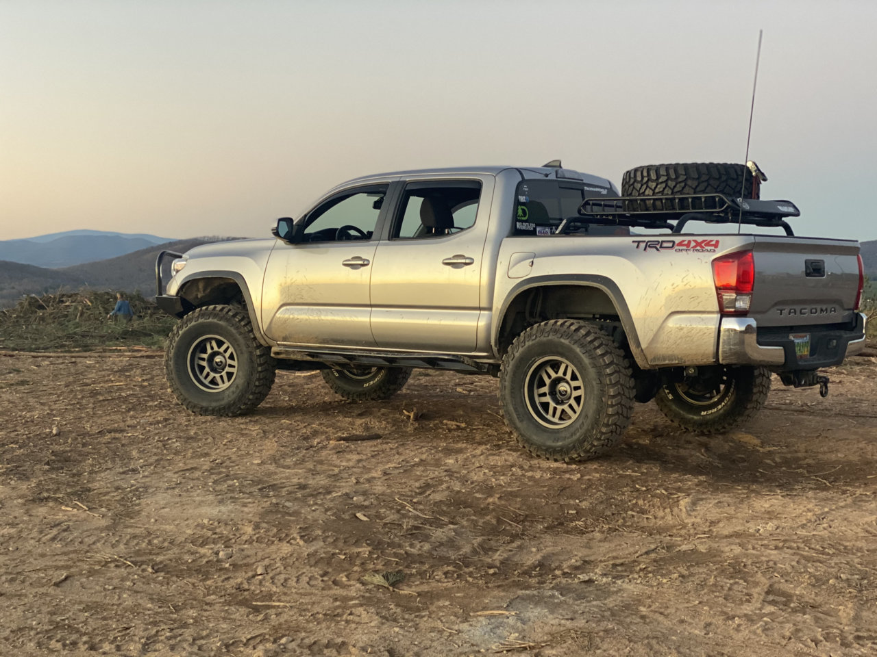

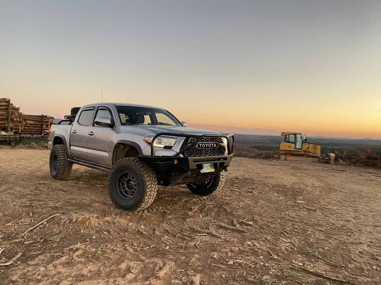

    OME Suspension 886 coils SPC UCA’s Dakar leaf pack SCS stealth 6 35” STT Pros Relentless fab bed bars Relentless Front Bumper Baja Designs Fogs Relentless Ditch, hi lift, quick fist mounts. Alpine Designs Cab mount relocation ARB on board air ARB front locker ECGS assembled 5.29 gears Mobtown weld on sliders Mobtown Front skid Mobtown transmission skid Mobtown t-case skid Exhaust re-route Midland GMRS President CB

    Thank you, your truck looks awesome. Do you have any spacers with the 886 or just the coil‘s?? Seems like you got a really good height

    Truck looks huge in the front.

    I have a 1/4” spacer on drivers side.

    thank you, how are your CV angles? I have a front bumper with 888 and it’s sagging so I’m putting the 886 with the 1/4 spaces in the front and driver side. So hopefully it brings it back to high

    They aren’t extreme at all.. my bumper is a heavy mother.. so it works out nicely with the heavy springs and single plate spacer.

    Awesome, thank you so much. I can’t wait to get the heavier springs on so at least my truck will get back to the hight I want to on the front. I have a victory 4x4 bumper

    It will definitely fix the sag. My bumper is heavier than yours, I’m sure, so I would try without the spacers first, and see where it sits.
