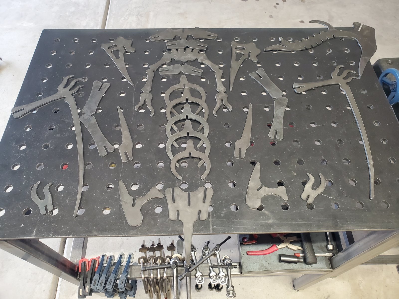

    Cool! Which aluminum alloy and your cutting amp, ipm? 6061 at .100? Guessing you ran compressor/air?
    I have a 4' sheet of .25 6061 that I've been saving for a hybrid bumper and have been wanting to experiment. At $22 a sq ft I'm not looking forward to the wasteful experimentation to dial it in. I've torched some .90 6061 and the backside dross was ugly! I do have a tank of argon and thought about experimenting with feeding the Titanium 45a.. but again.. gonna be costly experimentation.

    304 stainless steel ;)
    It's scrap I had left over I wanted to get rid of as the real carrier will be out of aluminum
    16 gauge, 33 amps, 110 ipm, and yes just cut it over air
    My aluminum actually cuts cleaner than this stainless steel did

    Nice man. Hoping you share your aluminum cutting stuff with a close up on the edge.
    After my experience with the jagged aluminum backsides i'm preparing for slightly oversizing the parts and extra labor time of cleaning them up.

    @Gen3TacomaOBX my second time cutting aluminum

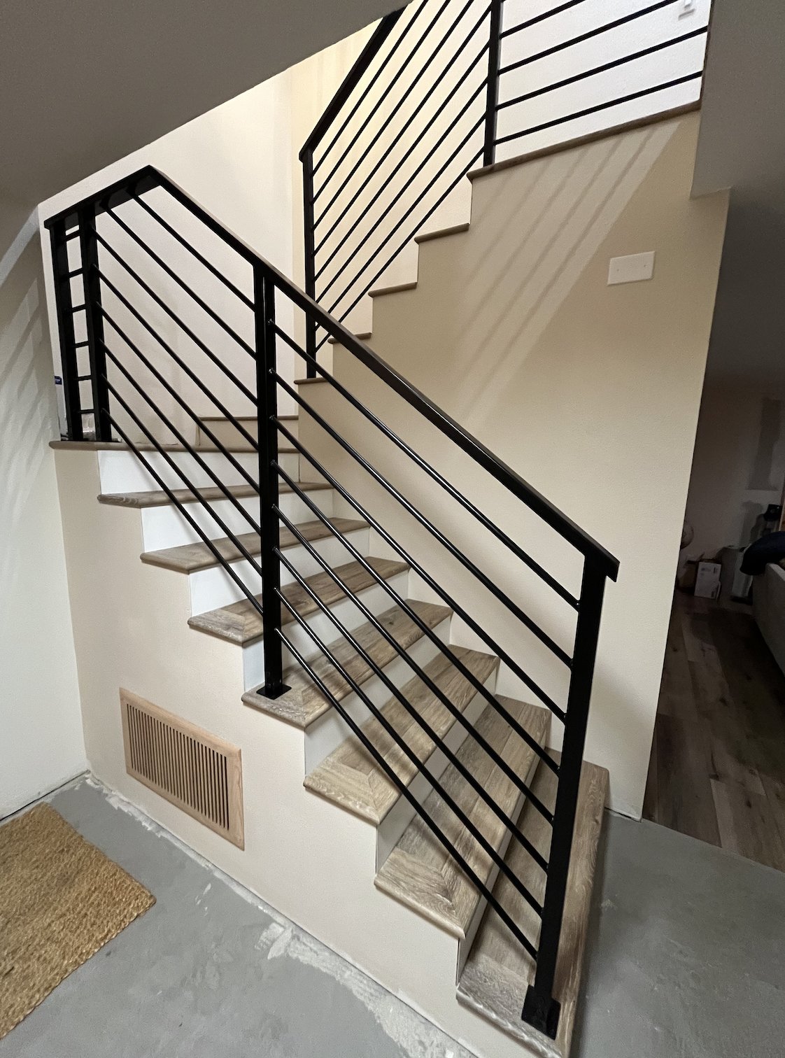

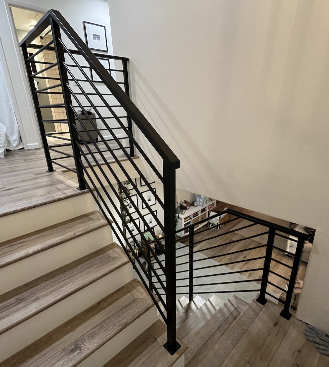

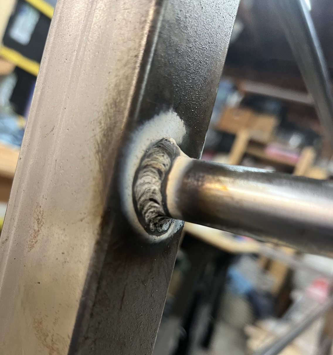

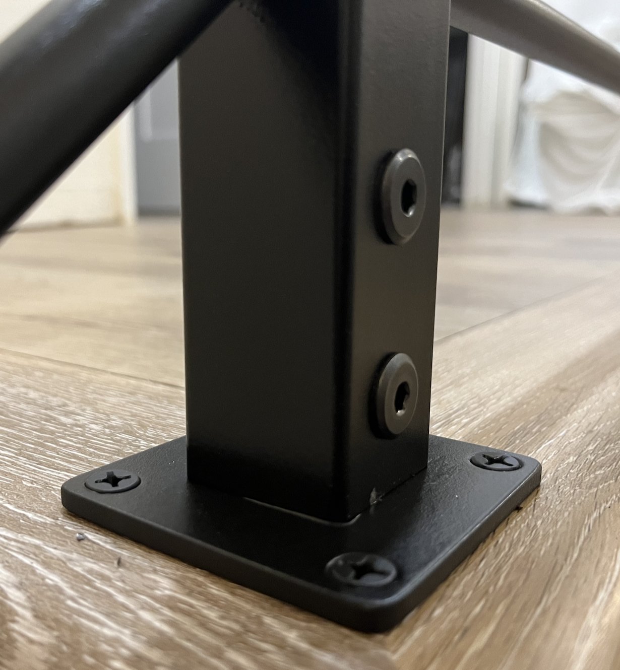

    As a follow up to this post, here is the final product:

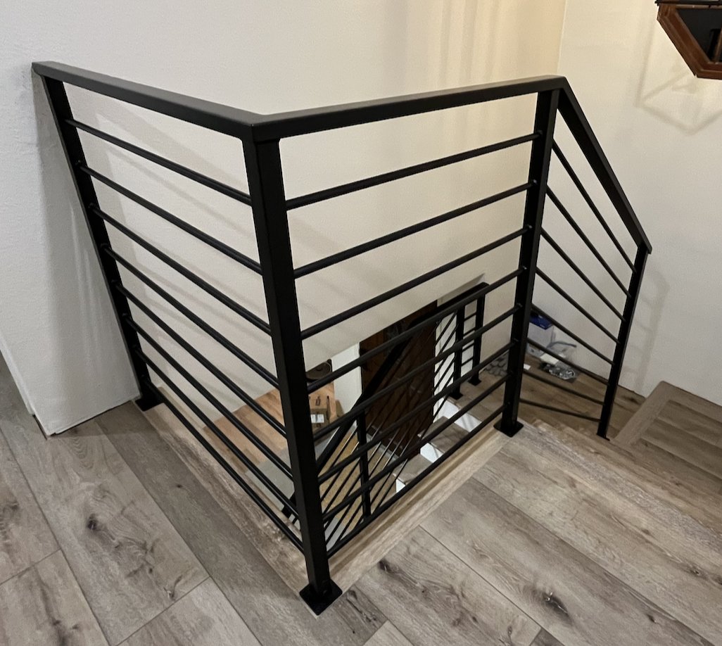

    Some of the welds even looked alright:
    Overall, a 100% success. Railings are easily removable for when we need to move large items (beds, couches, etc) up and down the stairs. They are rock solid, and they look a TON better than what was there originally.
    Only thing I'd really do differently, is go back in time :rofl: and make the hand rails first, so I could install the base plates under the lvp...
    @Kwikvette I didn't even mess any of the metal up :burp:

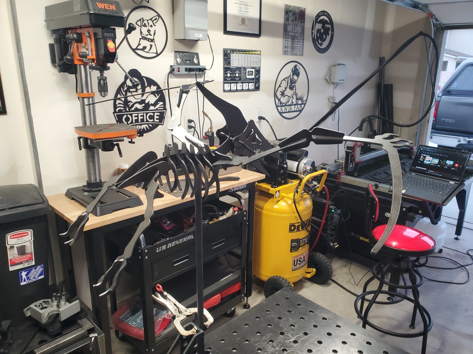

    Because why not
    Temporary stand; I'll need to cut the rod down a bit then weld it to a thick base
    The top is notched and heat treated
