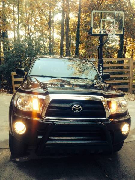

    Thank you for your reply - both DRL and Fog Lights do work.

    2006 PreRunner SR5 TRD
