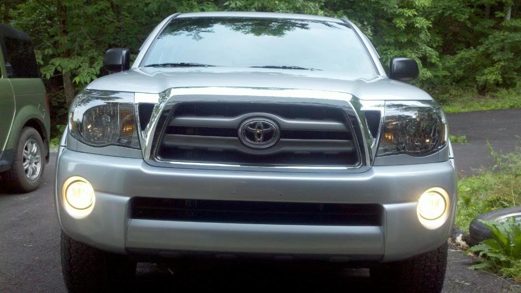

    I used the Caribe makaira's method listed at the beginning along with some added tips from Jasonleblond. Not as hard as it looks and very clean. No splice, just move one wire.

    Which of these methods doesn't cause the fogs to come on (for only a few seconds) a few hours after the vehicle is switched off?

    I've had this done for over a year now, and I've never noticed them come on on their own. I think I may have read on here sometime back that some were tapping into the wrong green wire.

    ^^^correct, I did it that way with my own twist and have never had the lights come on either.

    Caribe's method does this. Because of the EFI circuit. See below.
    Years ago when this mod was first being done, modders were tapping into the emissions circuit. Well it turns out that the emissions system initiates a system check 4-5 hours after the truck has turned off to check for leaks in the fuel system or something. Read about it in your owners manual.
    Use the splice method or Jivewalkers to avoid the EFI circuit.

    But people have reported this happening with Caribe's method.

    I was wrong. You are right. Carbie's method does in fact tap into the EFI circuit. I just found that out. I updated the 1st post in this thread to warn people of that. The problem with this is that the EFI circuit does an emissions leak test about 4 hours after the truck is turned off. This of course has the unintended side effect of making the fogs come on at night for most people. Some will tell you if you do this to switch off the fog light using the in cab switch each time you turn off your truck. That is one possible solution.
    I personally don't like the idea of tapping into the EFI circuit at all. I am (one day) going to use Jivewalker's method for the spade connector. He sent me a wire a long time ago and I need to find it, and reverse my splice. :eek:
