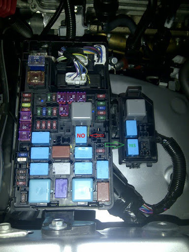

    If you have the fog light relay located in the sub panel to the right... Run the wire from relay through bottom of little panel box > then straight through bottom of main panel box > then straight into LIGHT GREEN ignition power cord.... You don't need to splice... Just get small slender shape terminal to fit into harness... I forgot wut those little y shaped terminals are called, but I cut one side off so it looked as if it were a single prong terminal... Someone else did it and posted pics but I can't recall who... Good luck!
    *this allows you to use fog lights anytime... W/ or w/o any other lights -dl, pl, low, high... Fogs work independently..

    I think in the '12's the fog light relay moved to the small panel & before it is in the large panel. I think it should work its just that the relays are in different places.

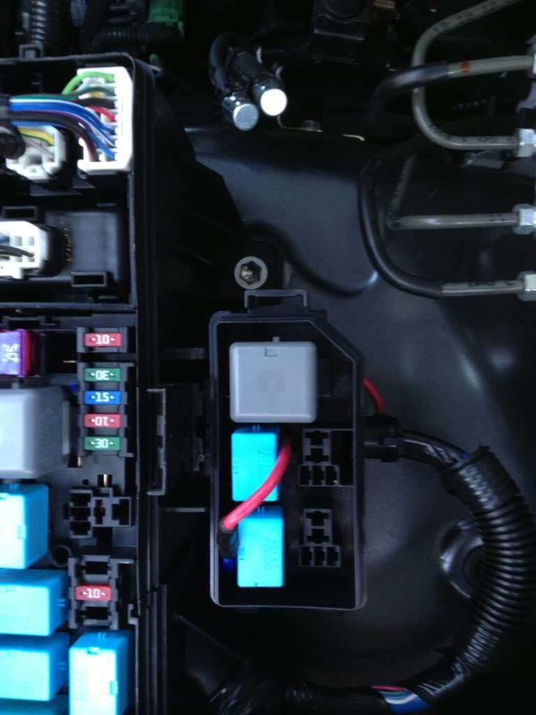

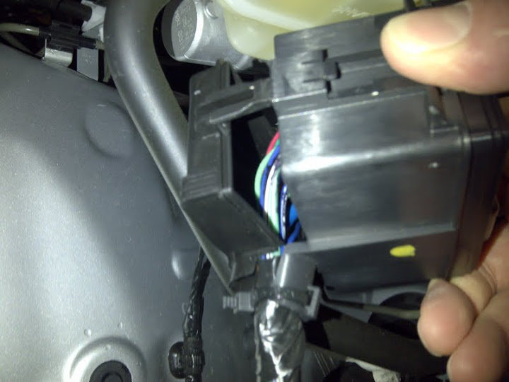

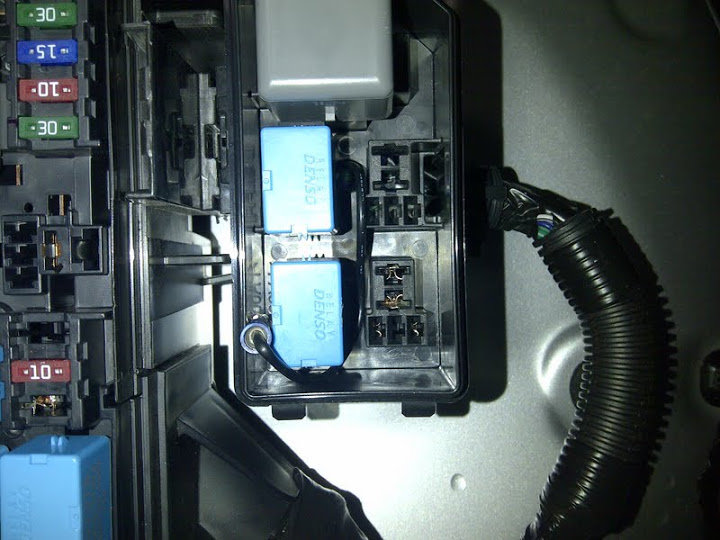

    I did this mod today, JohnnyE style and it works great, no problems.
    Main,
    27DED6E3-647F-49AB-AAD9-7E084ABA833A-301_80553791d8ce6eef66f15085f3dd43473c3adbb7.jpg
    Fog Relay
    4B98D653-C925-4AC5-8F18-45C70119F8FF-301_a06c883fedbe895f749db4b4d28845014b8f479e.jpg
    Wires goes under secondary box and again under main box and follows the rest of the wires back up.
