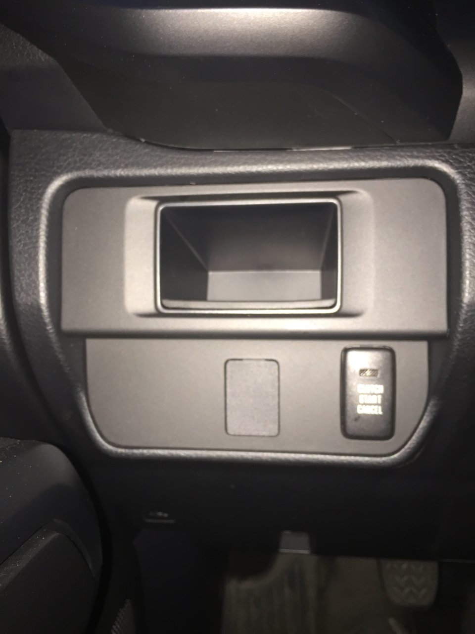

    It won't fit from outside in OEM spare opening, because outside dimensions 49mm x 23mm AB switch and OEM outside dimensions 39mm x 21mm.
    It would be too tight on top. May be in some other places.

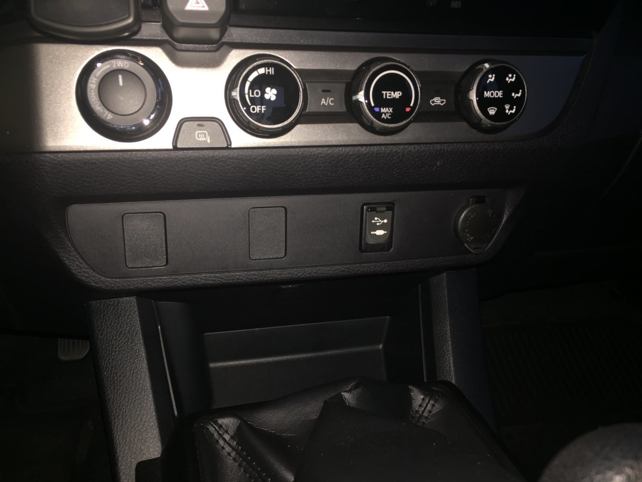

    Here is the display/switch panel on the SR, just to show the difference. I would personally mount the switches in the center right next to the gear shift.

    When you order a kit, just select the "Center" size switches. They will fit the blanks that you have.
