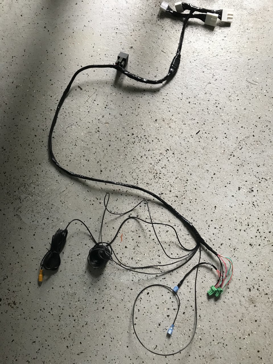

  7. May 17, 2018 at 2:07 PM
    #327
    SWPRO
    SWPRO Well-Known Member
    Oct 5, 2017
    #232134
    157
    Jeff
    Rindge NH
    '17 Super White TRD PRO

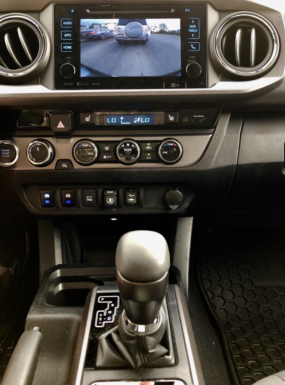

    My harness is all soldere and taped. Added a wire for a nav cut out switch. Have my front camera power and rca, ground, illumination power, ready to go in. Will update on progress.
    Thanks JJ!!!!

  9. May 17, 2018 at 2:09 PM
    #329
    SWPRO
    Oct 5, 2017
    #232134
    157
    Jeff
    Rindge NH
    Forgot the pic

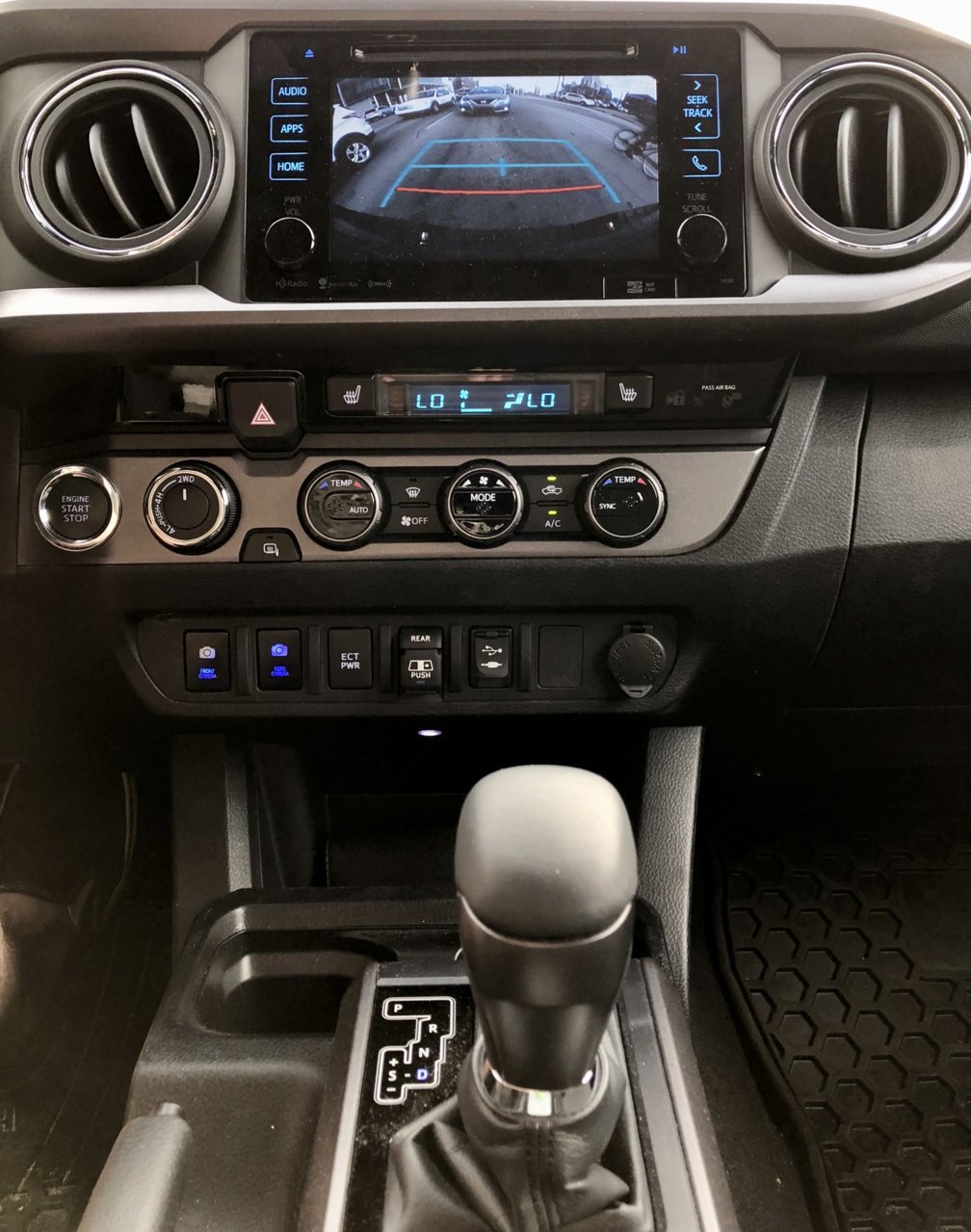

  12. May 17, 2018 at 6:45 PM
    #332
    SWPRO
    Oct 5, 2017
    #232134
    157
    Jeff
    Rindge NH
    Got the switches in, I asked JJ to make a semi-custom (custom in that e do two holes and leave the third blank) to do a knob for my amp/sub, still looking for the right switch for above the knob for the nav override. Looking for a semi-flush black switch so it blends in.

    For the nav override, just use a basic SPST toggle switch. I'd recommend either a metal toggle switch (with just the toggle exposed) or the red button toggle.

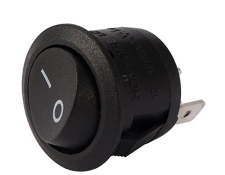

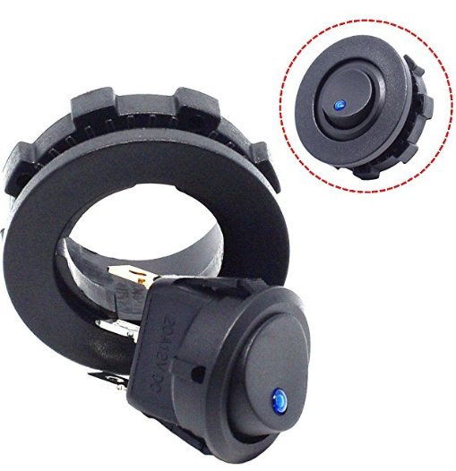

    Here are a couple of near flush switches. These are available on Amazon . Search for SPST switch
    upload_2018-5-17_22-10-59.jpg upload_2018-5-17_22-12-32.jpg upload_2018-5-17_22-14-5.jpg

    Those blue lit switches might match the Gen 3 interior lights.

    Thanks, that first one is perfect IMO, the blue matches 3rd gen lights and for only $9 it looks like a winner.
    I'll surely be doing this mod F&R with front camera plus the switch. IU'm glad to see the OP made the mod plug and play now!

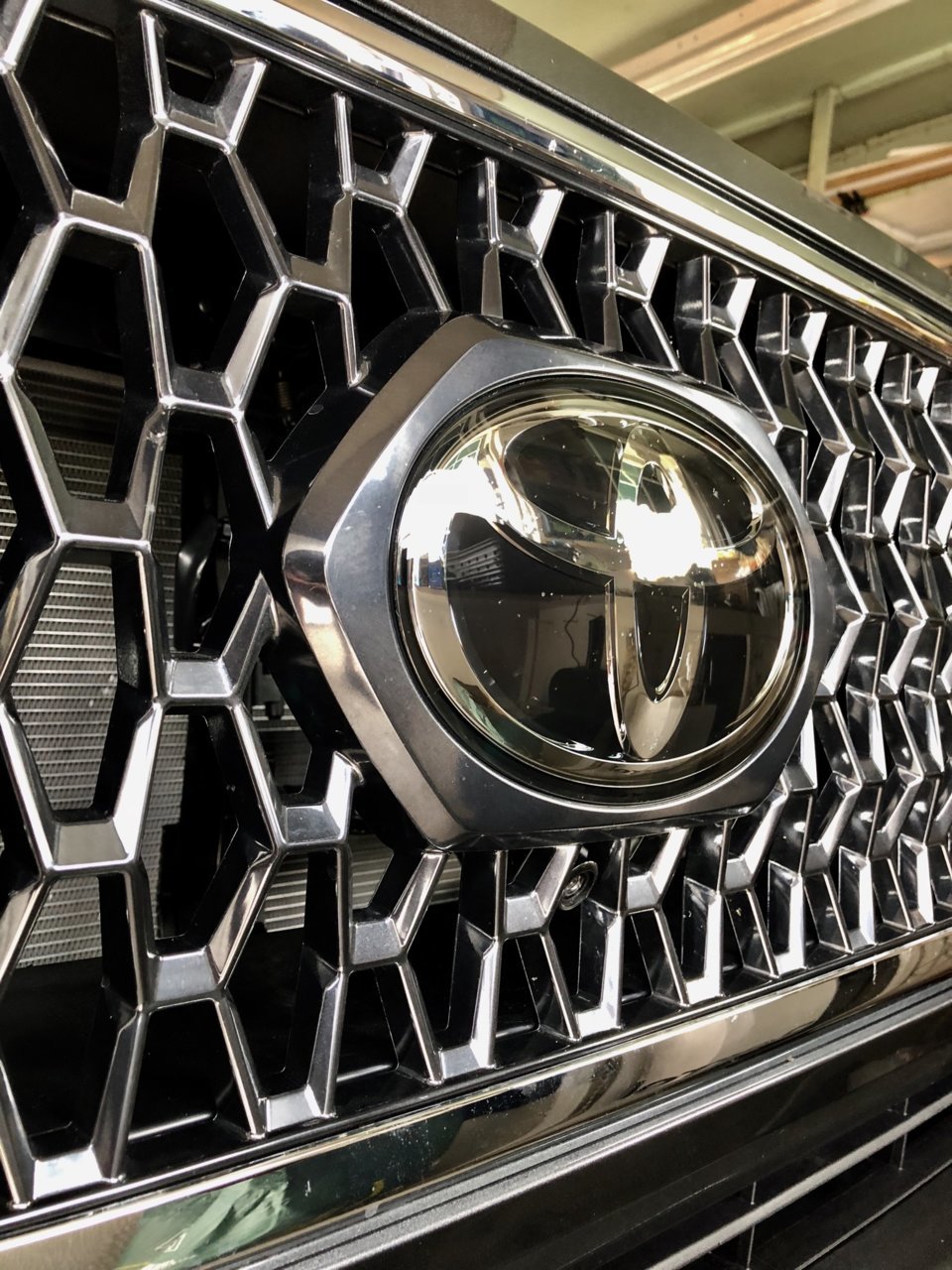

  18. May 18, 2018 at 6:05 AM
    #338
    ACEkraut
    ACEkraut Well-Known Member
    May 11, 2014
    #129627
    4,581
    Aaron
    Durham, Maine
    2014 DCSB TRD Off Road
    Has anyone seen a switch like the one pictured above by @jerzsubbie but that you can wire into the truck illumination lights so it can be see at night and will also still light up when switched on?
  19. May 18, 2018 at 3:02 PM
    #339
    SWPRO
    Oct 5, 2017
    #232134
    157
    Jeff
    Rindge NH

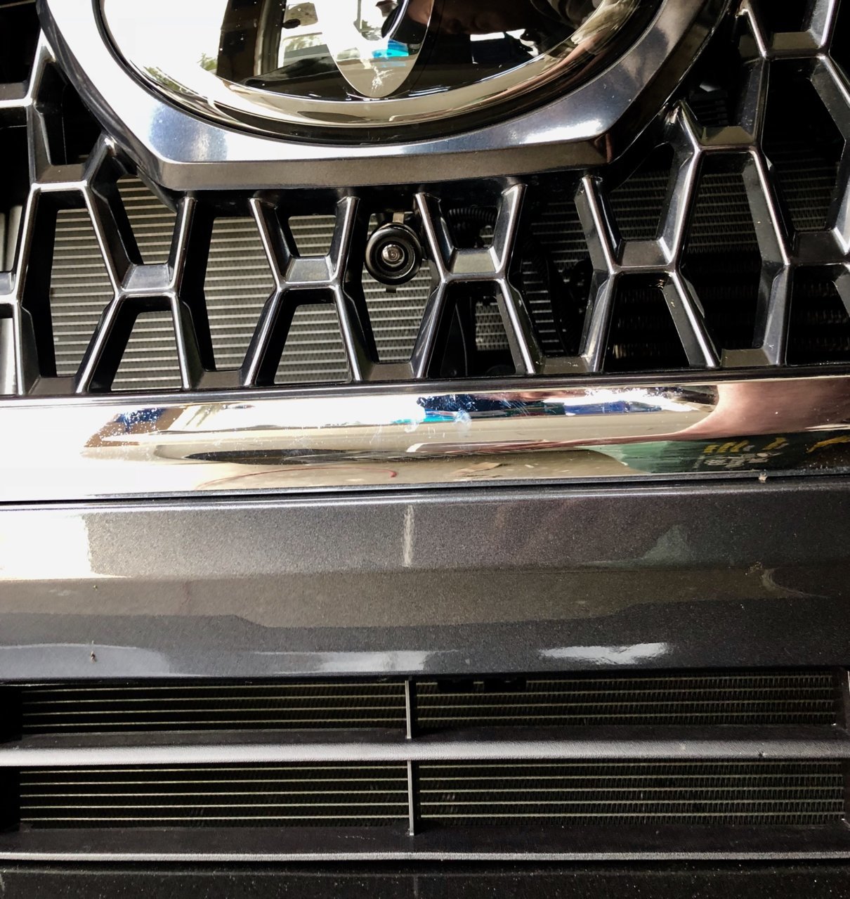

    All done. Some may not like it. For me this is exactly what I wanted. Didn’t want to ruin anything I couldn’t put back to stock. Ruined a $60 piece that was hard drilling through, but I can go back to stock. My main purpose is to have this for parking, wanted to see the tip of the front bumper.

    Looks good man. And as long as you like it, that’s all that matters.
