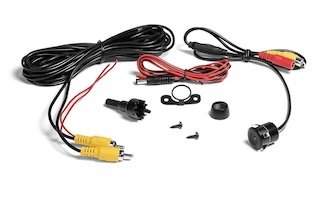

    Here you go.

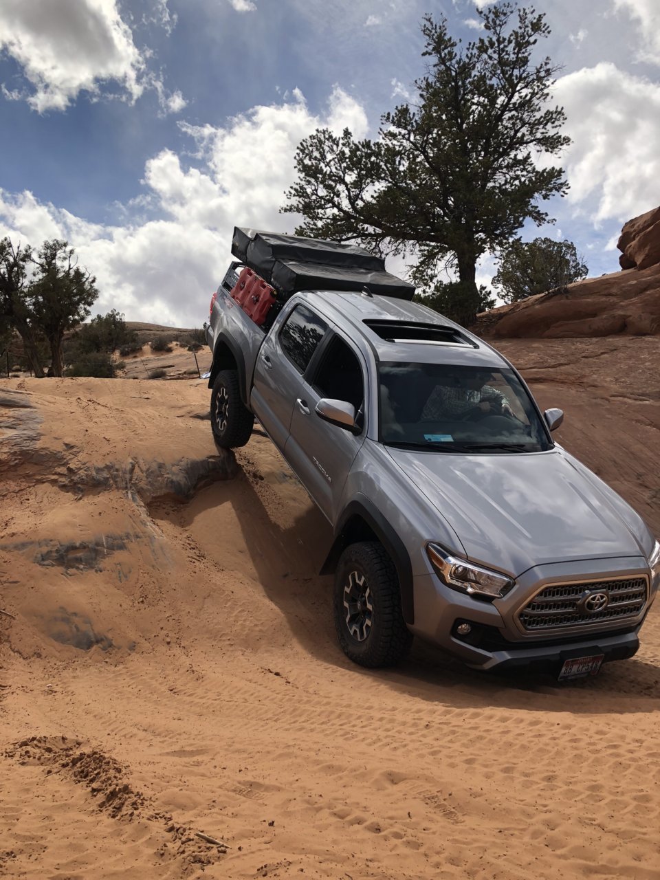

    Just placed an order for front and rear. The hood of these trucks are huge to look over while going over obstacles. Spent a week in Moab having lots of fun. The passenger seat is worn out from constantly getting out to spot the trail. Hopefully this works. To anyone: can you share a photo or description of where you might recommend mounting the front camera on a stock front end. My concern is below plowing a little sand with the bumper and the damaging a camera mounted low to look ahead. Thank you!27C4BDB6-9373-4A7F-9653-EB8B27BDFB05.jpg

    With your grill, I would mount the camera inside of the Toyota Emblem. Once you get your kit, I recommend turning the front camera on and having someone in front moving the camera to get the view that you want.

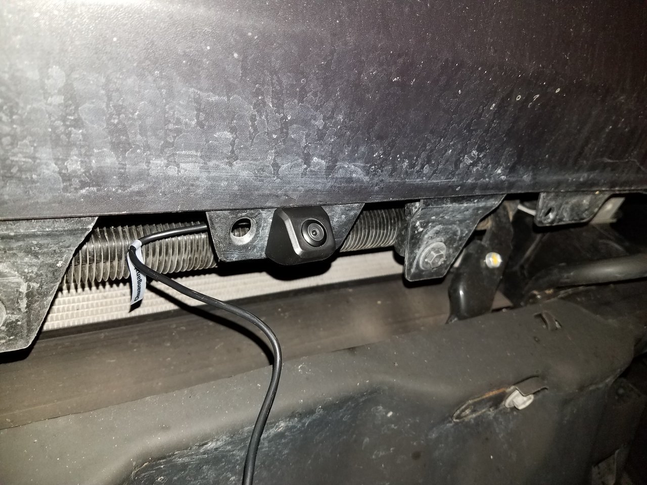

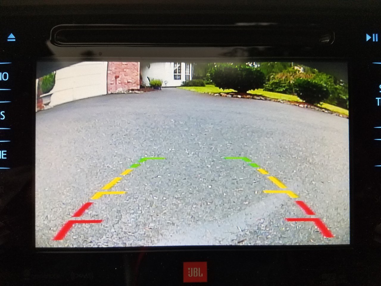

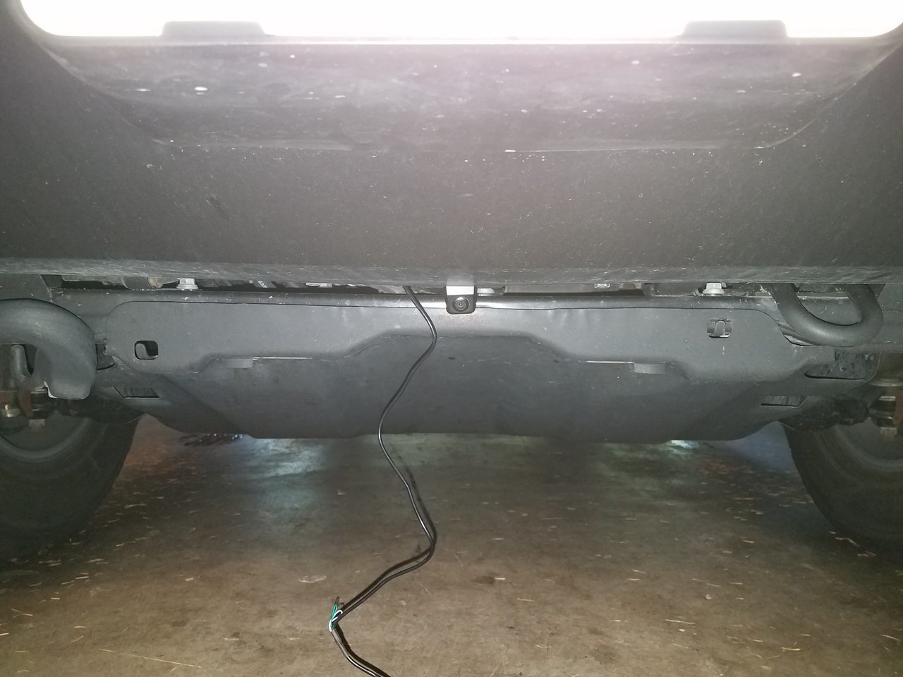

    Here's where I mounted my camera and the screen image. In this configuration I can see the bottom front edges of the license plate holder on the top outer corners of the screen. The red lines perfectly mark where the front of the license plate bracket it's.
    This camera:
    https://www.amazon.com/dp/B00RD05MOO?psc=1&ref=yo_pop_mb_pd
    I took it apart and potted the whole thing with silicone. So far so good with plenty or rain, puddles, and mountain passes. I had to cut the green wire to reverse the mirror function.

    I like this mounting location.
