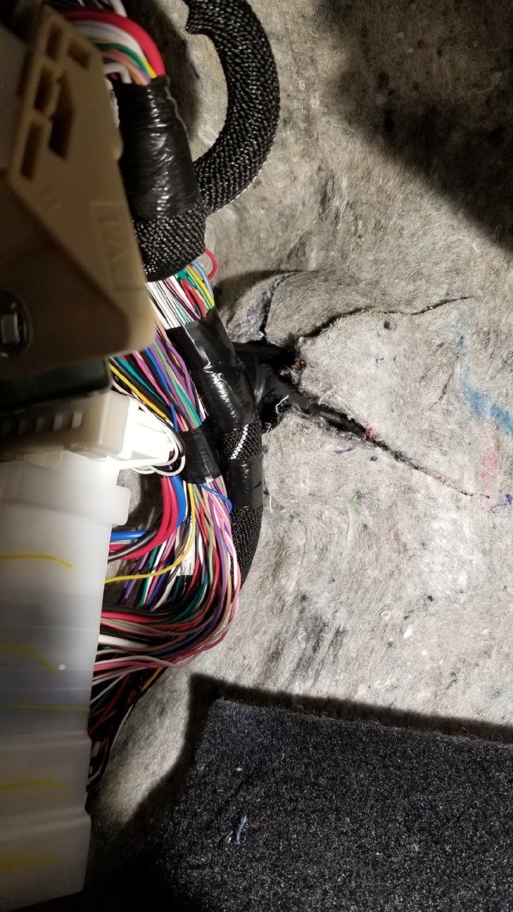

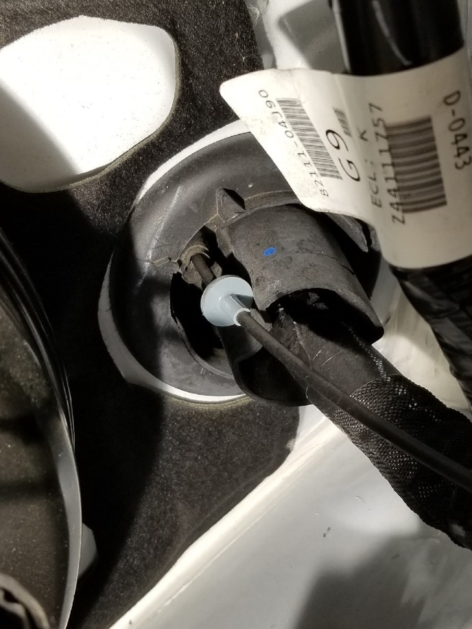

    Driver side, there is a firewall grommet. Then I use a wire hanger to push/pull wires through.

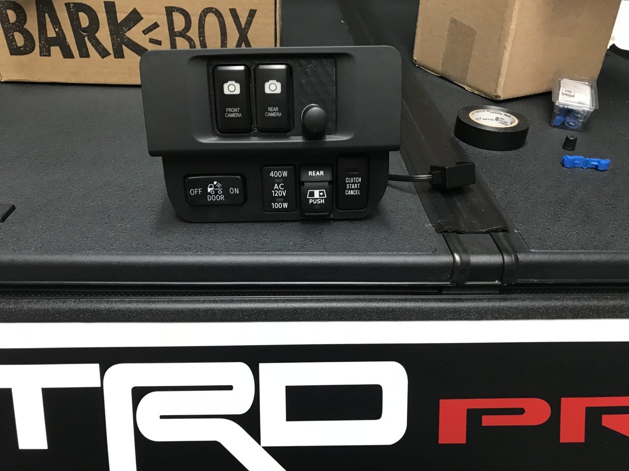

    What is the nav override for? is it necessary for this mod? so for the front and reverse anytime camera you need 3 switches? or just two

    You only need 2 switches, unless of course you decide to go with a single toggle/rocker style switch. Which some people in the thread have done.
    The nav override allows you to input destination information, and other normally locked out items, while the vehicle is in motion.

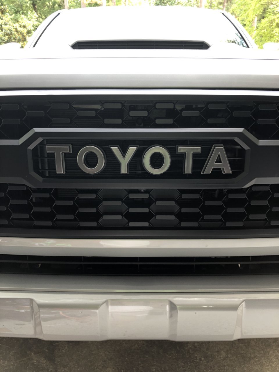

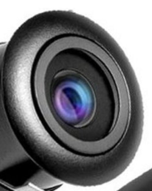

    i finished installing my front/rear camera mod today . Thanks to JJ for the help via email!
    I bought a 180 degree Parkvision multiview camera from Amazon and mounted it into my trd pro grill by cutting a small square hole for it and glueing it in place. I like the camera a lot, the top down view is really nice and all of the guiding lines can be fully adjusted or disabled. It has 6 display modes in total and you can disable any of the ones you dont want when you cycle through the modes with the control button (mounted near my camera buttons)

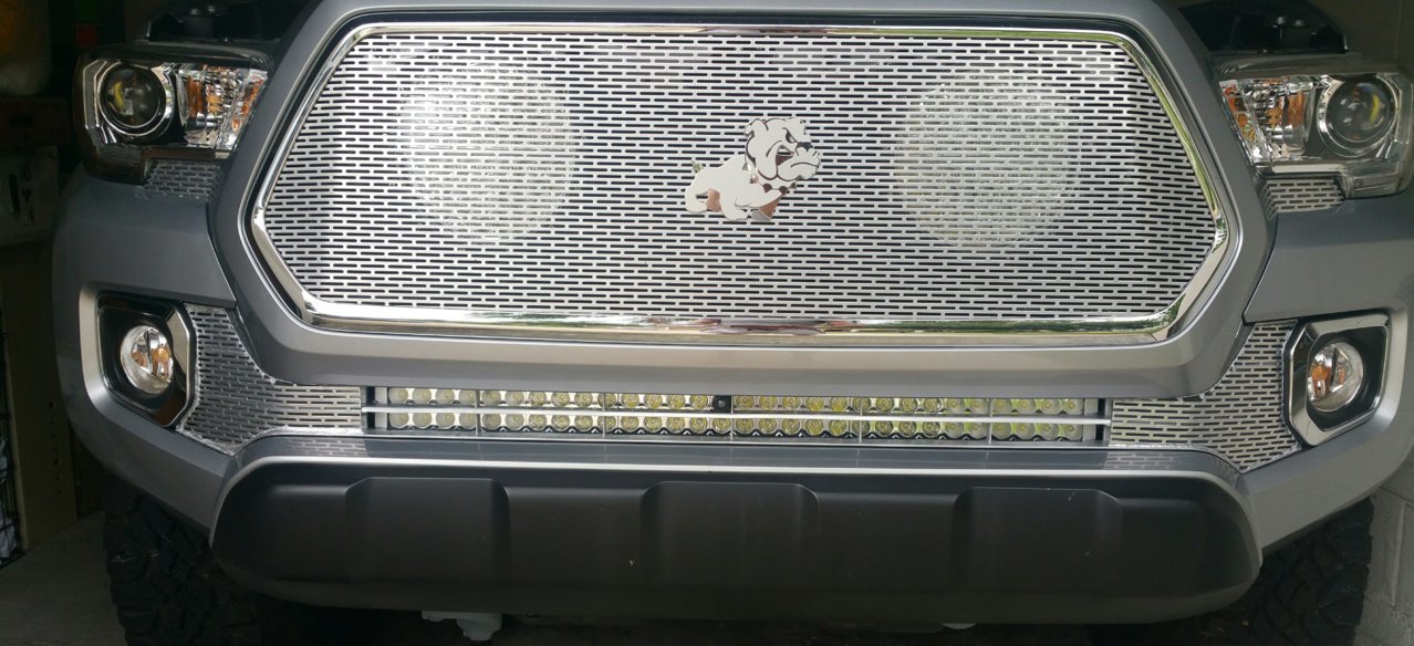

    Anyone else have photos of where they mounted their front camera?
    My radio is being replaced by toyota this week then i will be installing. Just trying to figure out if i want to mount the front camera in the grill or under the front bumper

    It looks like you have the TRD Pro grill. I know there are a few posts throughout the thread of people that have posted pictures of the camera mounted to that grill. I want to say @SWPRO posted one where he mounted it on the grill's garnish piece.

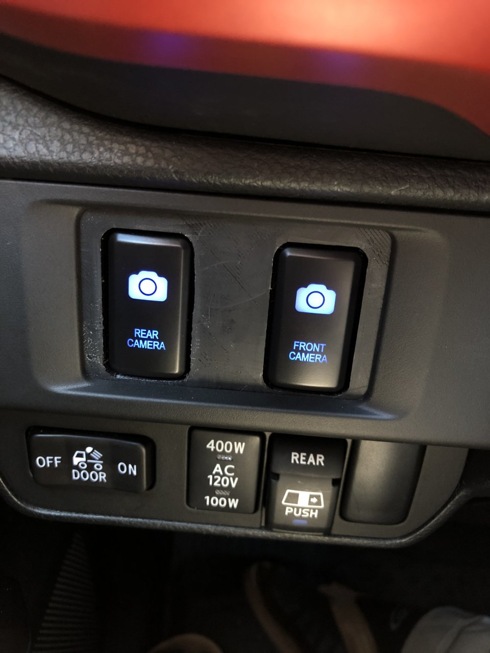

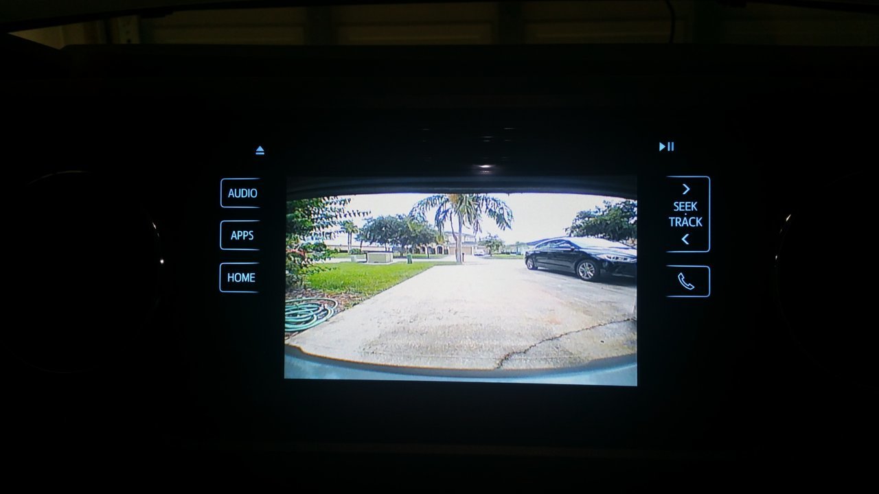

    Lots of Interior and Exterior mods to tell.
    Install, Anytime Front and Rear Camera Mod, update for my Tacoma.
    order from,
    /trdmod.com
    order install one switch to control front & rear cam individually, On/Off/On Rectangle Rocker Switch 3 Position Car Dashboard.
