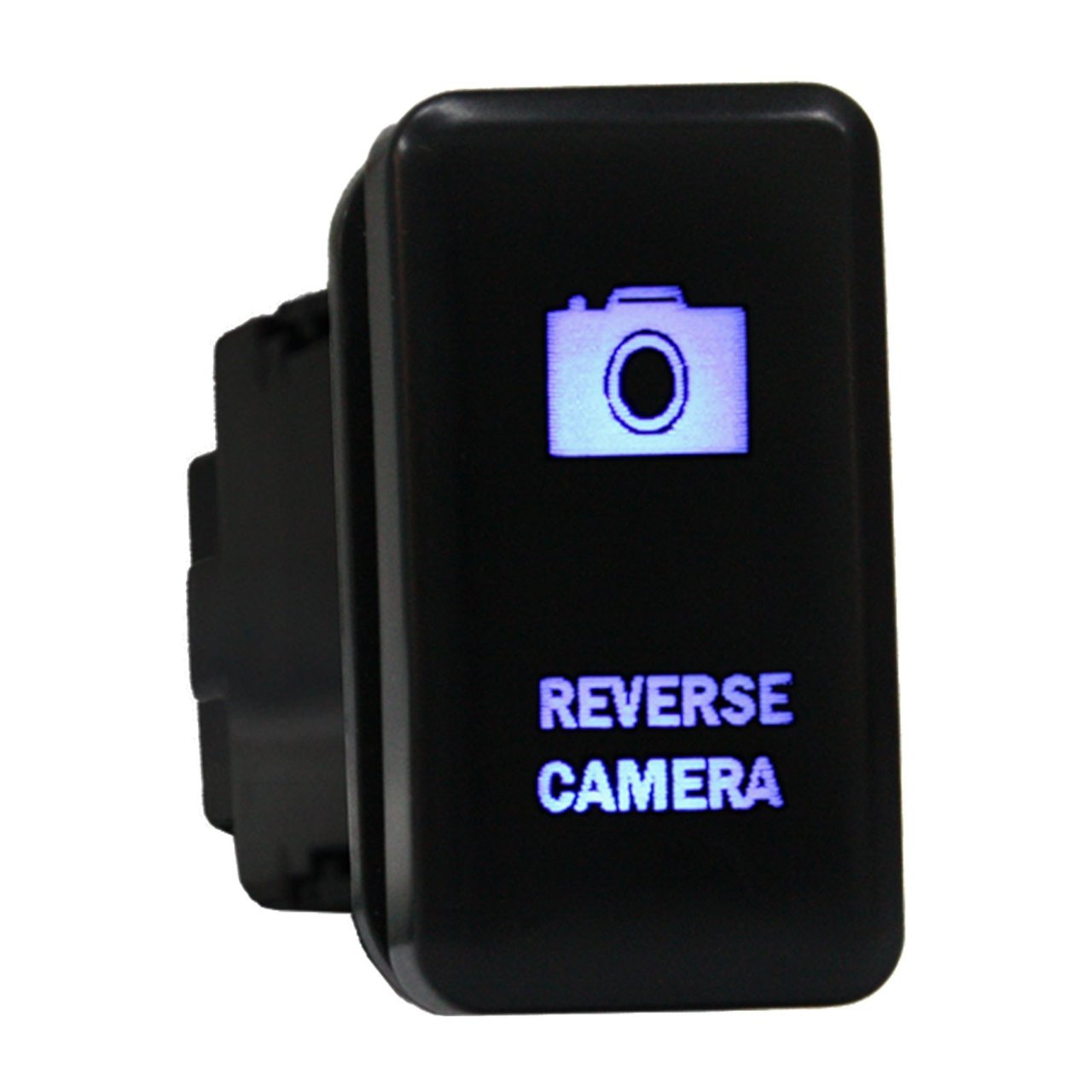

    Anyone know where to get an Oem looking navigation override push switch that would fit into left cubby like the reverse camera buttons?
