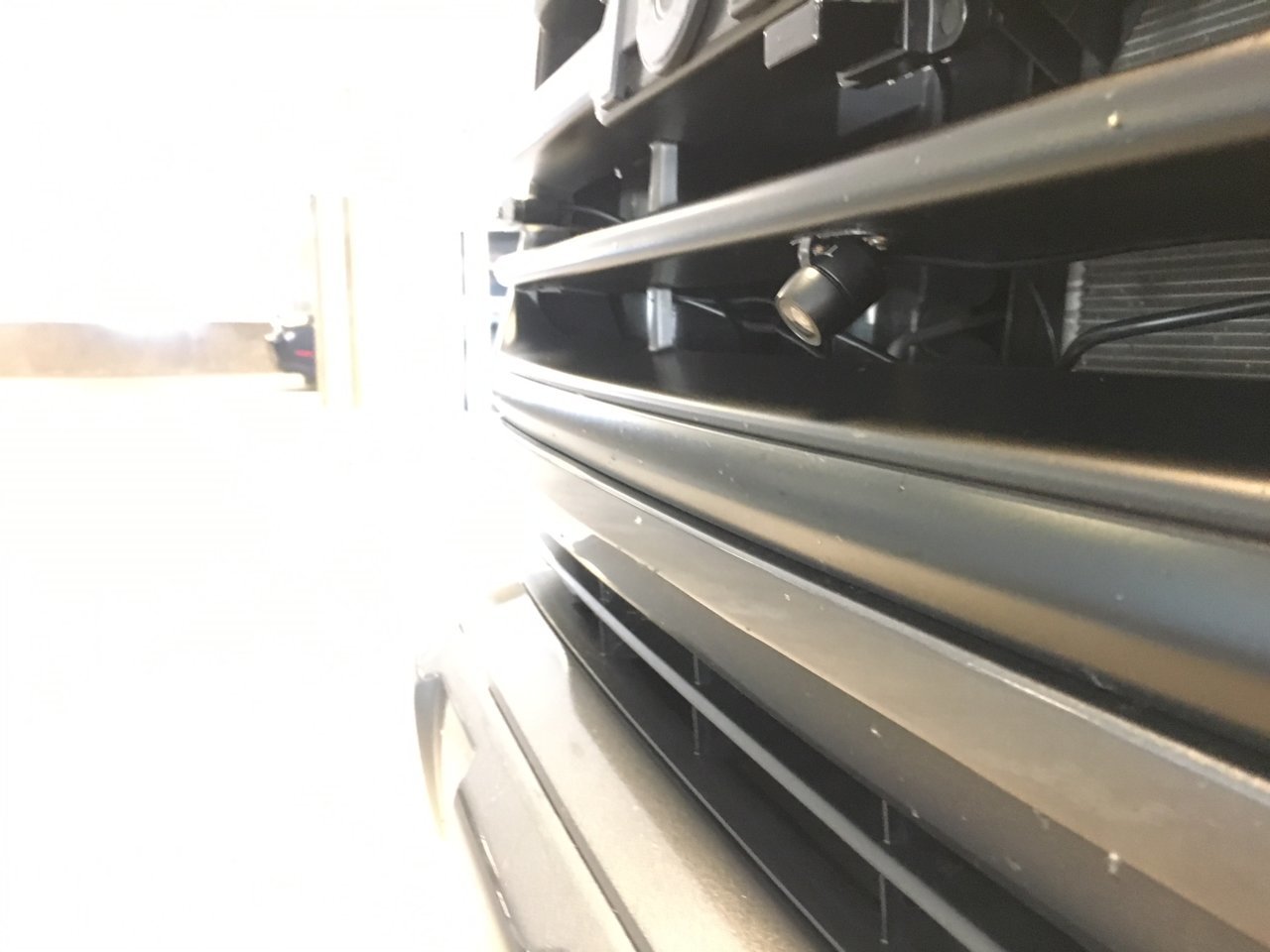

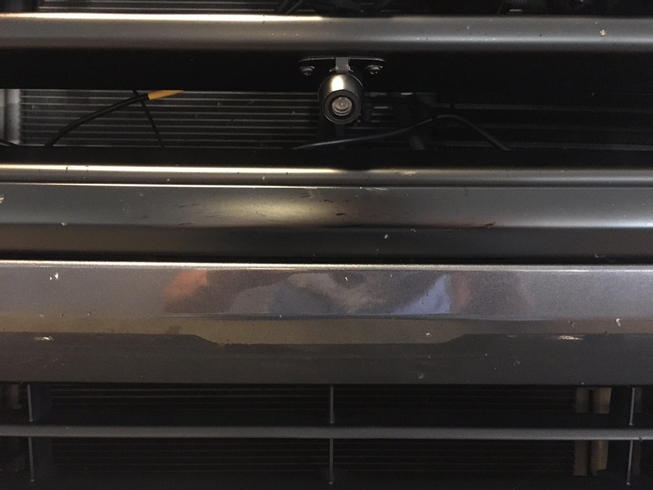

    Bought the full front/rear kit from JJ a while back and just got around to installing this weekend. Really is a great kit, shame everything went down the way it did.

    Really like the front camera view you have. Which camera did you use? Any pictures of your camera mounting?

    So this was the camera that JJ sent out with his kit. I don't believe he ever actually revealed the manufacturer, maybe someone else could chime in here if they know. I'm attaching some photos of how I mounted it, but keep in mind I have the Xtec Designs grille which gave me a lot more options over the OEM TRD grille.

    Thanks. Yeah this view makes the most sense for me. It was a pain in the ass getting the camera view straight without someone in the truck watching the screen though so I'd recommend having a helper.

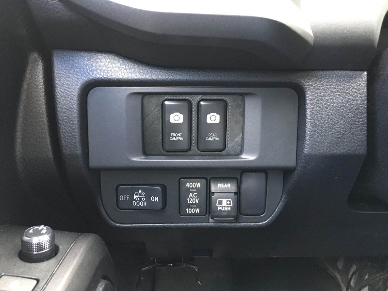

    Finally got a chance to install the rear camera kit. Amazing product and great customer service from JJ! His instructions he sent were super straight forward.
    Sad to hear that he is no longer selling them. His support and response time was amazing.
    Install took 5-10 minutes and was plug and play for the radio portion with very easy splicing for the switch portion.
    • Unplugged factory 28 pin male -> JJ harness 28 pin female
    • JJ Harness 28 pin male -> factory head unit 28 pin female
    • JJ Harness black <-> switch green (with butt connector)
    • JJ Harness red <-> switch red 1 (with butt connector)
    • Switch red 2 -> factory cargo green (with t-tap)
    • Switch black -> factory cargo tan (with t-tap)
