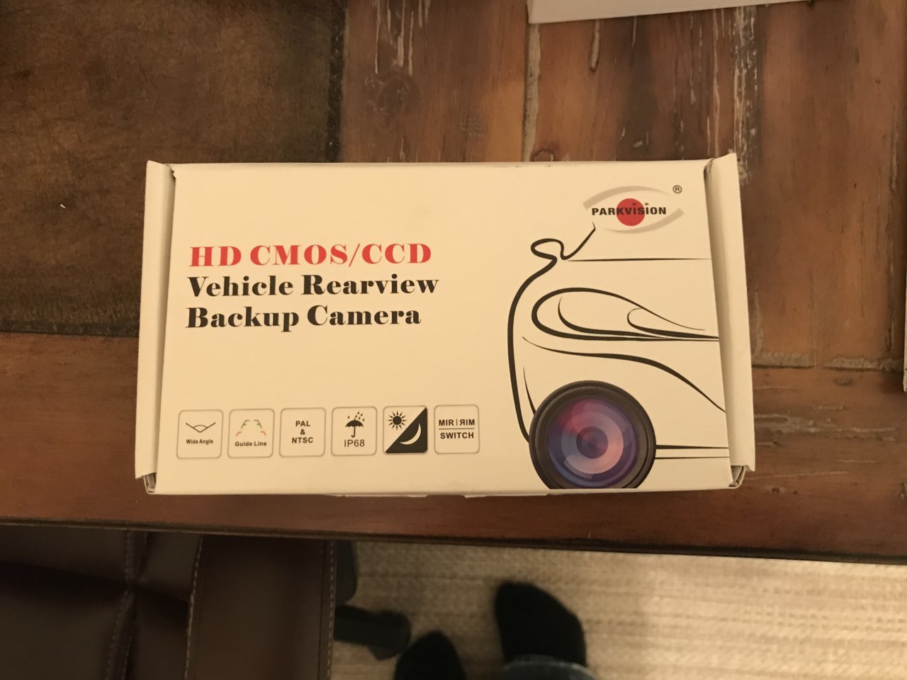

    Not very hard at all......you should order from https://www.anytimebackupcamera.com/ that is who I ordered from and it’s pretty much plug and play, I’ve got a cheap camera for sale on BST it’s a very good one70AA6D03-89E2-43F4-BC7F-FF09821A0944.jpg
