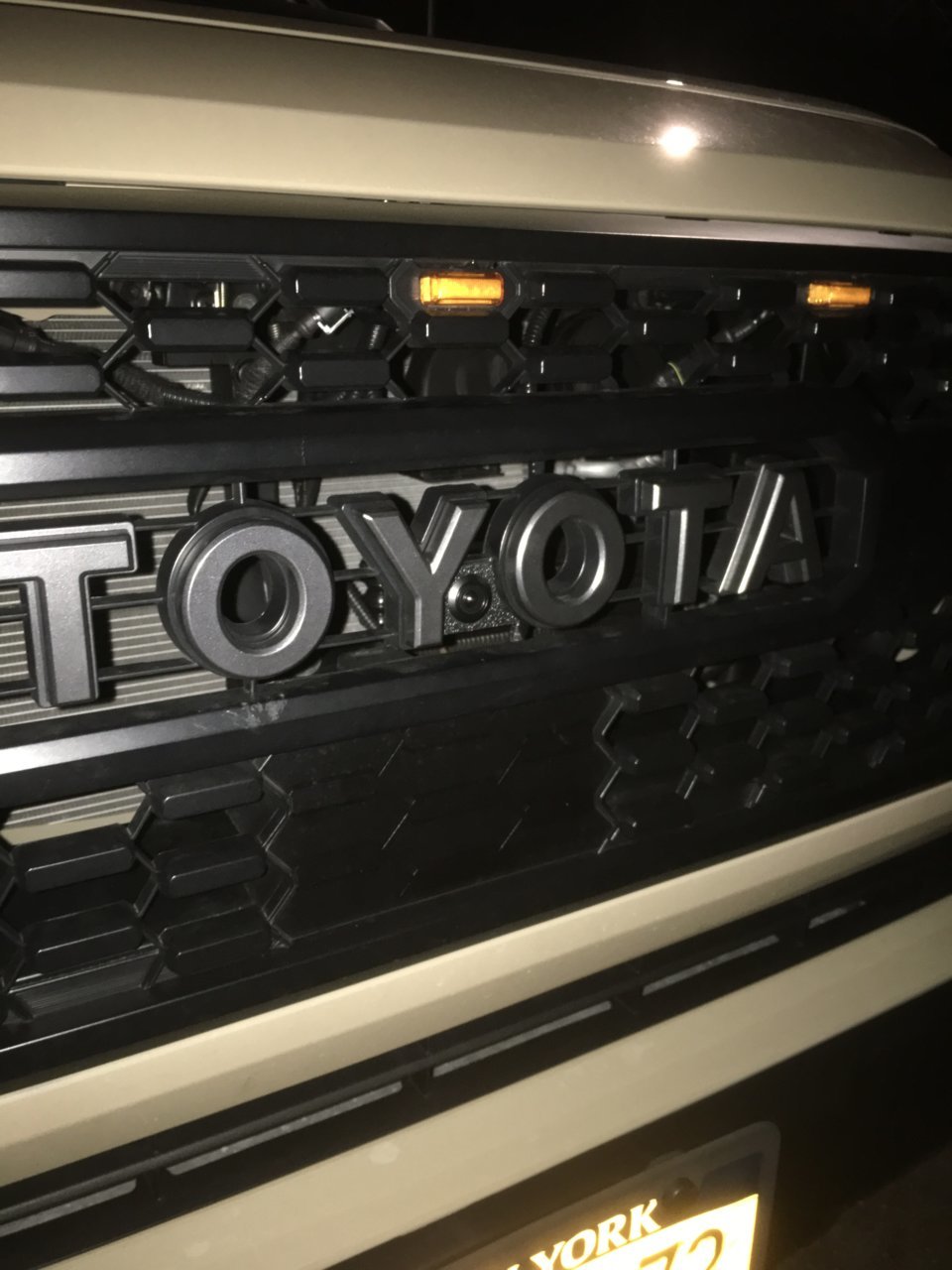

    Got the Natika camera mounted today. Took some pictures along the way. The car-solutions module comes Thursday so I'll finish taking pictures and post a little how to guide for those interested in doing this mod. Really happy with the look of the camera. The grill got in the way of being able to center the camera but I was ok with offsetting it.

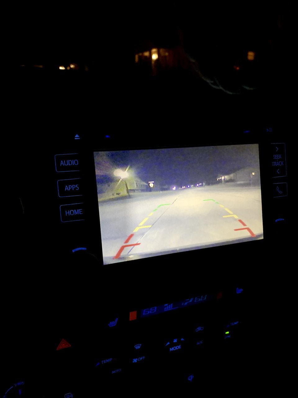

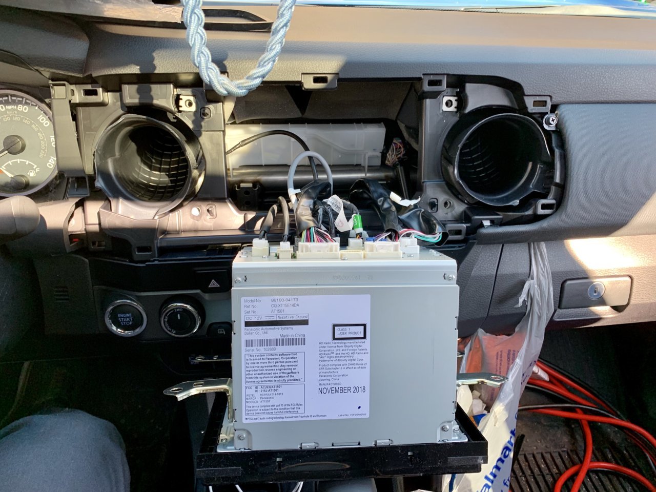

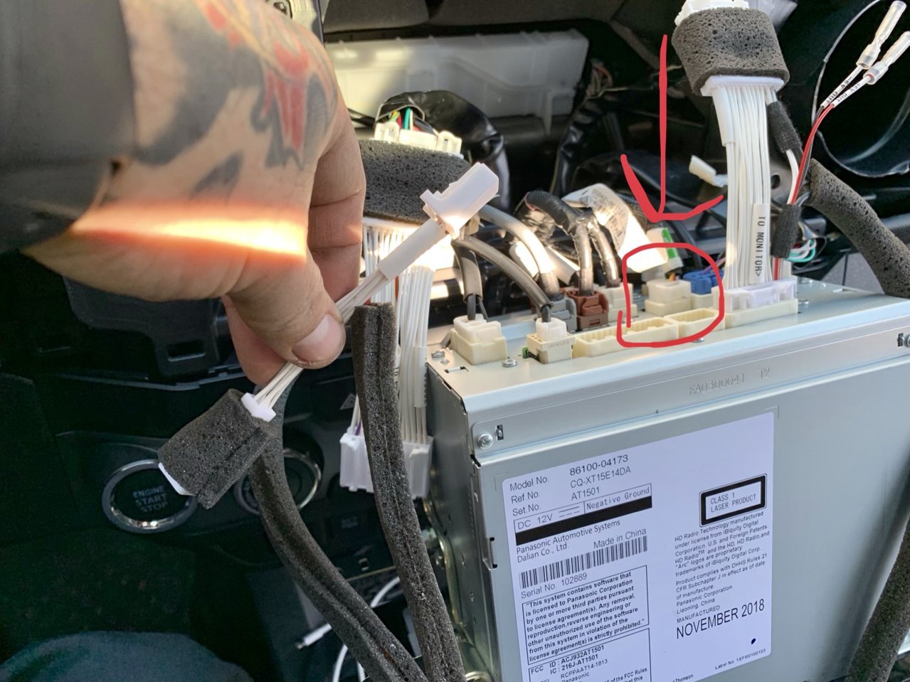

    uploadadventure
    uploadadventure It’s all @ColoradoTJ’s fault
    Jan 30, 2019
    #281288
    9,872
    Dixon, Mo
    2019 Cavalry Blue Tacoma TRD OR (sold) 05 Duramax
    1ABC60A1-3C2C-4F84-BE9A-A5C04D17B49A.jpg 2CE3371E-FC42-4C97-A46E-97AE870FDC61.jpg 8D564ADD-3AA6-4364-BB1F-BCB23FB65F3C.jpg I installed mine the past few days. I love it. Great mod. I’ll have to get a picture of the front camera placement. But it was pretty easy once I figured it out. I initially had trouble with the small connector because it wasn’t a smooth fit. I posted a picture of it.

    Installed the car solutions kit and the Natika camera. Super easy. Simple. Awesome. Love that there aren’t any additional switches.

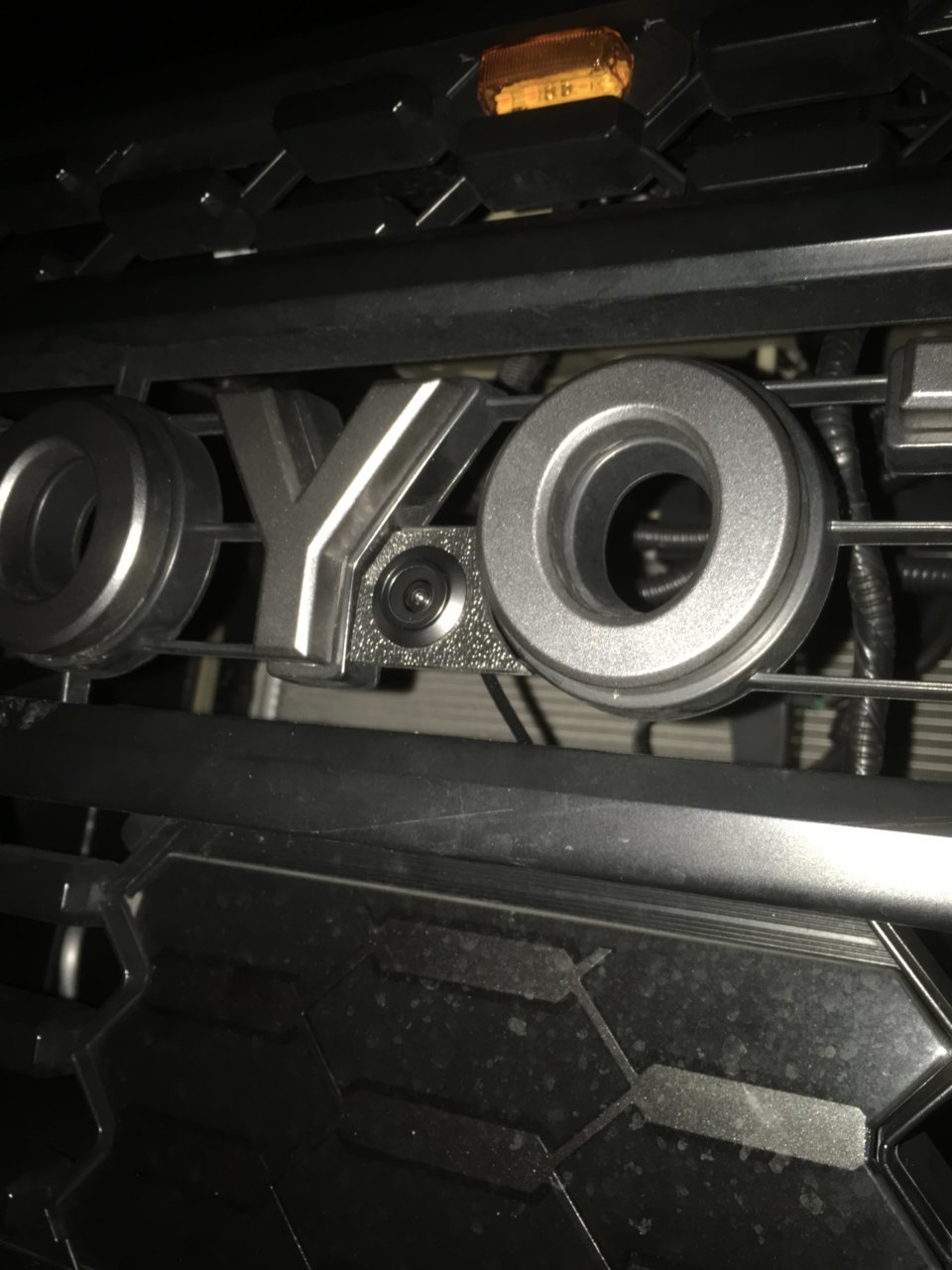

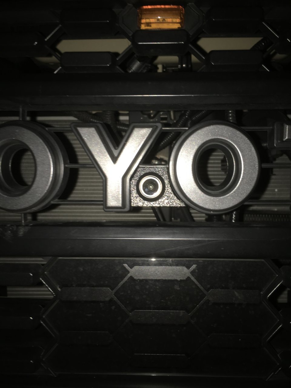

    Would highly recommend the Natika camera. The wiring has enough length and is simple. Your audio, + and - are all together and the single connector out of the camera makes it clean. It mounts out of the way on the pro grill and just shows the front of the plate. Good picture quality.
    Copied someone’s placement.

    Where are you guys putting the camera on the pro grille with the sensor garnish?

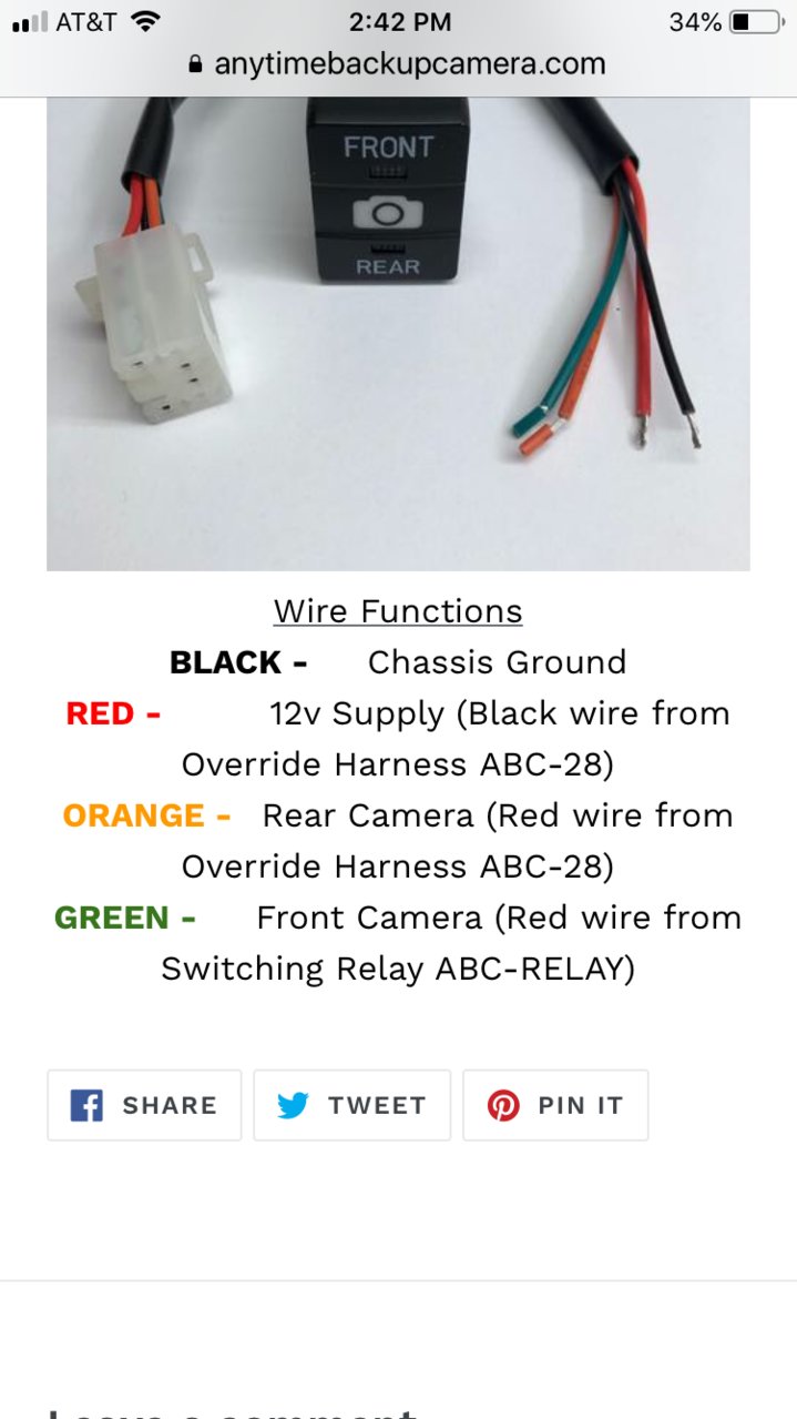

    Hoping someone can help me with the wiring for this switch.
    https://www.anytimebackupcamera.com/products/front-and-rear-camera-switch-toyota
    I bought the kit before the switch came out and had it working just fine with two single pole switches. I would press the rear switch for rear and both switches for the front.
    Yesterday I swapped those out for the single switch option but it’s not working. It’s showing the rear camera in both the front and rear rocker positions. I followed the wiring diagram carefully and I can’t figure out what I did wrong.
    I’d be grateful for any advice!

    I had something sort of similar happen but not really. This is JJ’s kit but with the anytimebackupcamera kit switch.
    https://youtu.be/6-IfbLUpuNQ

    How did you wire it up? I think that my front camera relay may not be getting power from the switch. Did you just connect the red and black wires from the harness to the switch for power with the green wire connecting to the front relay? Or is there a different source for 12V?

    @mrmiguelm i wired the switch to the trdmod harness from jj like the anytimebackupcamera website E16D4E71-E866-41C3-940C-0A73A6228A9A.jpgEither i had it wired wrong or the harness and relay are wired differently in guessing

    Huh, I did the same wiring. It looks like yours are reversed. Weird.
