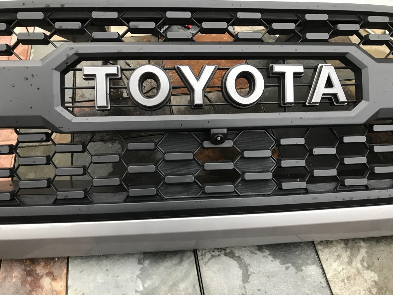

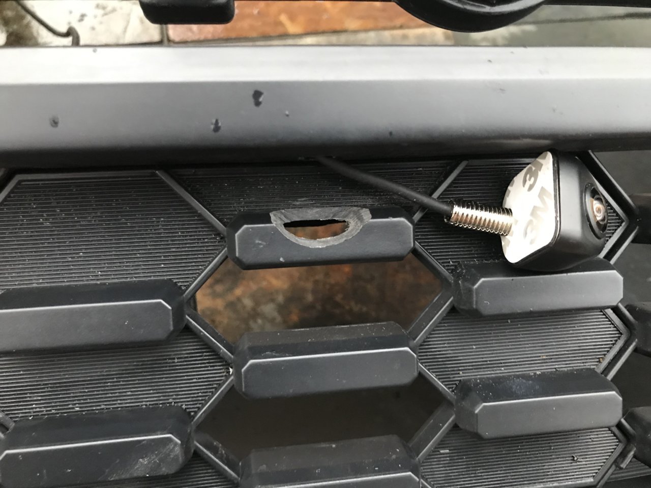

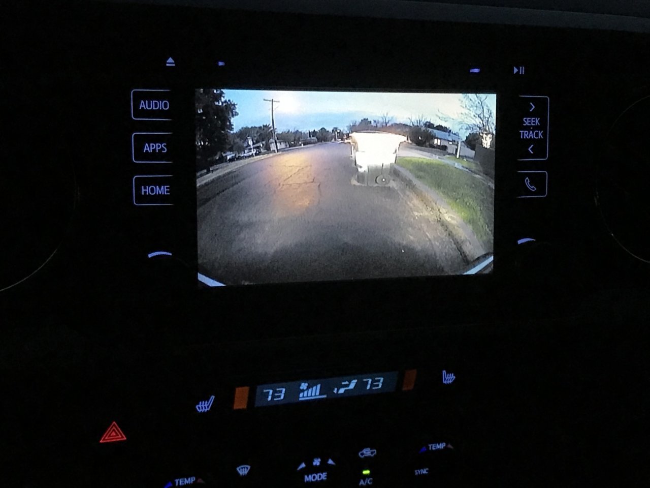

    Finished my front cam install. Went with the car solutions module and the Nikita Camera.
    One of my favorite parts is it automatically switches to the front cam for 20 seconds when going from reverse to drive.
    I dremeled out my grill a little bit so I could mount it in the center. I was not a fan of the offset mount.
